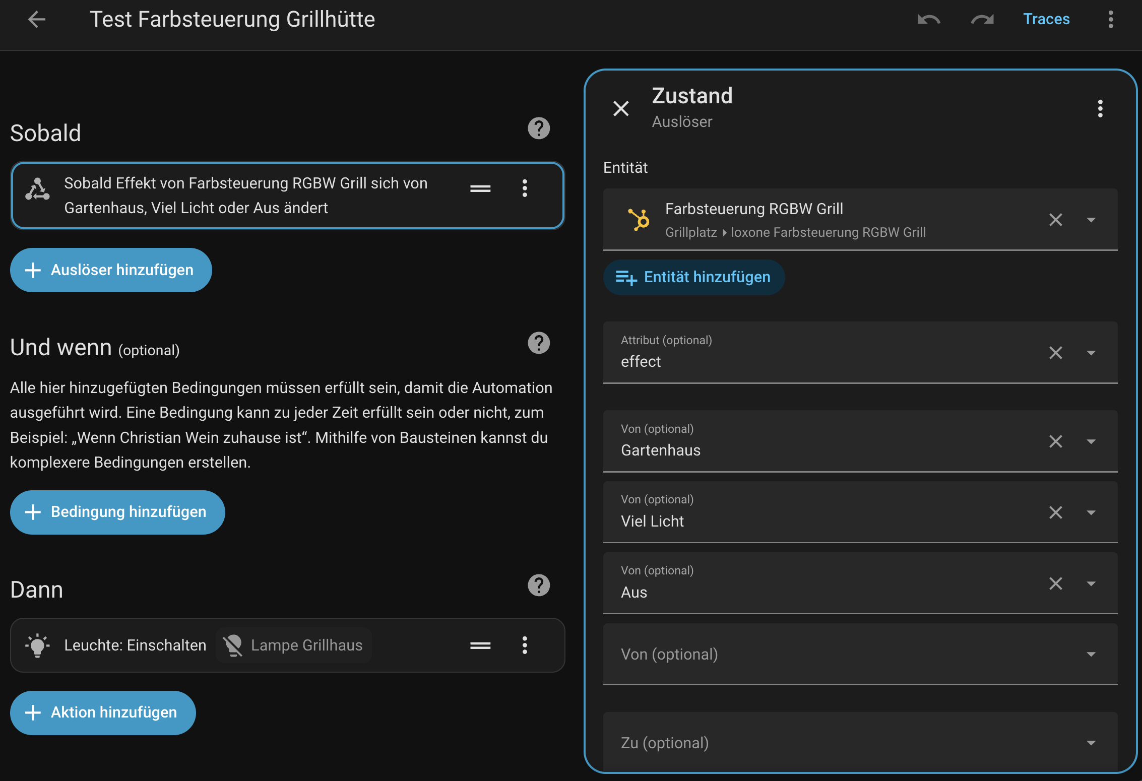

My goal is to control Zigbee RGBW lamps via PYLoxone and the Loxone Light Controller block.
The visualization is done in Loxone, while the logic/intelligence runs in Home Assistant.
I have integrated the lamps into Home Assistant using Zigbee2MQTT, and they work very well within Home Assistant itself.
In Loxone, I created the Light Controller block (although I’m not entirely sure if it is configured correctly).
For testing, I created a simple automation in Home Assistant using the editor (initially only switching on and setting colors).
I am able to switch the light on, but I cannot dim it or control the colors from Loxone.

I will attach some screenshots from Loxone and Home Assistant. Sorry but as new user I am allowed only to add on screenshot.

** I’ve solved the issue!
Key points:
  • The Light Controller V2 must be connected to a Virtual Output
    (important: set the output to (v) nothing).
  • No address is required in the basic configuration. This does not matter because PYLoxone automatically picks up the data.
  • The light output must be set to RGB. Even though I am using RGBW lamps (IKEA), PYLoxone correctly handles them as lights.
  • Scenes:
    • Color scene: in my case, magenta with a defined dim level
    • Maximum light output (“Full brightness”): any color temperature with a defined dim level
  • All settings can be changed via the Loxone visualization.
Finally, create an automation in Home Assistant with a trigger from the Loxone Light Controller, controlling the IKEA lamp integrated via Zigbee2MQTT.**
