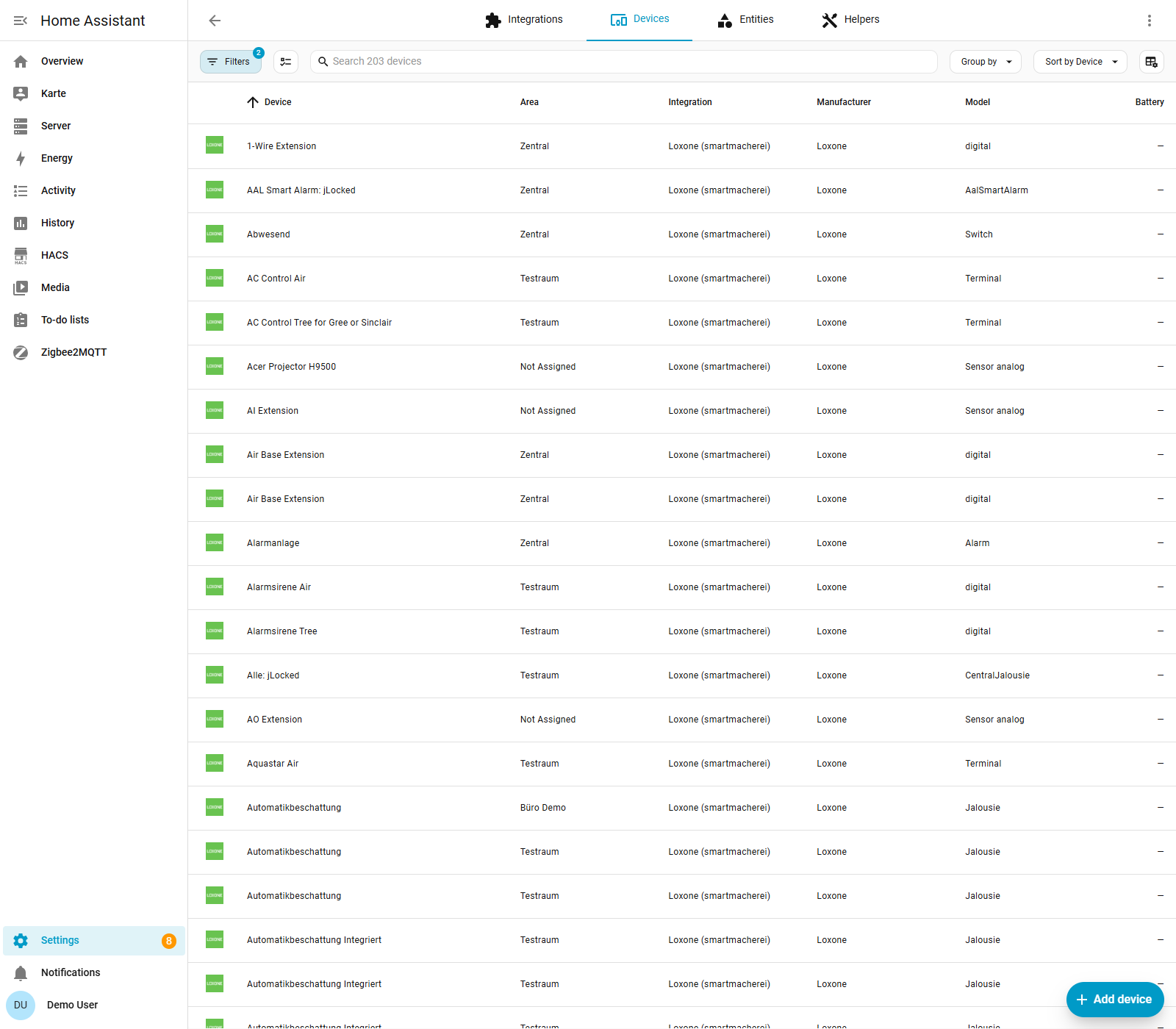

**Devices instead of a flat entity list.** Physical inputs and outputs are discovered from the Miniserver program itself (the `.Loxone` project), not only from the visualization. A Tree touch switch, a wallbox, an Air door contact each become one device with their entities under it. Battery and online state are created as diagnostic entities. Nothing has to be added to the Loxone visualization first.

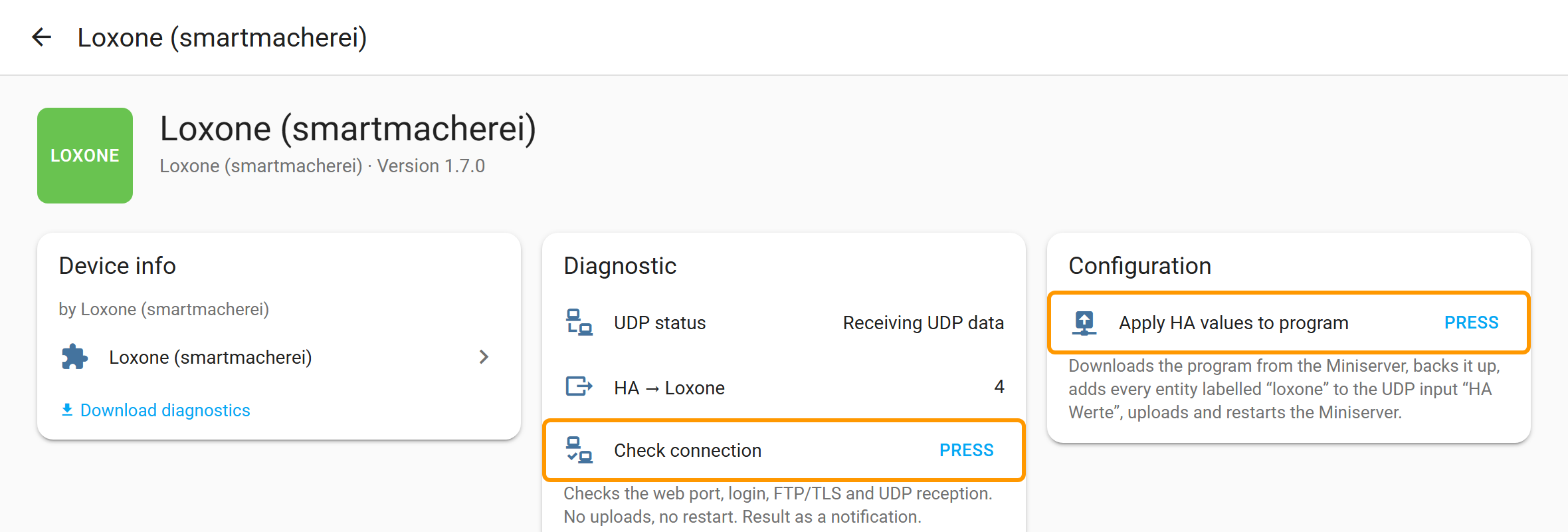

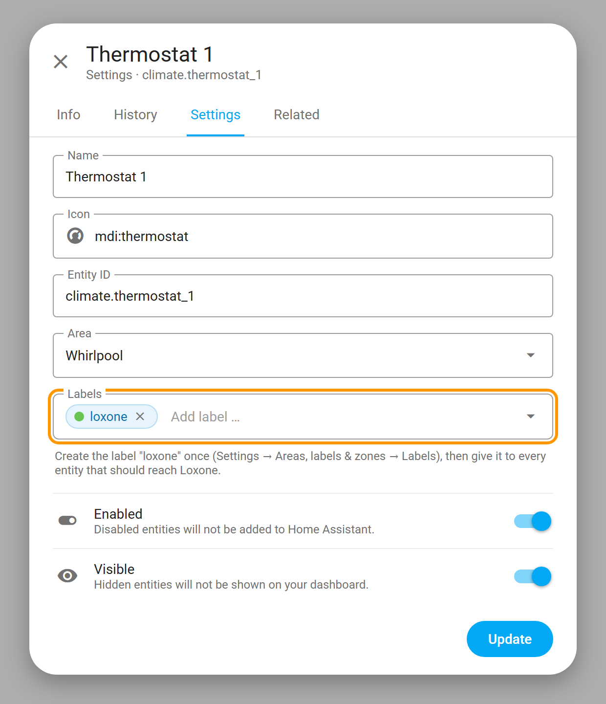

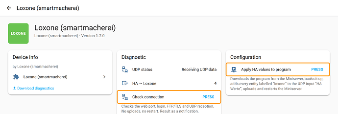

**HA → Loxone with a label (way 3, new in 1.7).** Give any entity the label `loxone`, press the button “Apply HA values to program”, and the integration creates a virtual UDP input “HA Werte” in the Miniserver with one command per value. From then on every state change is sent as a UDP datagram, plus all values every 5 minutes. A `climate` entity gives four inputs (mode index, current temperature, target temperature, action), sensors and switches one each, select entities the option index. Nothing changes in the program unless you press the button; a diagnostic sensor shows what is pending.

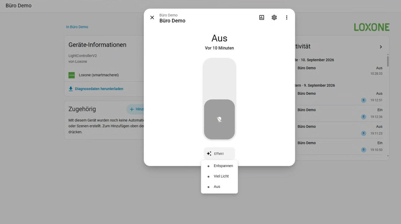

**Lighting moods as effects.** A Loxone lighting controller is a light entity, its moods are the effect list.
**Diagnostics that help.** A “Check connection” button tests web port, login, FTP/TLS and UDP reception without uploading anything. The diagnostics download includes the program archive (treat it as confidential, it contains your project). Contacts follow the Loxone status texts, so a door contact labelled “1 = closed” in Config shows closed in HA.
