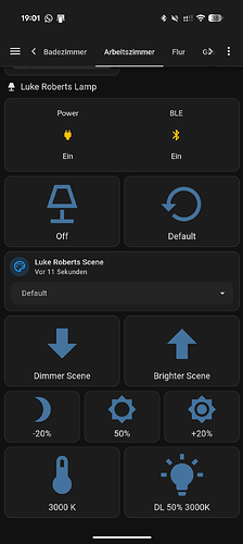

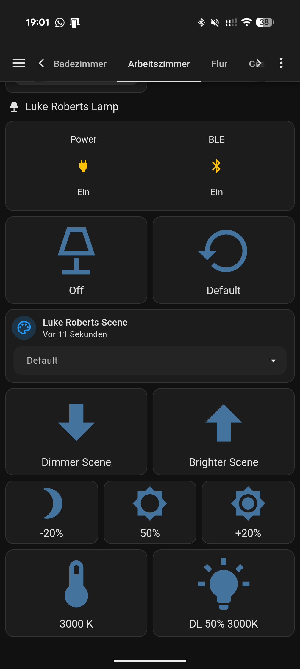

Dashboard
The repo includes two ready-to-paste Lovelace snippets under dashboard/:
  • lamp-card.yaml – everyday control panel. Switches automatically between three states via conditional cards: mains off → only a status glance row; mains on but BLE not yet reachable → waiting notice; fully reachable → scene picker, brightness & color-temperature controls.
  • diagnostics-card.yaml – admin card with Ping / Restart / Refresh Scenes / last API response / device info, gated by visibility so it only shows for a specific HA user.
The main card uses only core HA cards plus optionally custom:mushroom-select-card (HACS) for the scene dropdown.
