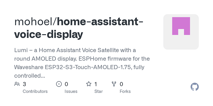

Lumi: A voice satellite with a round AMOLED display, fully controlled from Home Assistant
After my first attempts with Assist I wanted a voice assistant with a display, so I started a small project with Claude Code to get there.
The result is a custom firmware for the Waveshare ESP32-S3-Touch-AMOLED-1.75, turning it into a voice satellite with a screen.
Everything that happens on the screen is driven by HA entities. No app, no cloud dashboard, no extra layer of configuration.

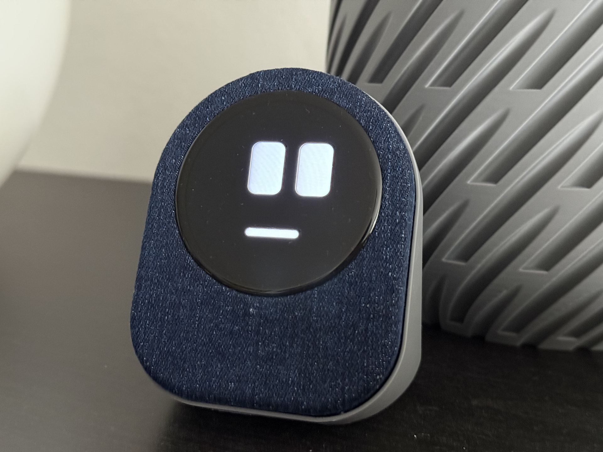

  • Breathing microphone while listening, wave of dots while processing, equalizer while responding, as visual feedback
  • Three standby pages: clock with date, hand-less watch face, and the highlight, an animated face with wandering eyes
  • A timer shown as a ring around the screen edge that visibly counts down
  • Single and double tap as their own events, recording can be cancelled by tapping
