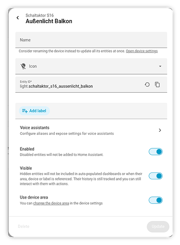

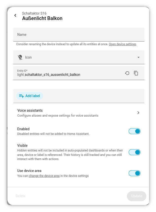

I found the solution. In case someone else also can not find it.
You need to go to the control:
and than disable the option at the bottom “use device area”, than you can assign the individual control a room
