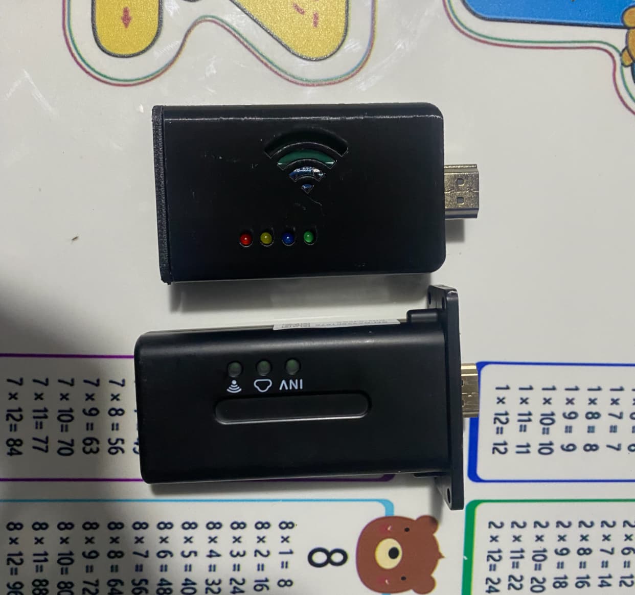

I contacted Luxpower technical support by phone, but they didn’t seem capable of solving the problem. I emailed them directly to China, explaining the situation in detail, and they also immediately dismissed me with the statement, “Your dongle doesn’t support the 10.10.10.1 portal.” So what? I spent money on an inverter that claimed to be an essential feature for me, and now, with a dongle, I find myself unable to read the values ​​needed to manage my smart home. I tried unplugging and plugging the dongle several times, restarting the inverter, reconnecting to wifi but nothing worked.
you can follow the instruction in the github TThanhXuan/luxpower-DIY-dongle to create DIY dongle access direct the RS485 bus
