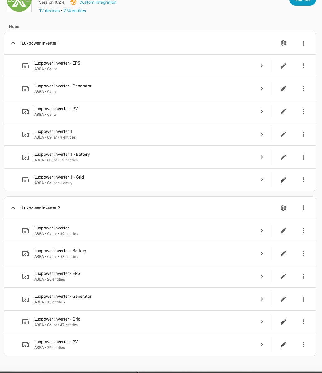

I finally got around to installing this but I haven’t quite got it sorted I don’t think. I have a pair of Squirrelpods (LXP36000) in parallel. Now, I had to get them running using the small block option and I also did them read-only for now but they connect and create. The issue I am having is it only seems to have created sensors on one of the units. Therefore I am only seeing, for example, half the solar generation. You can see that the number of entities is way bigger on one inverter and in some cases a lot of the devices have none - look at the two PV devices:
Any thoughts on what I can do to get the full reading?
