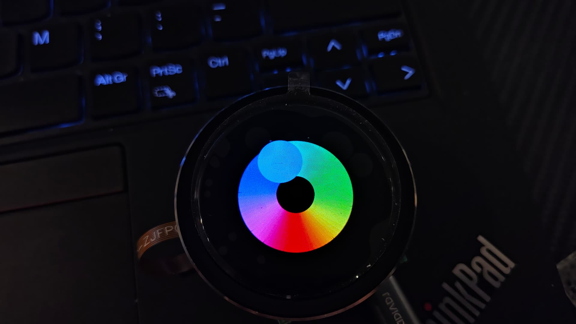

LVGL color picker
After much googling and finally a few hours of Google AI this finally works.
It’s not complete in such a way that it can control something yet, but the values are there.
Hopefully we can use them somehow.
round display with 466x466 px
