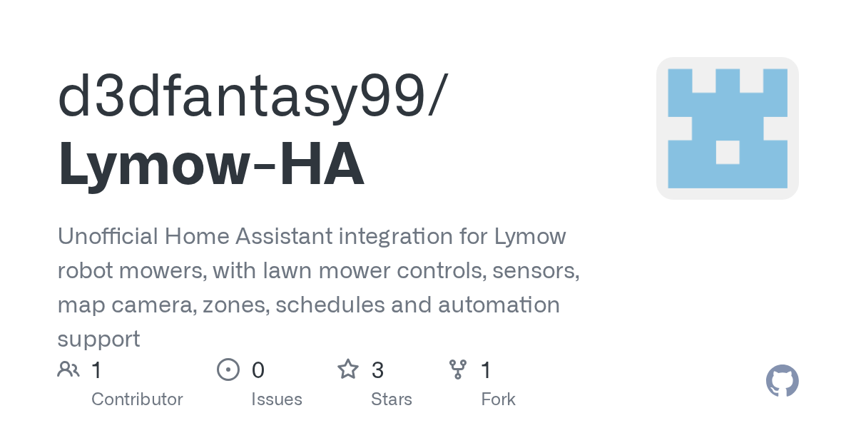

If someone has a “secondary” account with a shared robot, I could try to integrate it. I don’t own a Lymow.
Thanks to @d3dfantasy99!
@d3dfantasy99 That is awesome! thanks
@d3dfantasy99 is it possible to specify which zone(s) to mow?
Any chance this would be supported locally in the future? I understand it's using AWS cloud currently.
Thanks for the amazing work! Will buy you a coffee once I get it setup :).
