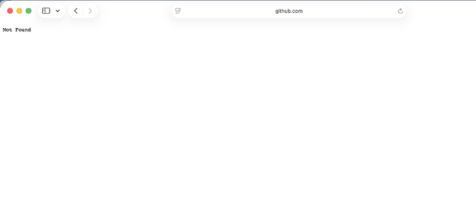

Processing teslaekey (board: esp32-c6-devkitc-1; framework: espidf; platform: [email protected])
Tool Manager: Installing https://github.com/pioarduino/esp-idf/releases/download/v5.2.1/esp-idf-v5.2.1.zip
INFO Installing https://github.com/pioarduino/esp-idf/releases/download/v5.2.1/esp-idf-v5.2.1.zip
WARNING Package download failed: Got the unrecognized status code '404' when downloaded https://github.com/pioarduino/esp-idf/releases/download/v5.2.1/esp-idf-v5.2.1.zip. Retrying... (attempt 1/3)
WARNING Package download failed: Got the unrecognized status code '404' when downloaded https://github.com/pioarduino/esp-idf/releases/download/v5.2.1/esp-idf-v5.2.1.zip. Retrying... (attempt 2/3)
PackageException: Got the unrecognized status code '404' when downloaded https://github.com/pioarduino/esp-idf/releases/download/v5.2.1/esp-idf-v5.2.1.zip

Actually, 404 means it can’t download package. Is esphome device builder able to access internet. Is that weblink correct? Thats the failure
Is that chip suppprted by that idf yet?
Any reason you are specifying specific versions? Latest is often the best.
Have there been any updates? The versions you are pointing to may have been superseded and archived, hence the URL is not valid any more (the 404 not found error).
Have you cleared your ESPHome build cache before recompiling?

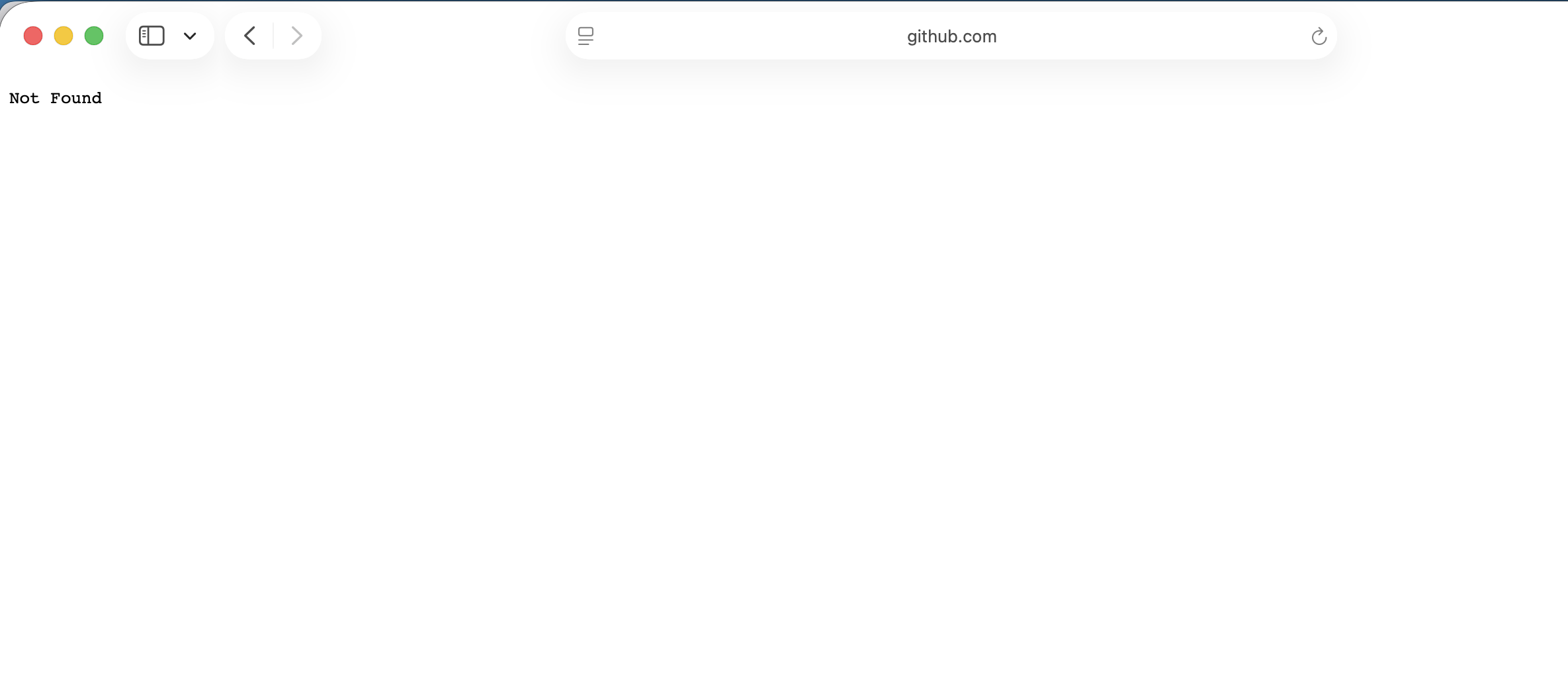

ESPhome have access, yes. I am running other devices. But I tried to access it via the webbrowser, it is not working. Do I have the wrong link? See screenshot
Yep, 404 not found means it wasnt found. Keep looking.
The search button on Github may prove fruitful, or just go up a few levels to see where the latest code can be foind.
The github mentions tests done with it, so I supposed it is a yes. No reason for the version, but I can remove it.
I realized the 404 but I am not sure I see other docs there or how I could manage it.

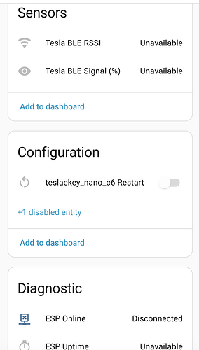

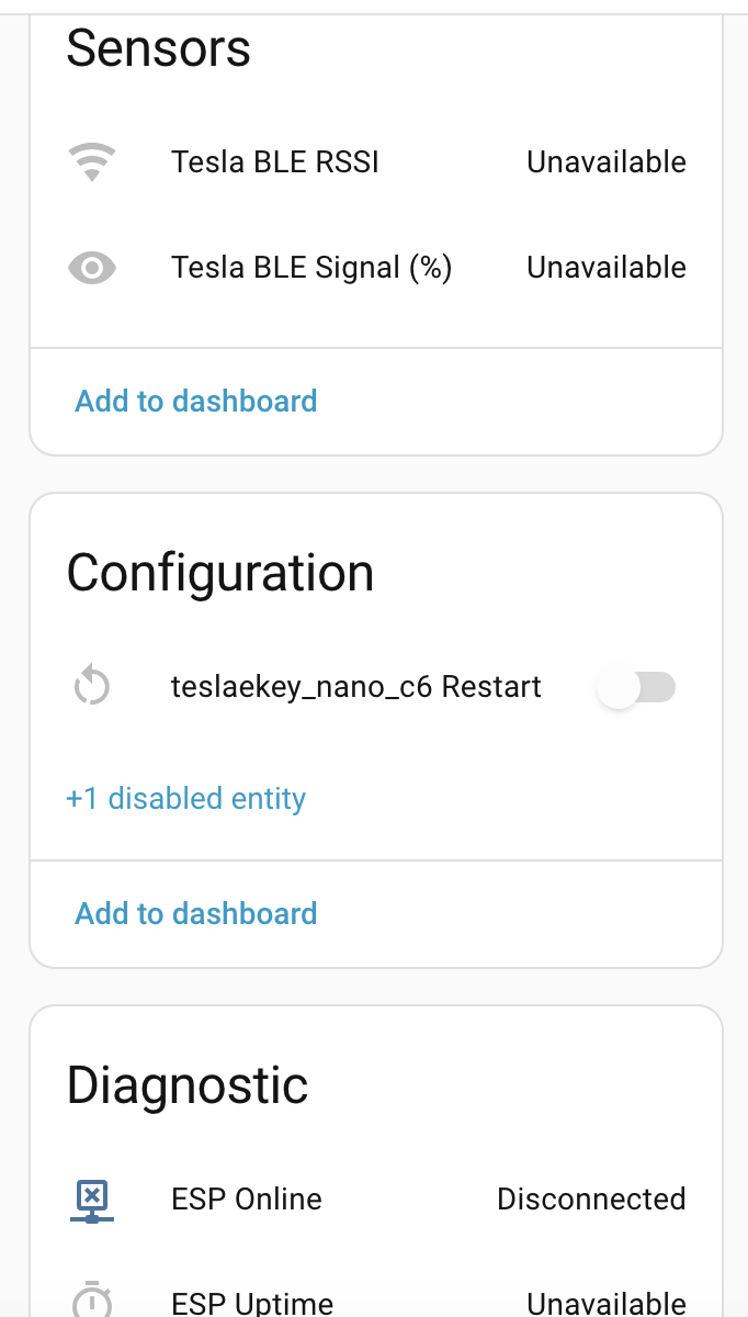

change the code to this, but now the other issue is I cannot get the sensors displayed… See code and screenshot results

It says “esp disconnected”
Lets look at what is happening behind the scenes:
Update HomeAssistant to the latest.
Update your ESPHome to the latest.
Clear the ESPHome cache.
Change the line around line 30 that says INFO under logger, level to say DEBUG instead.
Recompile your code and update your ESP32.
Watch the compile error log complete, attempt connection, and some of the return codes bounce back.
Post your ESPHome log.
We can change it back later once we have found the cause.

Could you please explain what you did or highlight what you changed in the yaml? It will be helpful for others looking at This thread in the future
I tried to make it bold, but I am not sure it worked. Anyhow, here are the changes done:
***# Set up the M5NanoC6 board (ESP32-C6)***
***# This requires the esp-idf framework***
***esp32:***
***  # NOTE: Replaced m5stack-nanoc6 with a recognised C6 board name***
***  board: esp32-c6-devkitc-1***
***  variant: esp32c6***
***  framework:***
***    type: esp-idf***
**packages:**
**  tesla_ble_configs: **
**    url: https://github.com/PedroKTFC/esphome-tesla-ble**
**    ref: newteslalib**
**    files:**
**      - packages/base.yml**
**      - packages/common.yml**
**      - packages/project.yml**
