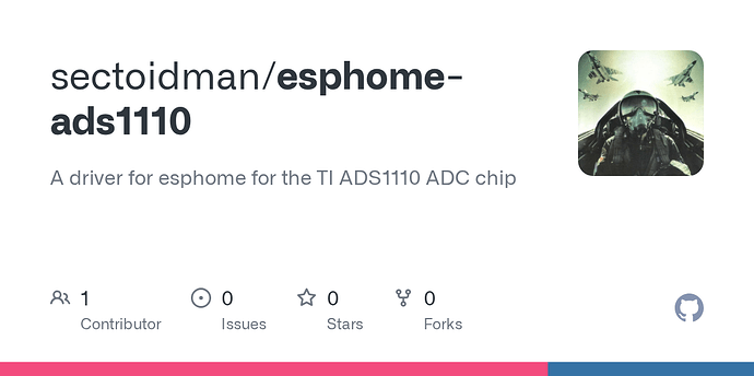

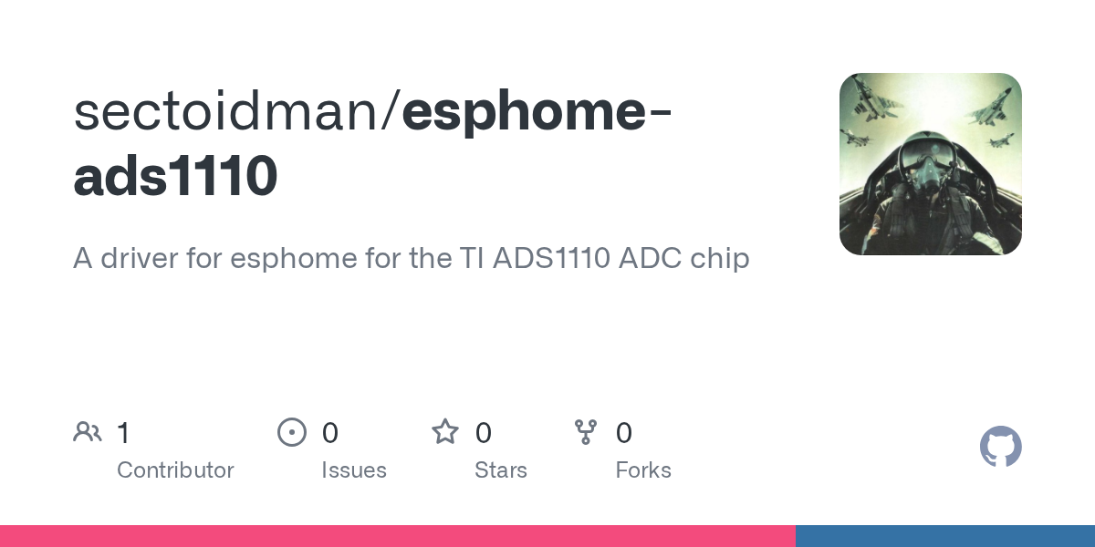

I have started working on an external component driver for the ADS1110 for this application; it is very much a work in progress but the code is here:
example configuration (for the M5Stack NanoC6 + ADC V1.1 module, which is what I have)
i2c:
- id: bus_porta
scl: GPIO1
sda: GPIO2
ads1110:
address: 0x48
i2c_id: bus_porta
sensor:
- platform: ads1110
external_components:
- source:
type: git
url: https://github.com/sectoidman/esphome-ads1110
ref: master
components: [ ads1110 ]
