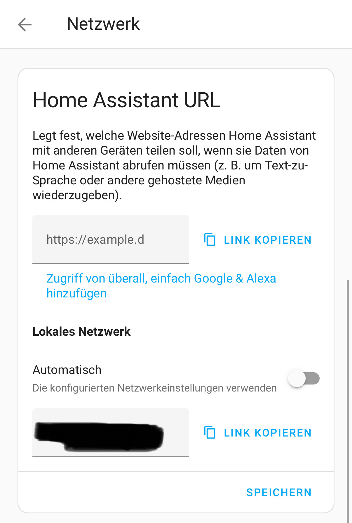

How did you install HA?
What is your STT provider?
Check the Homeassitant URLs in HA Network settings. I belive the local address must be accessible to STT provider.
I don’t thing your STT provider is able to get data for playback. I believe that’s what the error infers.

For the Home Assistant URL: that might be a hot take. It is not set (never was, working that way for years), only the local network address, because it is not exposed externally. Is this URL needed?

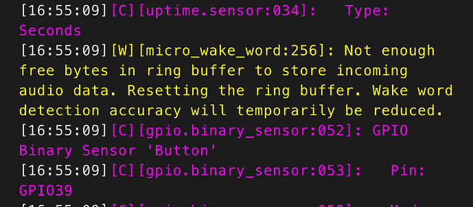

Checking the ESP logs I also discovered this warning now:
That look like the issue
Since you works occasionally the problem likely is esp. not sure how to reduce memory.
I get different error where Wake word detect doesn’t seem to restart after announcement. M5 overall is not good for assistant. I think it would be useful for connecting to another device for announcement. Its wake detection was always poor and volume too low. HA Voice PE was significant improvement.
The local/on device wake word detection requires the compiling of some memory intensive components, maybe removing this would free some memory.

  1. :white_check_mark: Issue one - not working micro word detection - solved (worked around) with M5Stack Atom Echo stops listening after one voice command · Issue #122 · esphome/wake-word-voice-assistants · GitHub / Atom Echo works for a while after restart, but then stops responding - #11 by omarahmed500
