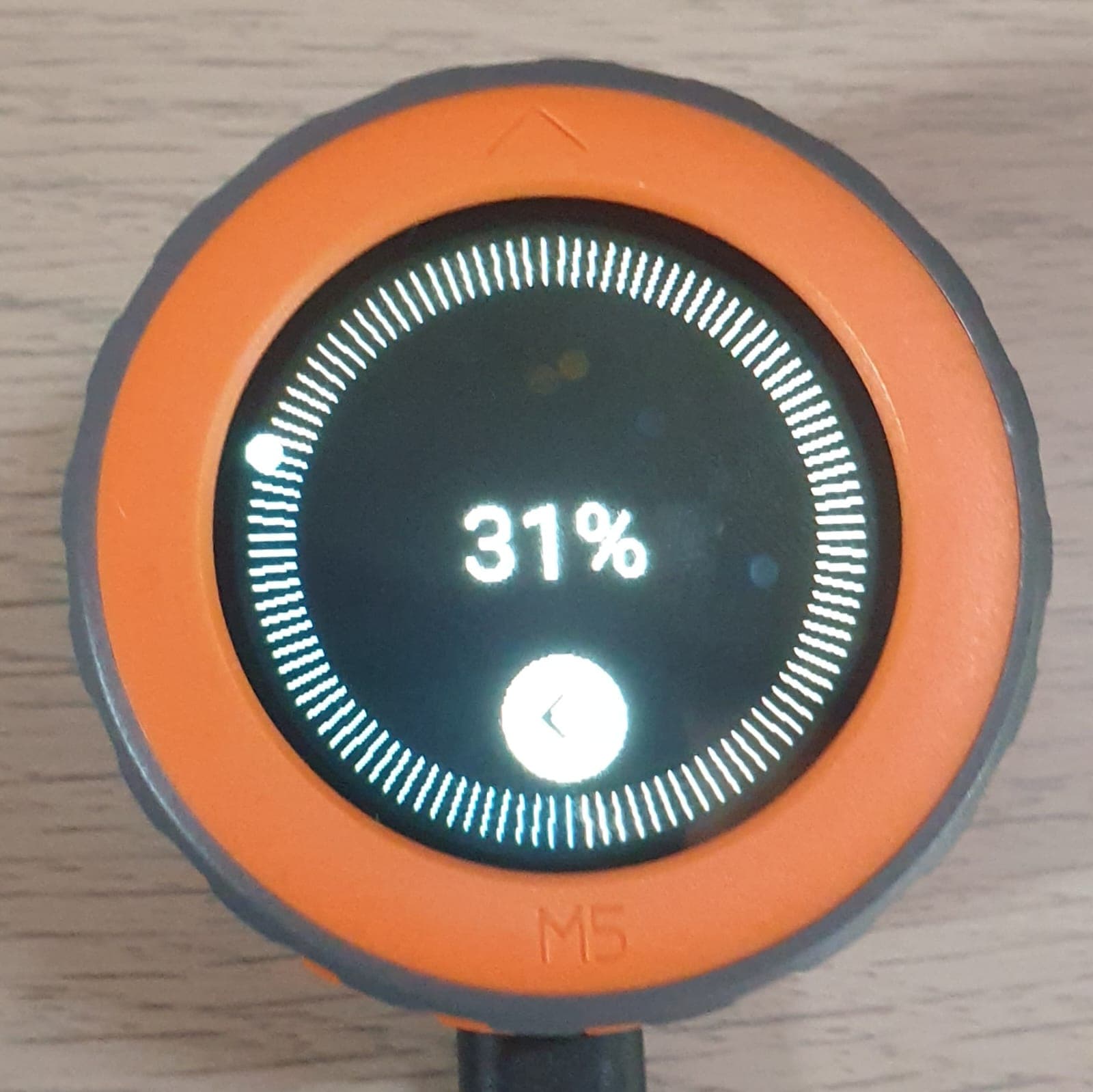

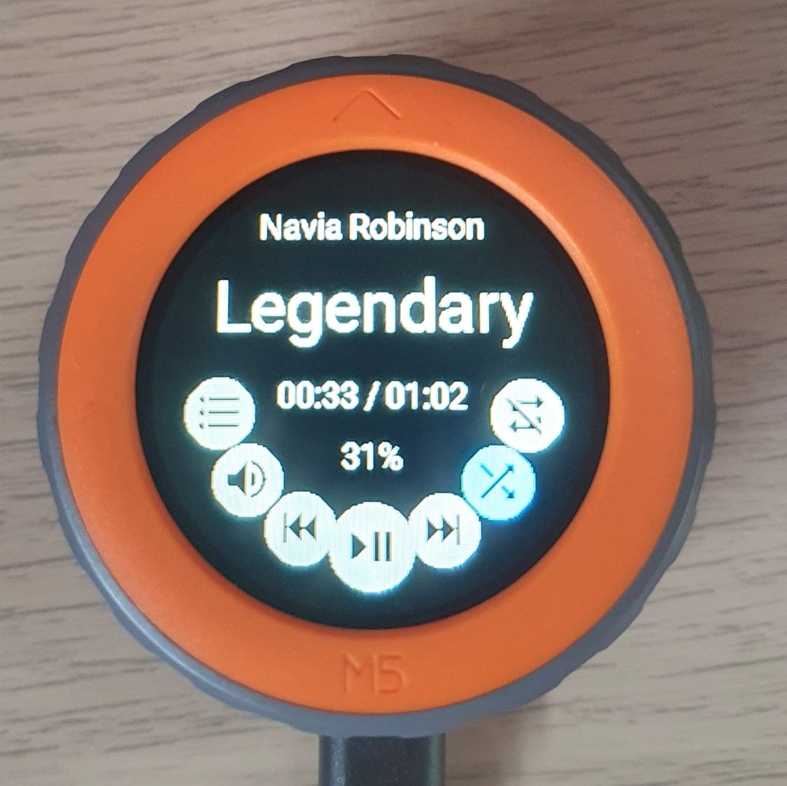

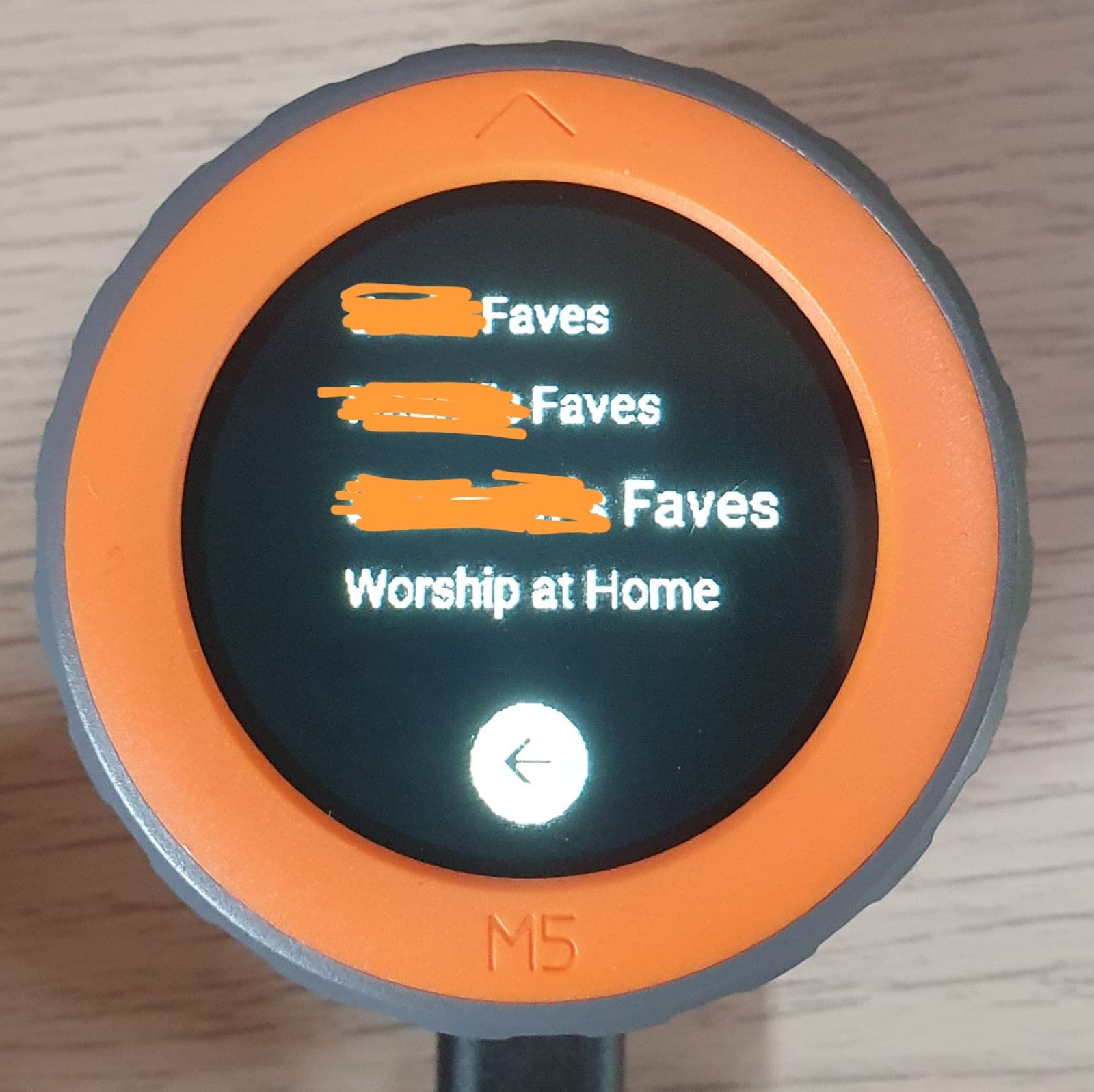

I / AI have referenced many different configs and have eventually ended up with this Music Assistant/Home Assistant media controller (although I think you can change it to use a non music assistant action and playlist easily enough). If anyone is interested I can put it on github properly.
You use the rotary to select a option/button, and the M5 button (the one on the front of the rotary) to click ‘enter’. The touch screen is not used.
Brightness and screen are exposed to home assistant for two-way sync, e.g in automations like dimming the screen at night. Accent colour can use a HA sensor that contains a hex code, or a hardcoded one.
My Code

          it.fill(BG);
          char title_buf[64];
          char artist_buf[64];
          auto build_scroll = [&](const std::string &src, int window_chars, char *out, size_t out_sz) {
            std::string s = src;
            if (s.empty())
              s = "-";
            if ((int) s.size() <= window_chars) {
              snprintf(out, out_sz, "%s", s.c_str());
              return;
            std::string gap = "   ";
            std::string padded = s + gap;
            int span = (int) padded.size();
            int off = id(marquee_tick) % span;
            std::string loop = padded + padded;
            std::string view = loop.substr(off, window_chars);
            snprintf(out, out_sz, "%s", view.c_str());
          // Large title font needs a tighter char window so long titles still marquee.
          build_scroll(id(media_title).state, 11, title_buf, sizeof(title_buf));
          std::string artist_raw = id(media_artist).state;
          if (artist_raw.empty())
            artist_raw = "No media";
          build_scroll(artist_raw, 16, artist_buf, sizeof(artist_buf));
          it.printf(cx, 24, id(font_medium), FG, TextAlign::TOP_CENTER, "%s", artist_buf);
          it.printf(cx, 56, id(font_xlarge), FG, TextAlign::TOP_CENTER, "%s", title_buf);
          char pos_buf[8];
          char dur_buf[8];
          float p = id(media_position).state;
          float d = id(media_duration).state;
          if (isnan(p) || p <= 0.0f) {
            p = id(media_position_est);
            if (id(media_state).state == "playing" && id(media_position_est_last_ms) > 0) {
              float dt = (millis() - id(media_position_est_last_ms)) / 1000.0f;
              if (dt > 0.0f && dt < 120.0f)
                p += dt;
          if (isnan(p) || p < 0) {
            snprintf(pos_buf, sizeof(pos_buf), "--:--");
          } else {
            int ps = (int) p;
            snprintf(pos_buf, sizeof(pos_buf), "%02d:%02d", (ps / 60) % 100, ps % 60);
          if (isnan(d) || d < 0) {
            snprintf(dur_buf, sizeof(dur_buf), "--:--");
          } else {
            int ds = (int) d;
            snprintf(dur_buf, sizeof(dur_buf), "%02d:%02d", (ds / 60) % 100, ds % 60);
          it.printf(cx, 126, id(font_medium), FG, TextAlign::CENTER, "%s / %s", pos_buf, dur_buf);
          float v = id(media_volume).state;
          if (isnan(v))
            v = 0.0f;
          if (v < 0.0f)
            v = 0.0f;
          if (v > 1.0f)
            v = 1.0f;
          int pct = (int) (v * 100.0f + 0.5f);
          it.printf(cx, 158, id(font_medium), FG, TextAlign::CENTER, "%d%%", pct);
          // Left->right visual order: playlist, volume, previous, play/pause, next, shuffle, repeat.
          const int arc_cx = 120;
          const int arc_cy = 121;
          const int arc_r = 84;
          const int count = 7;
          const float start_deg = 170.0f;
          const float end_deg = 10.0f;
          for (int i = 0; i < 7; i++) {
            float t = (count <= 1) ? 0.0f : (float) i / (count - 1);
            float a = (start_deg + t * (end_deg - start_deg)) * 3.14159265f / 180.0f;
            int bx = (int) roundf(arc_cx + cosf(a) * arc_r);
            int by = (int) roundf(arc_cy + sinf(a) * arc_r);
            bool sel = id(menu_index) == i;
            int r = sel ? 22 : 18;
            Color face = sel ? SEL : BTN;
            if (i == 5 && id(shuffle_is_on))
              face = ACC;
            if (i == 6 && id(repeat_mode) > 0)
              face = ACC;
            if (i == 3 && paused)
              face = ACC;
            it.filled_circle(bx, by, r, face);
            if (i == 0) {
              it.image(bx, by, id(ic_playlist), ImageAlign::CENTER, DARK);
            } else if (i == 1) {
              it.image(bx, by, id(ic_volume), ImageAlign::CENTER, DARK);
            } else if (i == 2) {
              it.image(bx, by, id(ic_prev), ImageAlign::CENTER, DARK);
            } else if (i == 3) {
              it.image(bx, by, id(ic_play_pause), ImageAlign::CENTER, DARK);
            } else if (i == 4) {
              it.image(bx, by, id(ic_next), ImageAlign::CENTER, DARK);
            } else if (i == 5) {
              it.image(bx, by, id(shuffle_is_on) ? id(ic_shuffle_on) : id(ic_shuffle_off), ImageAlign::CENTER, DARK);
            } else if (i == 6) {
              if (id(repeat_mode) == 2) {
                it.image(bx, by, id(ic_repeat_once), ImageAlign::CENTER, DARK);
              } else if (id(repeat_mode) == 1) {
                it.image(bx, by, id(ic_repeat), ImageAlign::CENTER, DARK);
              } else {
                it.image(bx, by, id(ic_repeat_off), ImageAlign::CENTER, DARK);
      - id: VolumePage
        lambda: |-
          auto BG = Color(0x00, 0x00, 0x00);
          auto FG = Color(0xFF, 0xFF, 0xFF);
          auto TRACK = Color(0xFF, 0xFF, 0xFF);
          auto ACTIVE = Color(0x7D, 0xD3, 0xFC);
          int acc_r = 0, acc_g = 0, acc_b = 0;
          const char *acc_src = id(accent_color_text).state.c_str();
          if (sscanf(acc_src, "#%02x%02x%02x", &acc_r, &acc_g, &acc_b) == 3 ||
              sscanf(acc_src, "%02x%02x%02x", &acc_r, &acc_g, &acc_b) == 3 ||
              sscanf("${accent_color}", "#%02x%02x%02x", &acc_r, &acc_g, &acc_b) == 3 ||
              sscanf("${accent_color}", "%02x%02x%02x", &acc_r, &acc_g, &acc_b) == 3) {
            ACTIVE = Color(acc_r, acc_g, acc_b);
          it.fill(BG);
          if (isnan(v))
            v = 0.0f;
          if (v < 0.0f)
            v = 0.0f;
          if (v > 1.0f)
            v = 1.0f;
          const int steps = 110;
          int lit = (int) roundf(v * steps);
          // Circular slider: dark full track + bright active portion from bottom clockwise.
          for (int i = 0; i < steps; i++) {
            float a = (90.0f + (i * 360.0f / steps)) * 3.14159265f / 180.0f;
            int x1 = (int) roundf(120.0f + cosf(a) * 98.0f);
            int y1 = (int) roundf(120.0f + sinf(a) * 98.0f);
            int x2 = (int) roundf(120.0f + cosf(a) * 114.0f);
            int y2 = (int) roundf(120.0f + sinf(a) * 114.0f);
            Color c = (i < lit) ? ACTIVE : TRACK;
            it.line(x1, y1, x2, y2, c);
          if (lit > 0) {
            float ka = (90.0f + ((lit - 1) * 360.0f / steps)) * 3.14159265f / 180.0f;
            int kx = (int) roundf(120.0f + cosf(ka) * 114.0f);
            int ky = (int) roundf(120.0f + sinf(ka) * 114.0f);
            it.filled_circle(kx, ky, 6, ACTIVE);
          it.printf(120, 122, id(font_xlarge), FG, TextAlign::CENTER, "%d%%", pct);
          it.filled_circle(120, 188, 22, FG);
          it.image(120, 188, id(ic_back), ImageAlign::CENTER, Color(0x00, 0x00, 0x00));
      - id: PlaylistPage
        lambda: |-
          auto DIM = Color(0xFF, 0xFF, 0xFF);
          it.fill(BG);
          int slots = ${playlist_slots};
          if (slots > 6)
            slots = 6;
          if (slots < 1)
            slots = 1;
          const int visible = 4;
          int cursor = id(playlist_index);
          if (cursor < 0)
            cursor = 0;
          if (cursor > slots)
            cursor = slots;
          int anchor = cursor;
          if (anchor >= slots)
            anchor = slots - 1;
          int start = 0;
          if (slots > visible) {
            start = anchor - visible / 2;
            if (start < 0)
              start = 0;
            if (start > slots - visible)
              start = slots - visible;
          for (int row = 0; row < visible; row++) {
            int idx = start + row;
            if (idx >= slots)
              break;
            bool sel = idx == cursor;
            const char *name = "-";
            switch (idx) {
              case 0:
                name = "${playlist_0_name}";
                break;
              case 1:
                name = "${playlist_1_name}";
                break;
              case 2:
                name = "${playlist_2_name}";
                break;
              case 3:
                name = "${playlist_3_name}";
                break;
              case 4:
                name = "${playlist_4_name}";
                break;
              case 5:
                name = "${playlist_5_name}";
                break;
            it.printf(52, 32 + row * 34, sel ? id(font_large) : id(font_medium),
                      sel ? FG : DIM, TextAlign::TOP_LEFT, "%s", name);
          bool back_sel = cursor == slots;
          int rr = back_sel ? 24 : 20;
          it.filled_circle(120, 206, rr, FG);
          it.image(120, 206, id(ic_back), ImageAlign::CENTER, Color(0x00, 0x00, 0x00));
