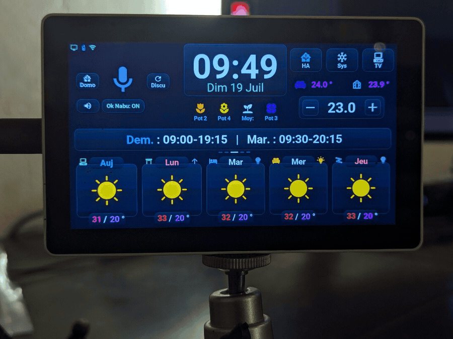

I’m looking for testers to try the different Tab5 variants.
My code runs on the ST7123, and I’d like to see whether it also works on the ILI9881C + GT911 and the ST7121.
The project (the same one as before) is still under development, though.
It has changed quite a bit since my last post, so here’s a more recent look at it:
tab5_ui_tour
The easiest way to test is here: M5Stack Tab5 Home Assistant wall screen — ESPHome and LVGL firmware
Any feedback (even “it doesn’t boot”) is welcome, here or on GitHub.
