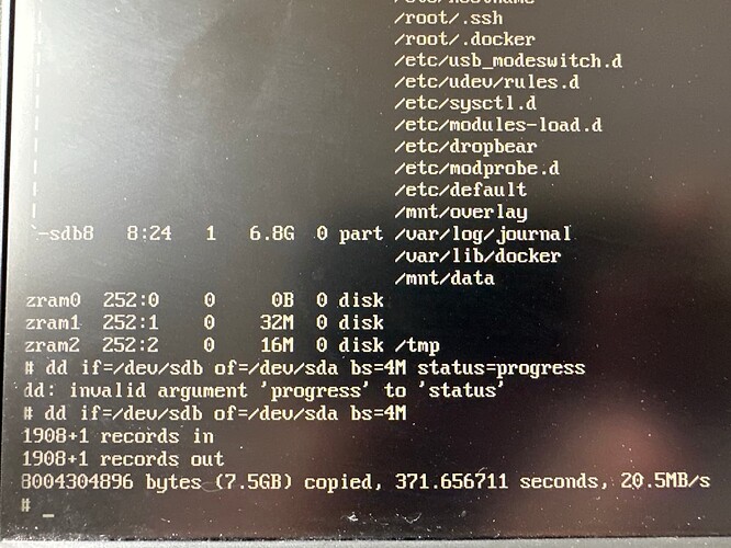

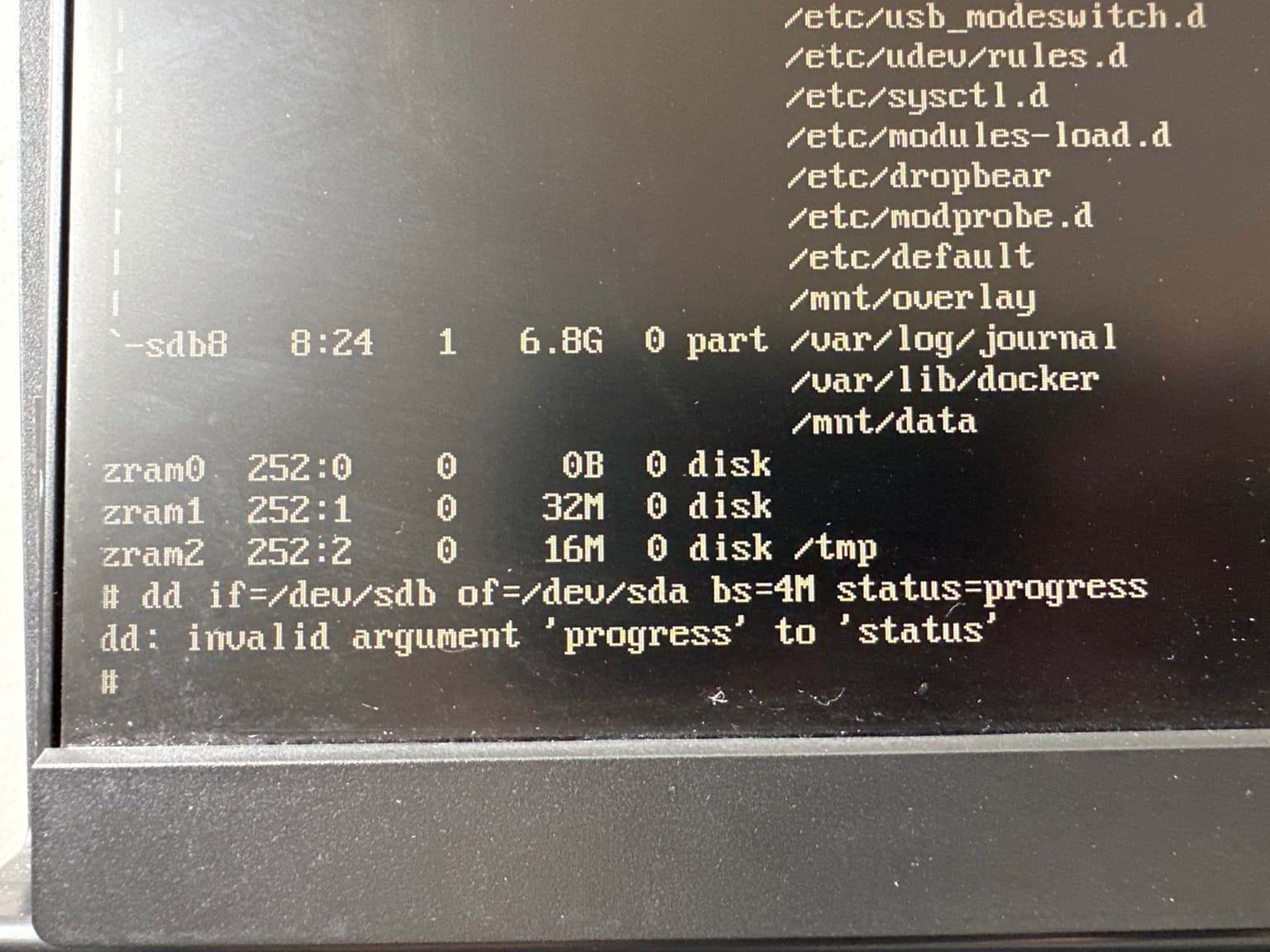

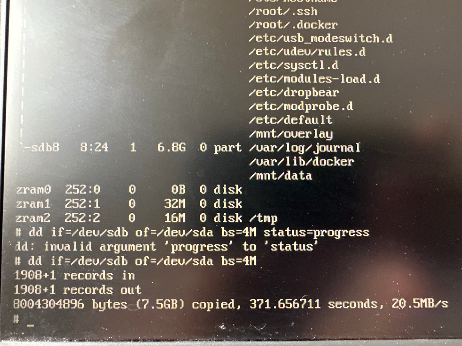

So to keep this short, I want to explain that we simply used the built in Linux DD.
before we get to this point it is obviously very important to define the hard drives correctly. If you notice, the status=progress argument was removed. The actual command was only: dd if=/dev/sbd of=/dev/sda bs=4M

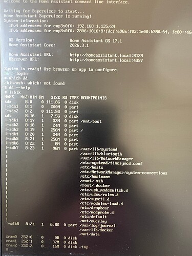

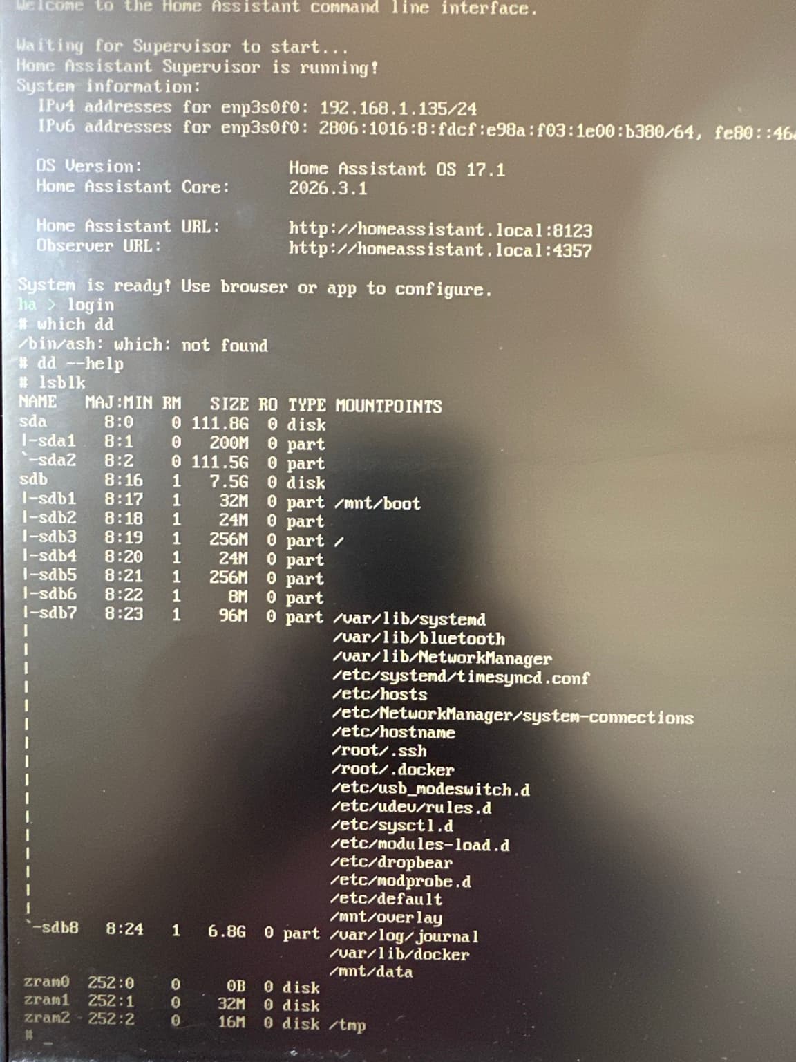

So this image illustrates what should actually be your 1st and most important steps. You want to define what is the MacHD and what is your USB.
Disk layout from lsblk
I currently have:
sda 111.8G ← internal SSD
sdb 7.5G ← USB running Home Assistant OS
And all the partitions like:
sdb1
sdb2
sdb3
sdb8
these are the Home Assistant OS partitions running from the USB.
So the situation is:
USB → running HAOS
SSD → still macOS
Which is exactly what we need to define when you write the Clone command.
