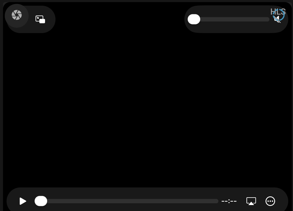

This is what it looks like in Mac OS Companion App:
Simply no picture at all. I assume some form of browser incompatibility.
On WebGUI in Mac OS Safari, the small symbol in top right sequence is:
loading, then MSE and then RTC with the live picture, which is what I want and that has great fps of the stream. Same on IOS Companion app and there the streams are almost instant.
In Firefox it shows “MSE” in the top corner and live picture is not as many fps as RTC.
On Mac OS Companion app it just says loading and then “HLS” in top corner and the not-loading blue symbol.
