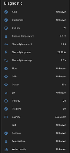

Most things are shown correctly in the device integration (certainly more than the Tuya app exposes), but there are a lot of unkowns in the diagnostic section, such as water temperature and salt/pH alarms.
The chassis temperature shows as 2.7 deg C, this seems to be a scaling error and I would think it should be 27 deg C.

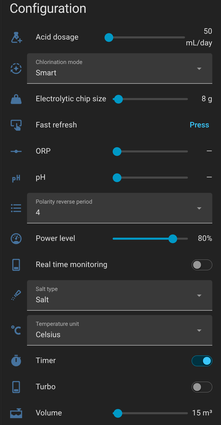

Here are screen shots of what I see:
Some more digging and it seems the yaml file is a version of the Mr Pure chlorinator with all the optional sensors fitted, which aren’t available for my model sold here in Australia.
Have disabled anything to do with probes/sensors and figured that whats left works and matches the user manual and functions/notifications available. Timers work but must be set either on unit or in Tuya app, the unit doesn’t seem to mind being directed by either HA or Tuya as long as its not at same time.
Updates to measurements is not real time, so it mirrors the Tuya app in that respect. I experimented with the chip setting (changed from 8 to 10g) and caused the unit to trip on an E1 error. It seems to read the parameter from the unit on startup so should be read only as it corresponds to the cell generation capacity that is fitted which would be used by the device to figure out how to drive the cell.
The unit keeps defaulting to Fahrenheit in HA whenever it stops, have to manually set it again in HA everytime.
The last piece of the puzzle is the chlorination mode, which I believe contains multiple modes for the Mr Pure depending on what probes are fitted. As I have only the pH doser and no probes I am taking a guess that manual (dumb) chlorination should be used, where the unit just drives the cell at the percentage you set for the duration of the run time.

I have tested most parameters but still have queries around a few:
  1. DPS 104 (boolean) - supposed to be temperature unit selection (C or F equates false or true) but my AU unit has no ability to set temperature details anywhere, the only temp sensor I have is the PSU (DPS 105) which is in celcius (hard coded). This boolean defaults to true when the unit powers up which displays Fahrenheit in HA. When you select Celsius in HA it will accept this (sets to false) and retain this until the next time the chlorination/pump cycle transitions from running to stop and it resets to true. I think on the model/country variant I have this DPS is not what the integration has defined, it must be used for something as its driven on (true) when powering up the unit.
  2. DPS 121 (boolean) - supposed to be a timer enable/disable switch but it seems to do absolutely nothing. Certainly has no impact on timers or timer operation. When set it will happily stay that way until operated back to off in HA. Once again my device may have no firmware code that uses this DPS point, I can’t see anything change in the app or on the units display when this is operated.
  3. DPS 129 (binary sensor) - supposed to be a bit map of error codes, shows OK when it returns 0. Will have to try and generate some error conditions to see if this actually works. I can generate air in cell error by backwashing, this shows in app so now with the integration running I will try it again next time backwashing is needed.
