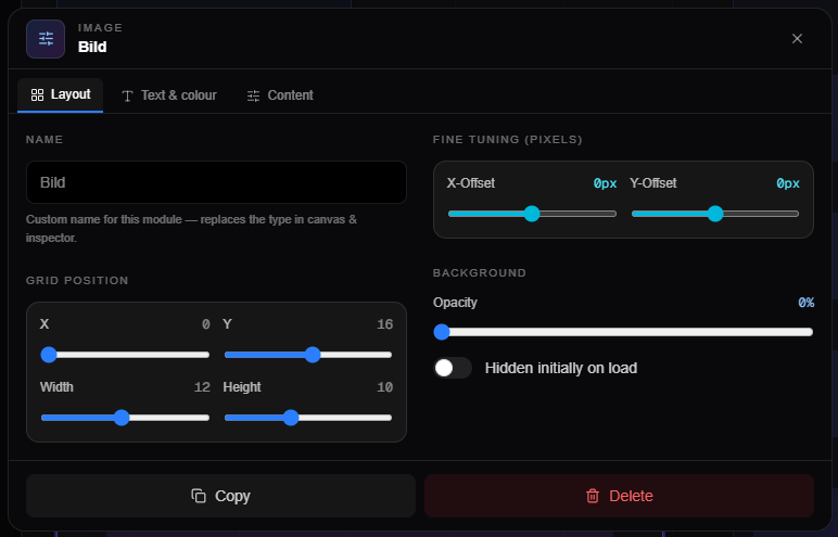

Does opacity work for the image widget?
hey, upgrading is just re-running the installer from the magic-frame folder:
cd magic-frame
./deploy/install.sh
it pulls the new version, grabs the latest images and restarts.
Your data, login and settings all stay.
two things in there, both fair:
  1. "opacity" that slider is the shared tile-background opacity, not an image
    opacity. on the image widget the photo fills the whole tile and sits in front
    of it, so the slider does nothing visible. confusing, not on purpose
    i'll hide it on the image/camera widgets. tracked in #39.

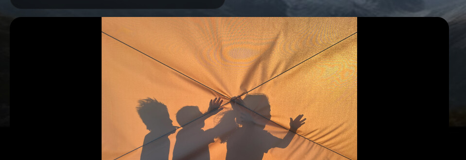

  2. the black bars are the real thing though — that's the fit setting. right now
    it's either "fill" (crops to the tile, no bars) or "fit" (whole image, but bars
    when a portrait photo sits in a landscape tile - what you've got). so it's
    crop-or-bars at the moment.
the proper fix is a third option: keep the whole image sharp and fill the bars
with a blurred version of the same photo instead of black .. like instagram /
video players do with portrait clips. tracked in #38

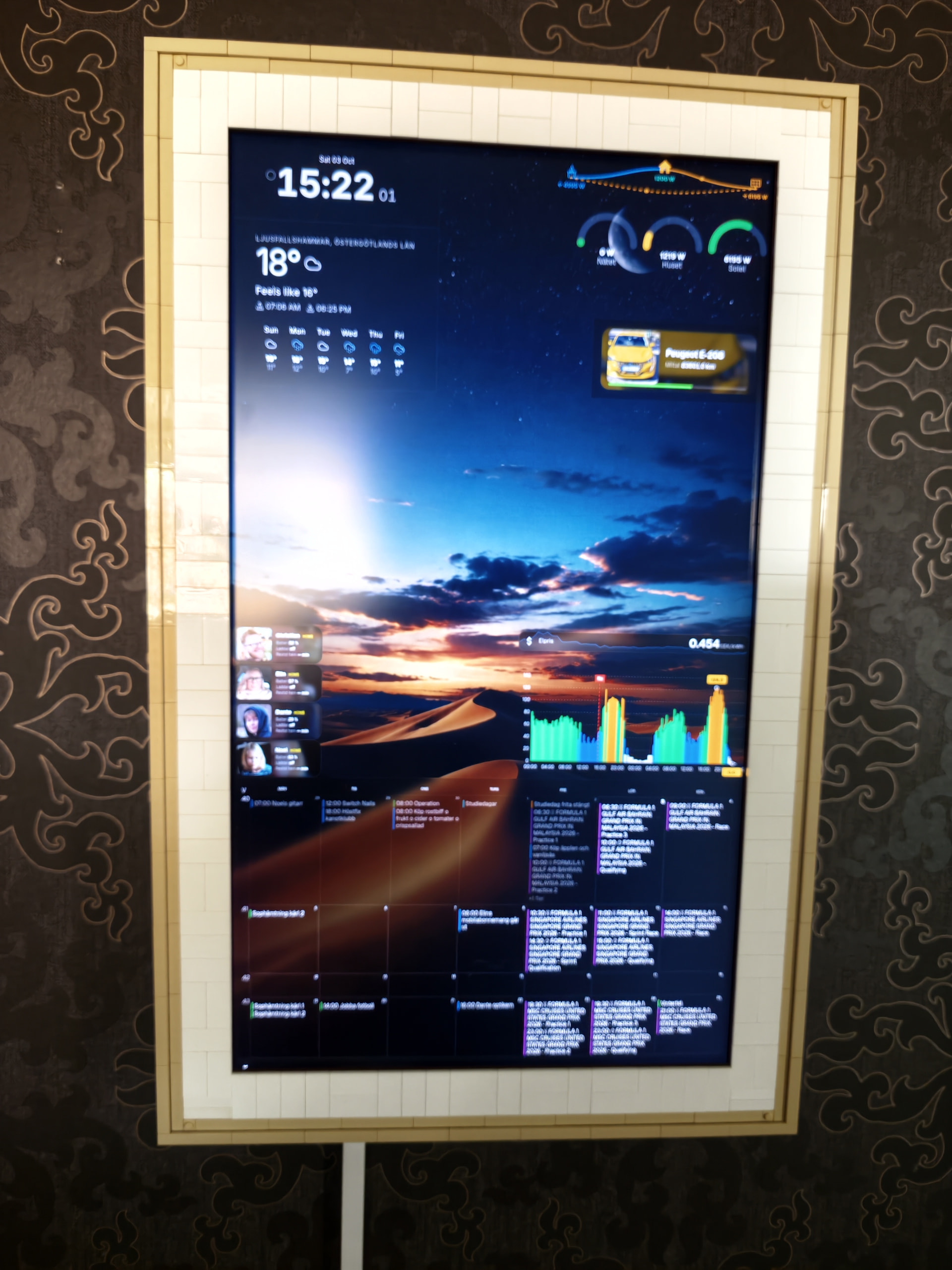

so i really like the groundwork you´ve done with this. its very close to how dakboard works and i loved that for smartthings.
i(claude) have made several plugins to mimic HA functionality. a few suggestions for the future
the ability to set the “placement grid” to a specific pixel width. i have a 4k screen and positioning with the current setup is less the precise.
more modules or a “store” for community additions.
the immich plugin, show a random image from all images instead of albums.
thanks for the great work, ill screenshot my two screens.
