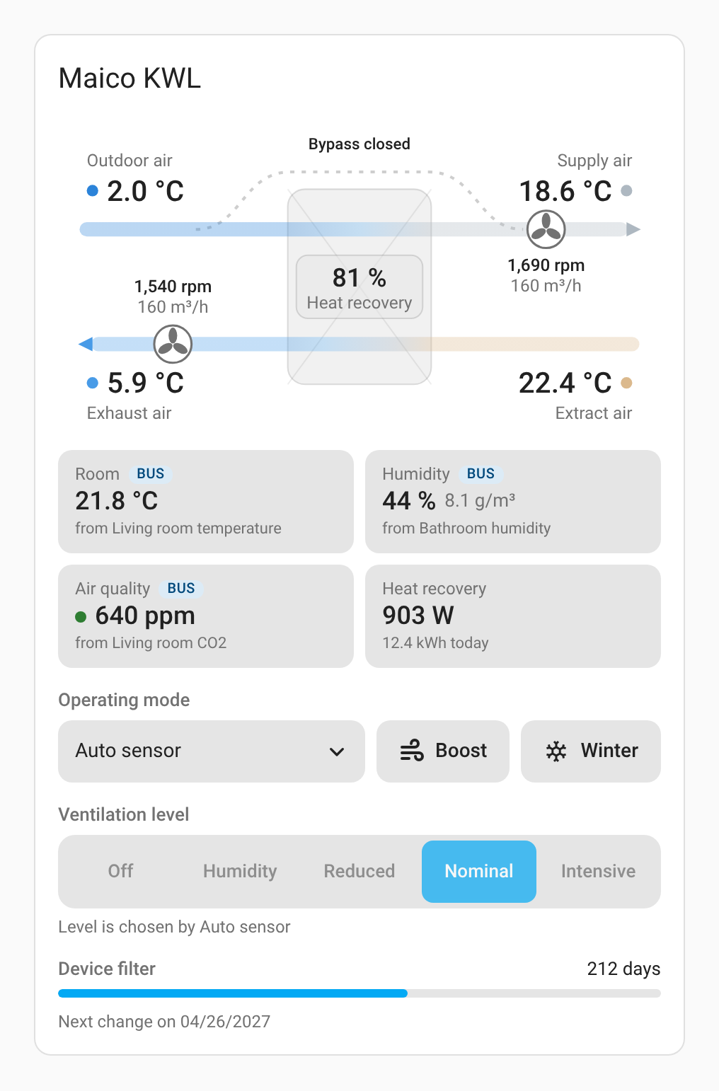

Dashboard
What it does
  • Sets itself up. You enter host, port and Modbus address. The integration probes the unit, creates entities only for the registers it actually answers and detects fitted accessories (outdoor and room filter, wired and EnOcean sensors, external room sensor). You can correct the accessories in the options.
  • Read and control: temperatures of all four air streams, humidity, air quality, fan speeds, airflow, filter days, operating hours, faults and notices by name. Operating mode, ventilation level, boost, setpoints and airflow rates can be changed.
  • A fan entity that combines mode and level, so voice assistants, HomeKit and fan cards work.
  • Feed your own sensors to the unit. Room temperature, humidity or CO2 from any Home Assistant entity can be written to the unit’s bus inputs and are kept fresh automatically.
  • Values the unit does not report: heat recovery power, energy (kWh) and efficiency, dew point and absolute humidity, filter change reminders, and repair notices for faults and due filters.

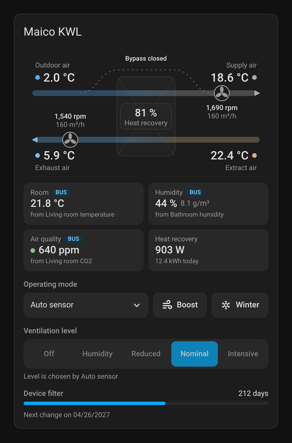

  • A dashboard card is included (new in 0.4.0): the airflow through the unit with the air coloured by its temperature, so you see the heat exchange at a glance, plus room values, controls and filters. It comes with the integration, no extra resource to add.
