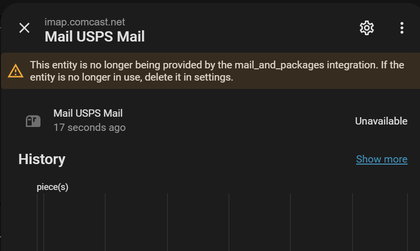

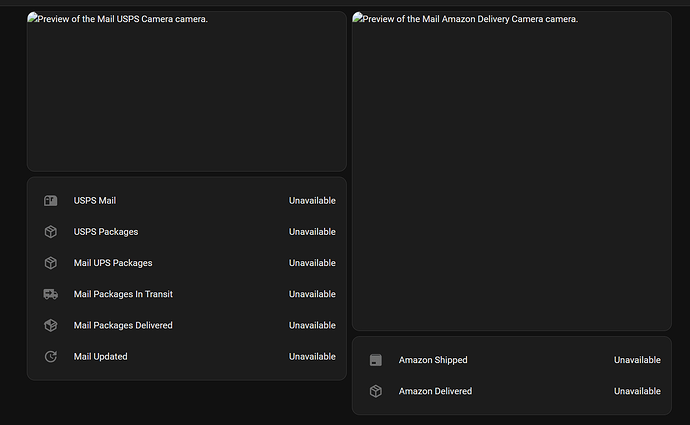

Not sure what update, but now all my entitles for the mail integration show unknown.
My logs show errors but just template errors because the values are Unknown.
Should note if I click on anything in the above I get.
SIde item, is it fair to say that the developer renamed all the entities adding in the email server address into the start of the variable and other changes? If so why?
All of mine now show unknown as well. Not sure what changed?
For me here’s what changed and what a pain to fix all over. I didn’t label them but they are old value and new value. This is for my setup:

Thanks for the reply. Any idea why all the sensor names changed? Seems like we are going though a lot of these all through home assistant.
Some users have multiple instances of mail and packages going, and it caused entitiy_id collisions.

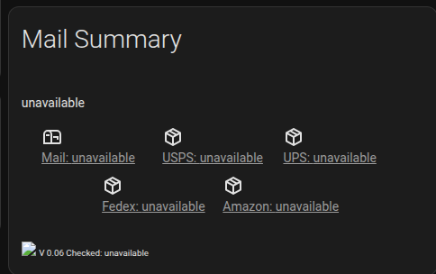

In my case the custom card (version 0.06) had been showing unknown the past 2 weeks ish. I’m on version 0.5.1-b14 of the integration. I got some time today to look into why. For reasons unknown to me, my active sensors all have new variable names with a “_2” appended. The old once are there -just unavailable:
Before (showing unknown on everything):
type: custom:mail-and-packages-card
updated: sensor.mail_updated
details: true
image: false
fedex_packages: sensor.mail_fedex_packages
ups_packages: sensor.mail_ups_delivering
usps_packages: sensor.mail_usps_delivering
amazon_packages: sensor.mail_amazon_packages
usps_mail: sensor.mail_usps_mail
camera_entity: camera.mail_usps_camera
deliveries_message: sensor.mail_deliveries_message
After updating (adding the “_2” to the sensor name) by editing in YAML using Show Code Editor on the card configuration:
updated: sensor.mail_updated_2
details: true
image: false
fedex_packages: sensor.mail_fedex_packages_2
ups_packages: sensor.mail_ups_delivering_2
usps_packages: sensor.mail_usps_delivering_2
amazon_packages: sensor.mail_amazon_packages_2
usps_mail: sensor.mail_usps_mail_2
camera_entity: camera.mail_usps_camera_2
I also had to update the “mail_deliveries_message” Device and Services > Helpers > Mine called “Deliveries Summary” > Settings Cog > Template Options. Added the sensor names with “_2” there also. After that all looks good. Not sure what triggered the full sensor duplication, but I think it may have happened during one of the beta integration releases, but honestly wasn’t paying attention.
Now my card is showing all the correct things. I’m going to let it stabilize before I clean up the old unavailable sensors, since there are a lot of them.
