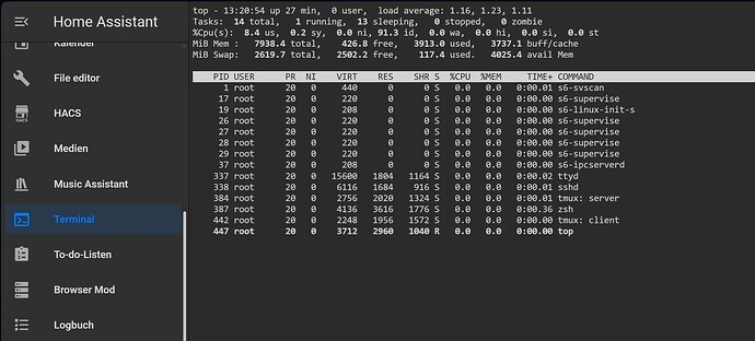

This is what “top” from within the HA-terminal shows:
Not really useful, isn’t it?
