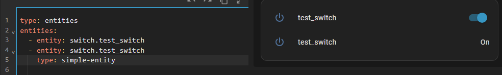

You have two options, which have already been provided in this thread:
  1. Create a new entity which represents the read-only state of the switch
  2. Change how your dashboard displays the switch
Option 1 requires a new entity per switch, and you will have to write a template to reference the state of the switch.
  • Settings → devices and services → helpers → create helper → template → binary sensor
  • The state will be {{ is_state('switch.your_switch_entity', 'on') }}
  • You can choose a device class which will affect how the new entity is displayed on your dashboard. You might try either Plug or Power.
Option two requires you to update your Dashboard, and it’s going to depend on which card you are using to display the entities. If you are currently using (or don’t mind changing to) an “entities” card, you will need to:
  • go into the dashboard editor UI
  • find the entities card that you want to change
  • select “edit”.
  • Press the button in the bottom left for “show code editor”.
  • Now under each entity that you want to change to read-only, add a new line with this text and the same indentation as the line above it type: simple-entity

type: entities
entities:
  - entity: switch.my_switch_1
    type: simple-entity
  - entity: switch.my_switch_2
    type: simple-entity
