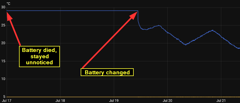

I have several Zigbee devices and I am already monitoring Battery life at some degree.
But sometimes they die at 50%, staying unnoticed, because Battery life stays above the threshhold unnoticed.
Therefore Id like to “force” devices to go “unavailable” or “unknown” if they lost power.
Currently they stay at the last known read value, making my automations a bit messy.
See example:

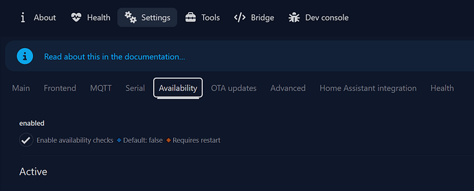

You can - check out availability settings in Z2M. Here is an example, my rain sensor has gone offline:

Go to Z2M > Settings > Availability.
Enable that & restart Z2M. Further down that screen are the options for Active timeout (mains powered devices) and Passive timeout (battery & no neutral devices). These default to 10 minutes and 25 hours respectively.
You could reduce the battery value to something less than 25 hours (1500 minutes), but be aware that the lower you set it, the more you will increase battery consumption.
The equivalent setting in ZHA is set to 6 hours, which I believe is too low, but something like 12 hours (720 minutes) should be a fair compromise between timely reporting & battery consumption.
