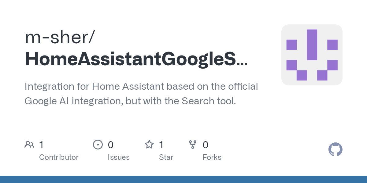

try this
Not a particularly elegant solution to the problem, but using search allows you to retrieve any information you want
Functionally this is EXACTLY what I am looking for, thank you! It would be nice to understand behind the scenes and / or build the pipeline myself so I can switch to a local LLM or other, non-Google in future. But for now this is great, thank you!
I’m just using Gemini right now since it is free and I can figure out how this stuff works. My goal is to replace my current Alexa devices with HA devices.
