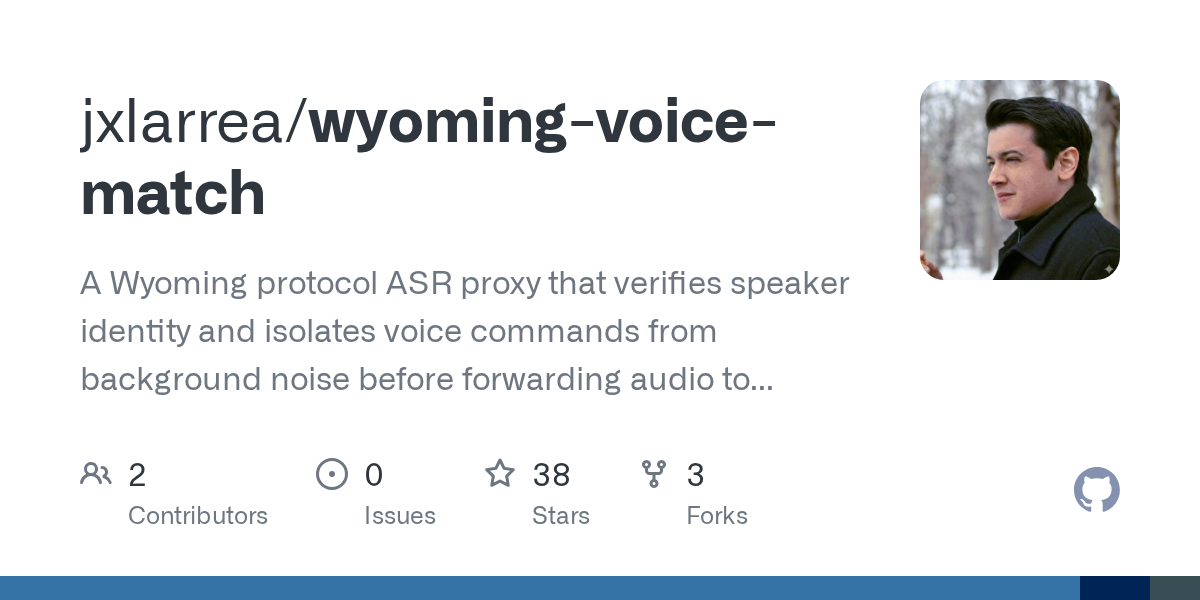

HA side currently cannot be force-stopped by STT server
I have a client and a server that implements this. You can add sending a stop signal (modification is backward compatible, the standard client simply ignores it) to your project and test it with this custom client.
Thanks a lot for the pointers and for sharing your approach.
I want to highlight one ecosystem issue here: Home Assistant currently does not let an STT server reliably stop the microphone capture from the server side, which is not very reasonable for this kind of pipeline. It would be great if someone could contribute a proper HA PR for this, instead of every user reinventing custom client-side workarounds.

This isn’t implemented at the system level because it doesn’t make much sense right now, especially when working with offline (non-streaming) ASR (which is what 99.9 percent of users use).
In this case, the custom server developer literally duplicates the functionality of the system VAD, but based on their own criteria. For example, in the matching project I linked to, you could add an interruption to listening if the target voice is no longer detected.
I wouldn’t call this reinventing anything new, as everything remains within the protocol; we simply added logic for handling premature TranscriptStop event. All new ideas are tested on custom components, so this is normal practice. It’s still too early to release something like this.

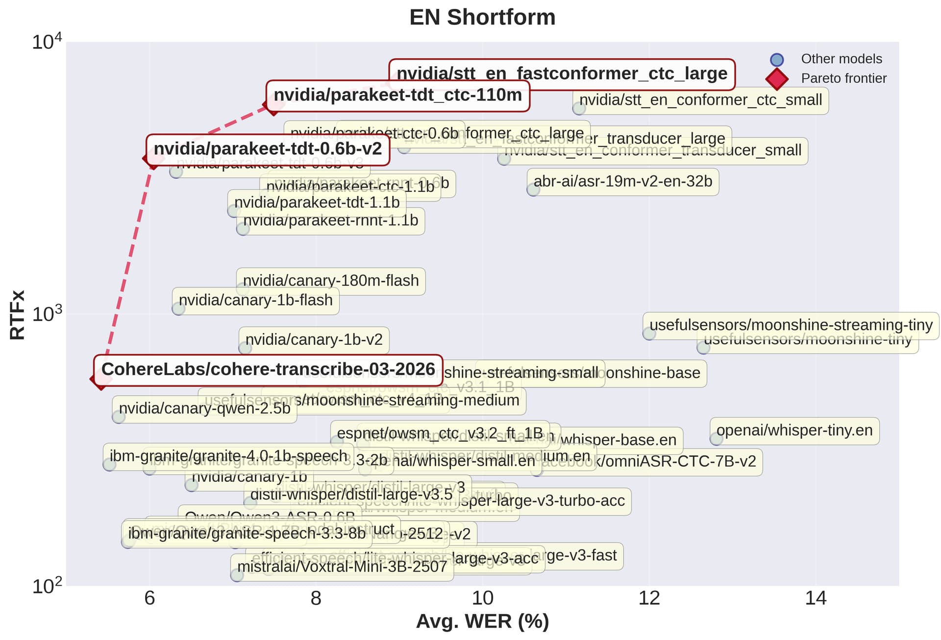

It’s also not entirely clear why your project is tied to qwen; it’s far from the best engine, neither in terms of quality nor speed.
Thanks for your thoughtful feedback — I actually agree with many of your points.
Parakeet is a very strong model, but unfortunately I can’t use it for my current setup because Chinese support is a hard requirement (:sweat_smile:).
Before this, I mainly used Whisper large-v3 on GPU, which is also excellent, but in my tests it struggles more when there is speech mixed into background music/TV audio. Qwen helps reduce that issue in my environment.
