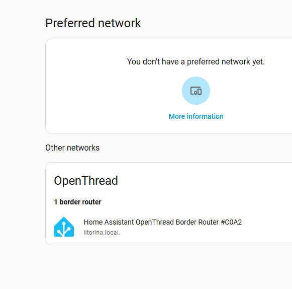

I use a C6 and it is connected to my HA but I can’t select any network.
It is solved. After restart of HA my preferred network was set.
