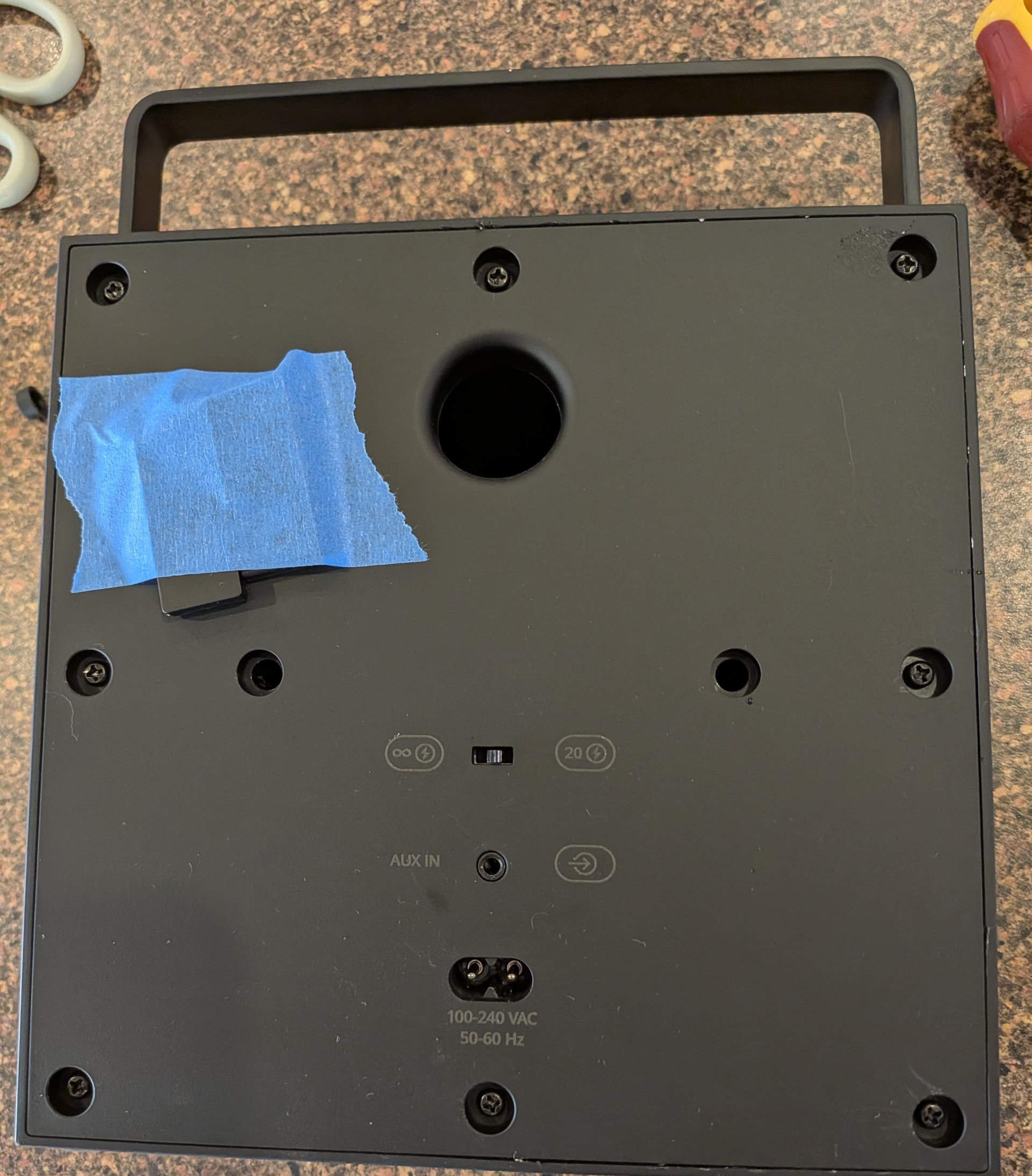

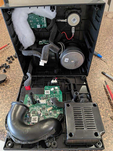

Opening the speaker is easy. There are a few screws on the back behind the rubber caps. You then need to pry the front off carefully.

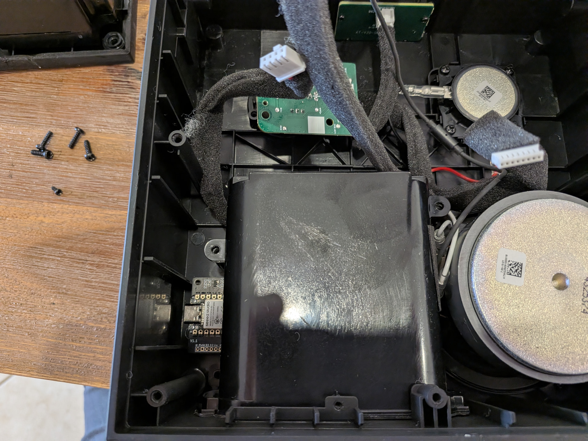

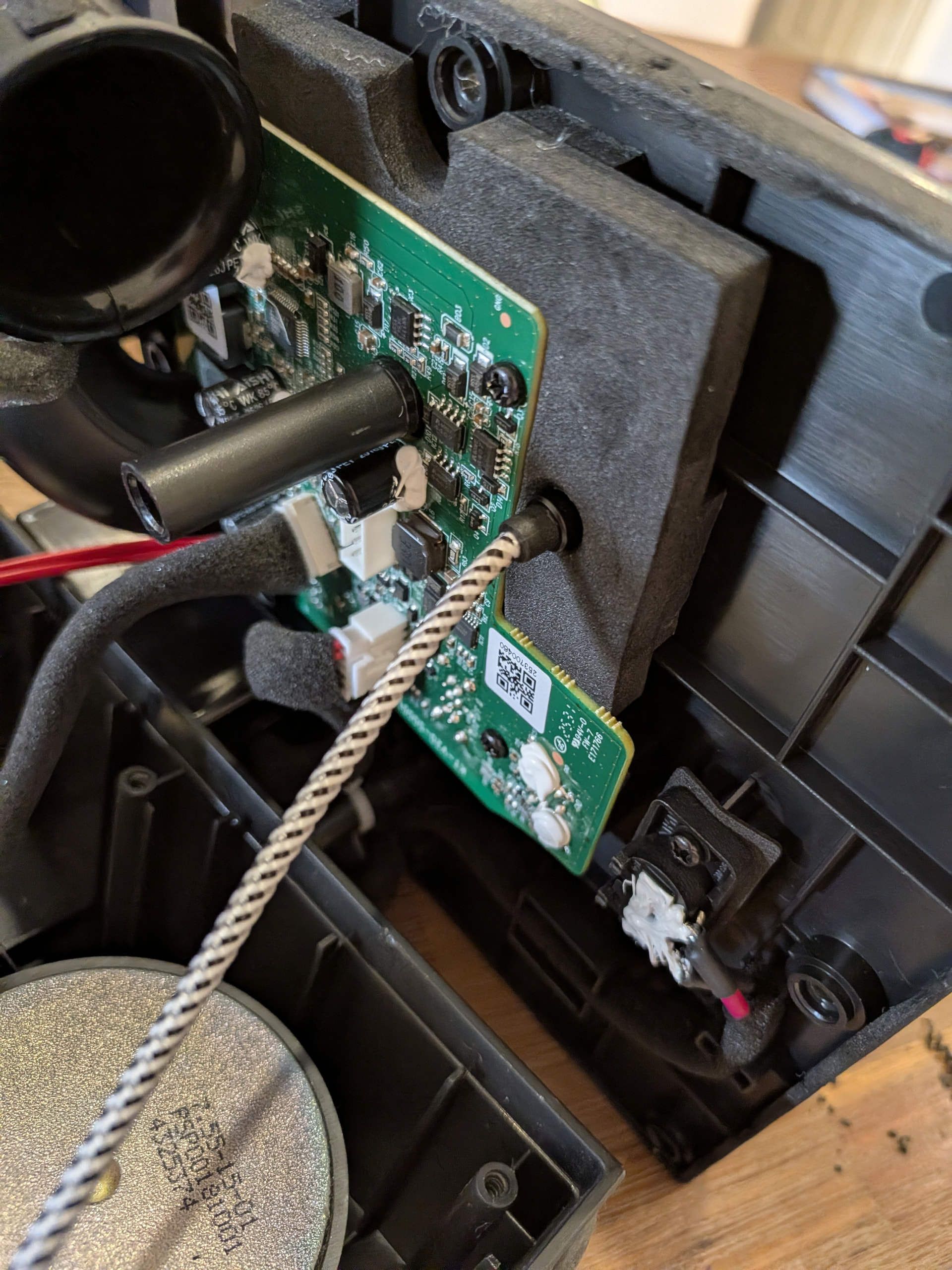

The inside has lots of room for additional devices:

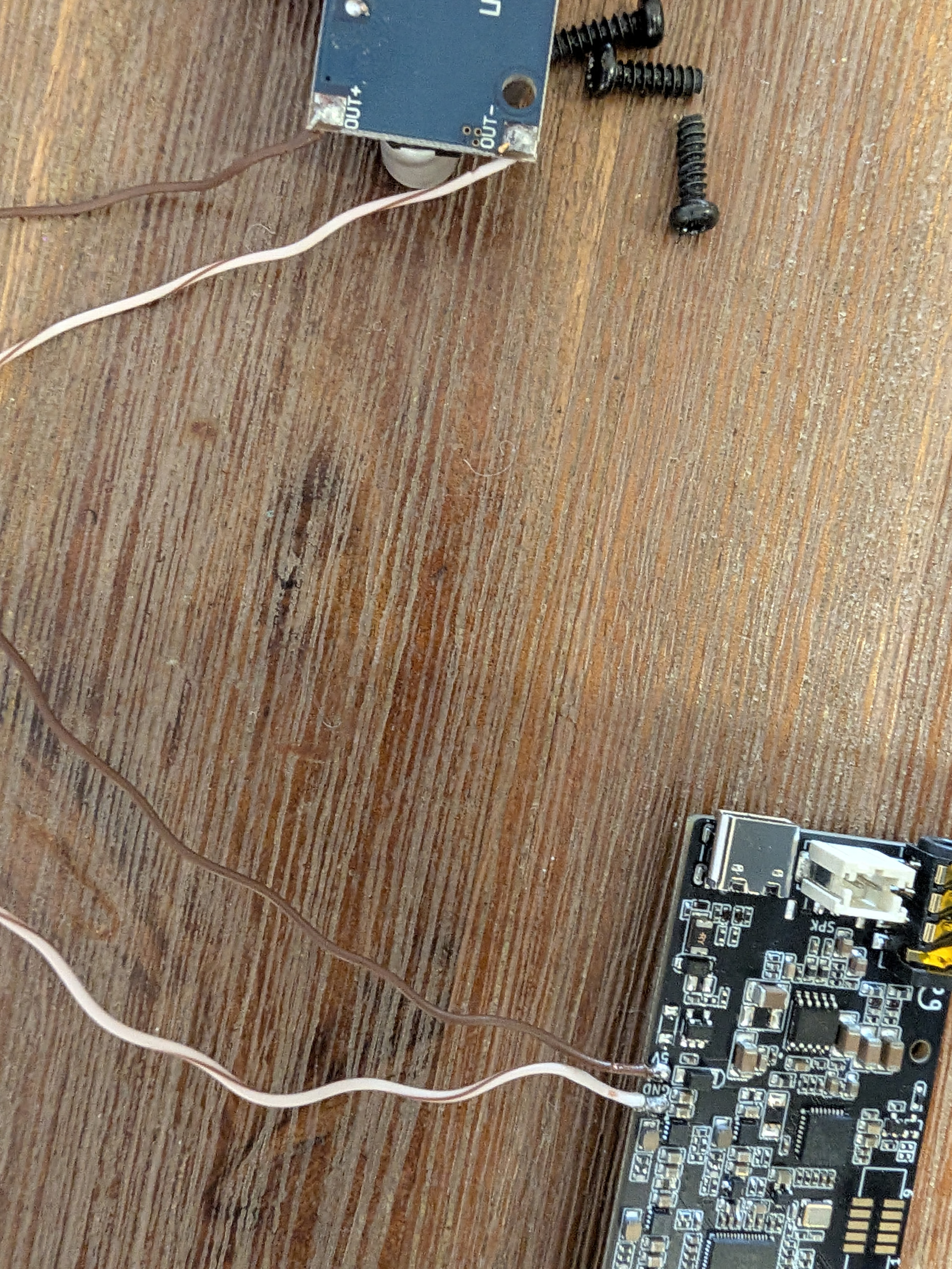

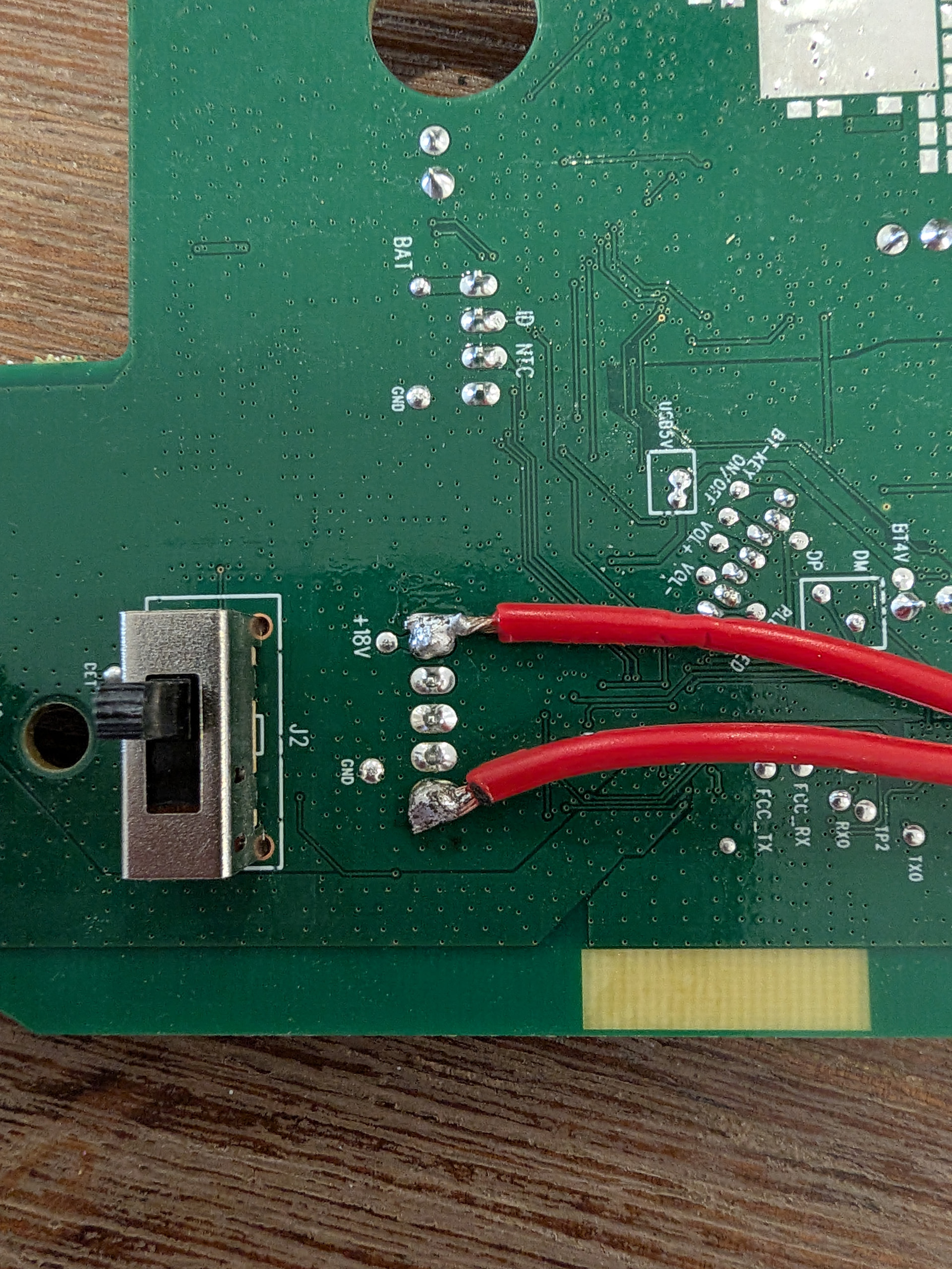

I soldered wires to the 18v and ground pins

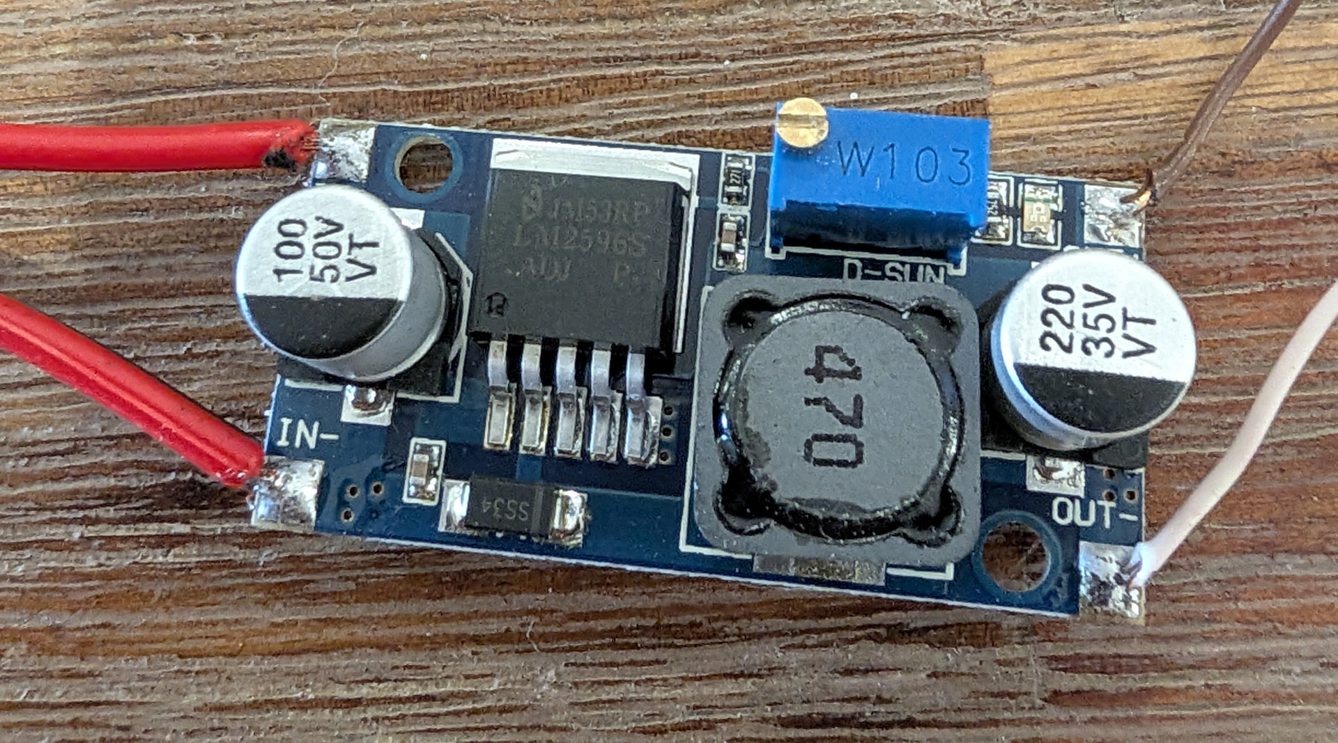

Connected to my step down converter (to get 5v for a Respeaker Lite)
The other end was connected to some sold cat 6 wiring since that’s all I had, and it’s fine for a short length of 5v at a low amperage.
You then need to adjust the converter to get 5v, ensuring you do this with your wires (and not directly onto the board) to factor any voltage loss over those wires.
Once happy with that, connect to your Respeaker Lite and power it on to make sure you haven’t shorted anything

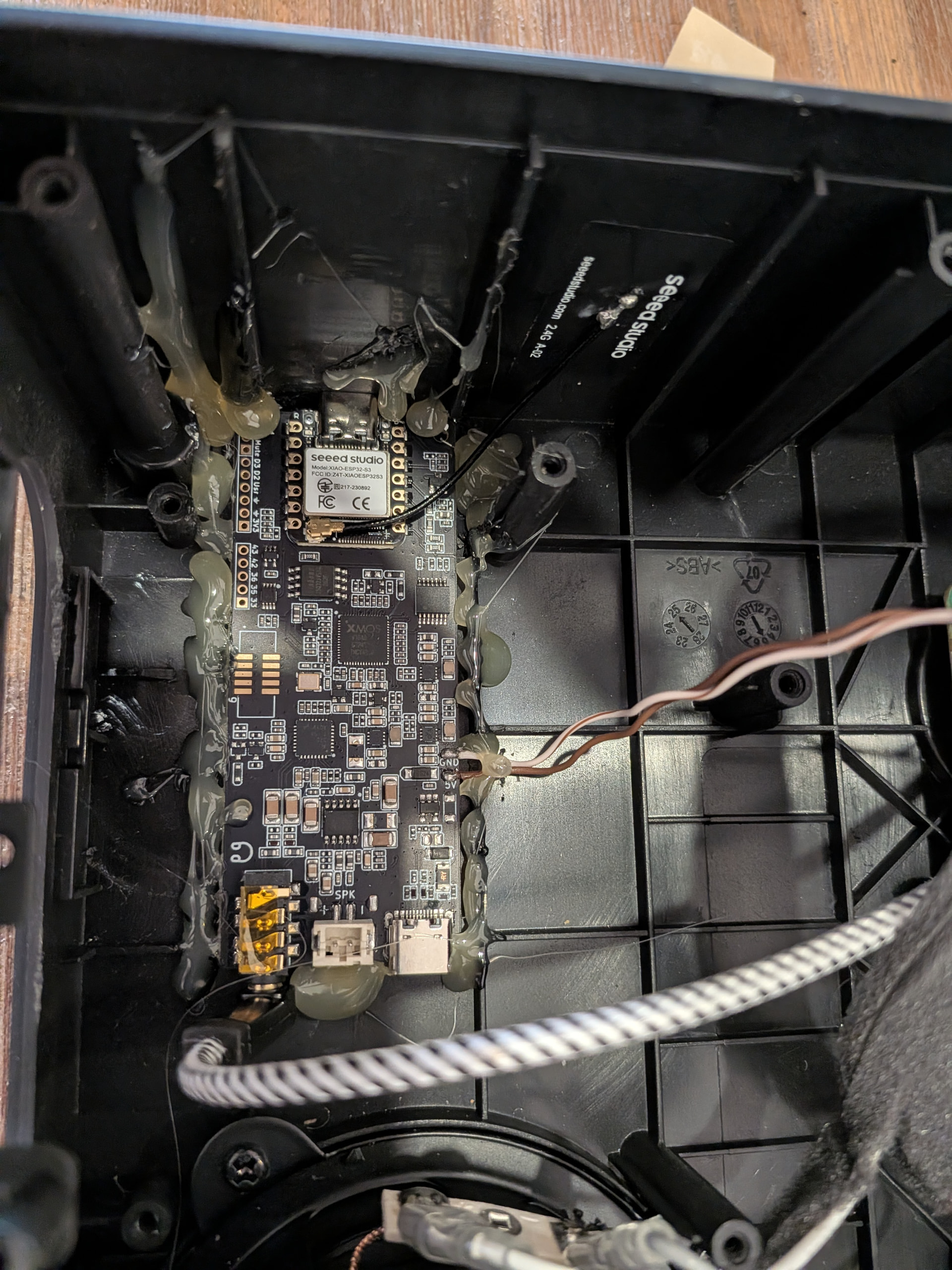

Next up is to mount the Respeaker. It fits behind the battery bay:

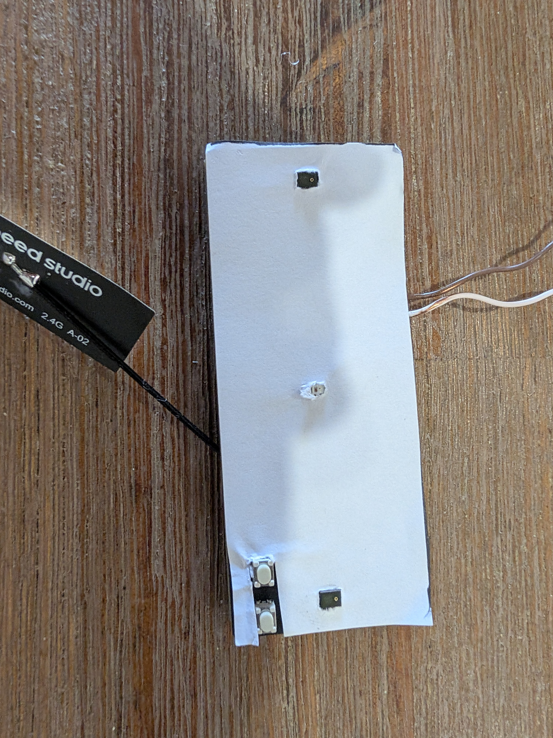

To ensure the holes are in the correct spot, you can cut out a stencil from some paper. Make sure you remember which side is the front and which side is the back.

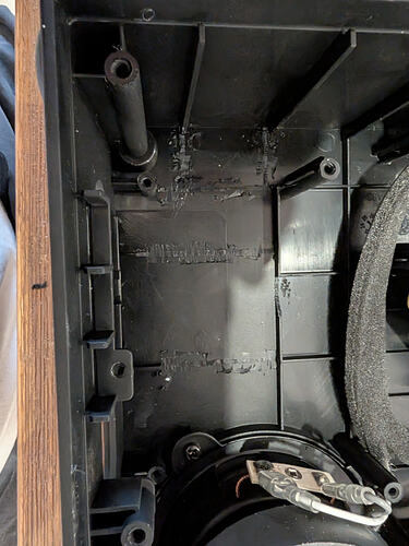

You need to remove some of the structural supports to make it flat, so you can try keep the speaker somewhat airtight, and have the microphone stick out a little bit.

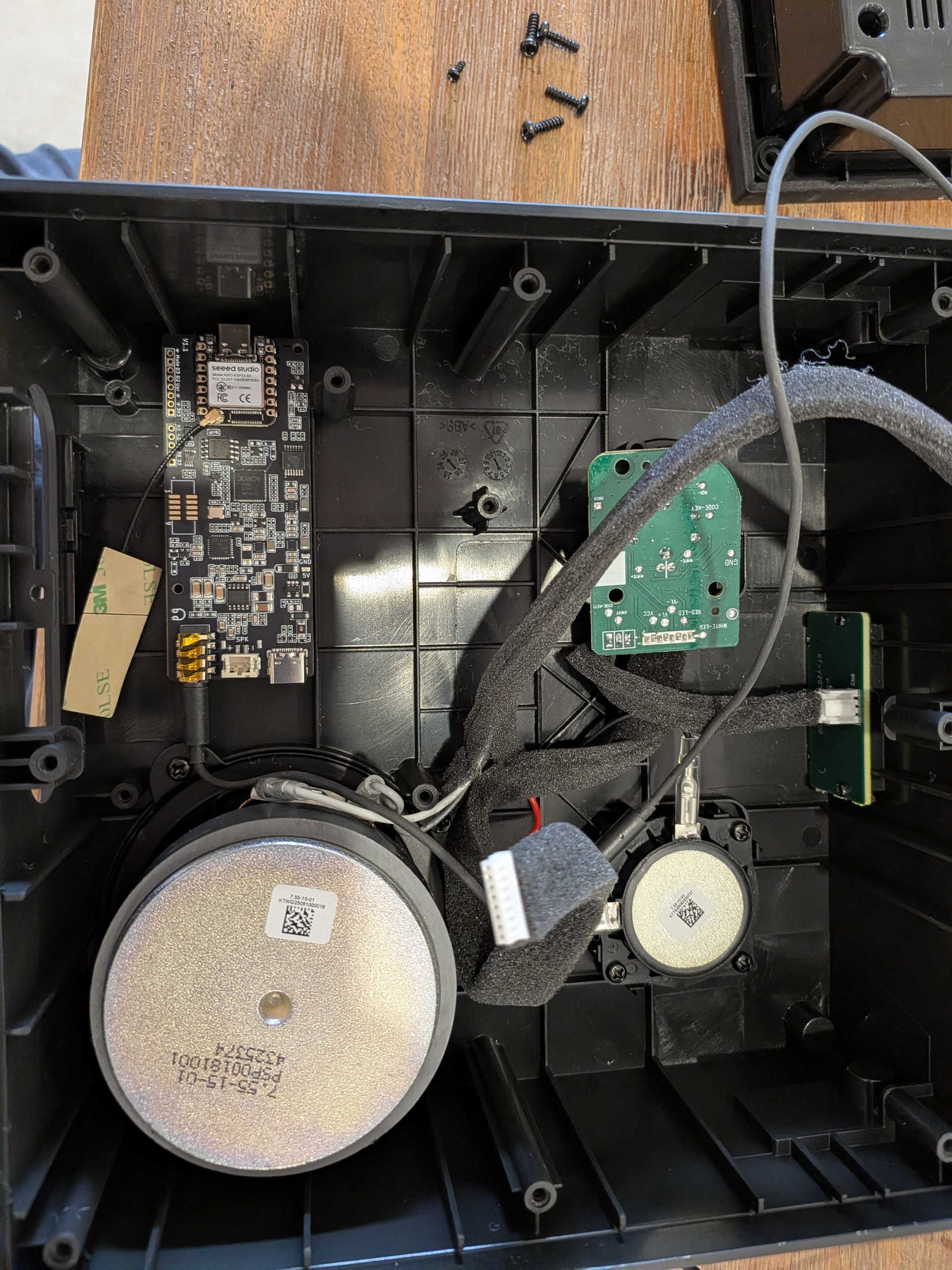

You then need somewhere for your 3.5mm wire to exit, so it can be plugged in. I used a male-to-female extension and placed it through the foam to try keep it somewhat airtight:
I used hot glue to hold the Respeaker Lite in place, mostly because it’s easier and I won’t be using the buttons so it should stay in place easily.

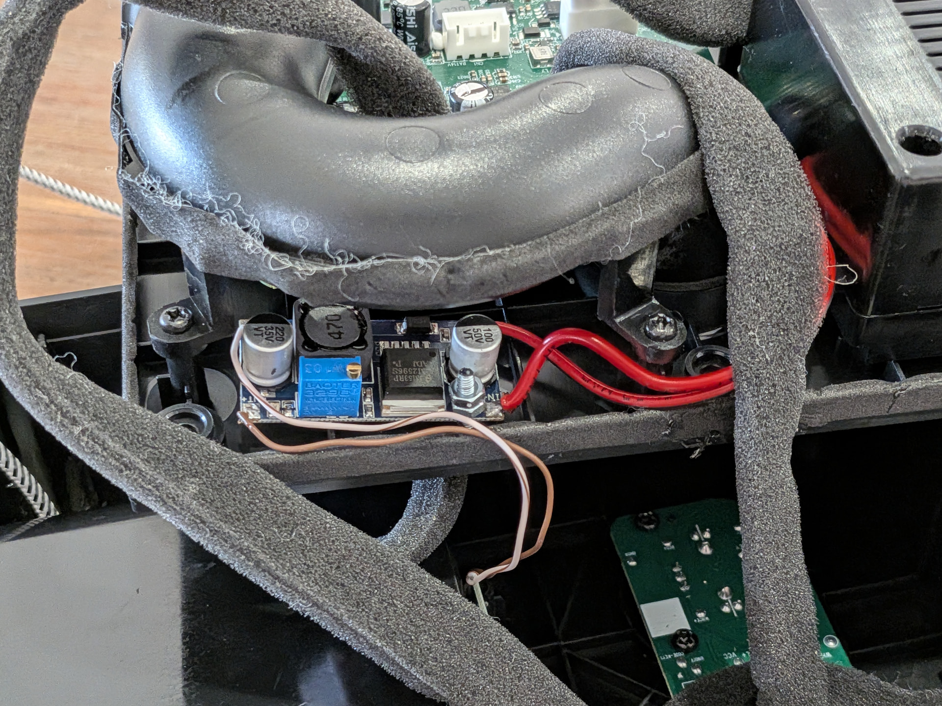

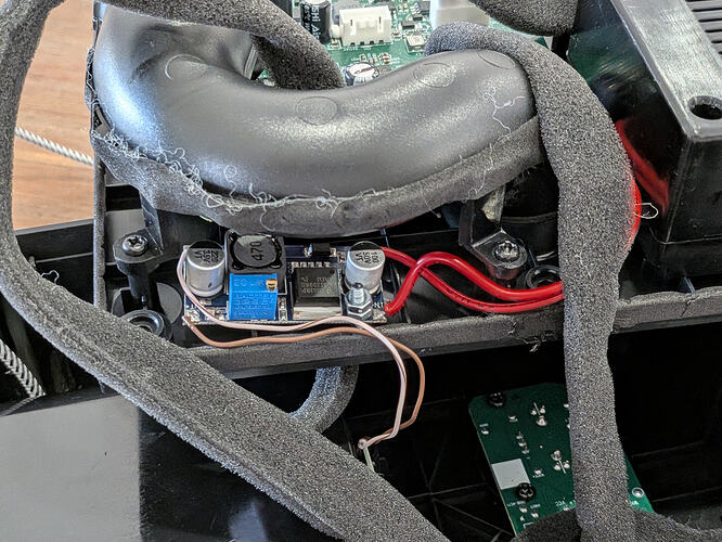

Mounting the step down converter was a little less elegant. I just placed a 4mm bolt and nut through the back.
All done! Sounds and looks good to me. I just need to find or print a cover for the front.
