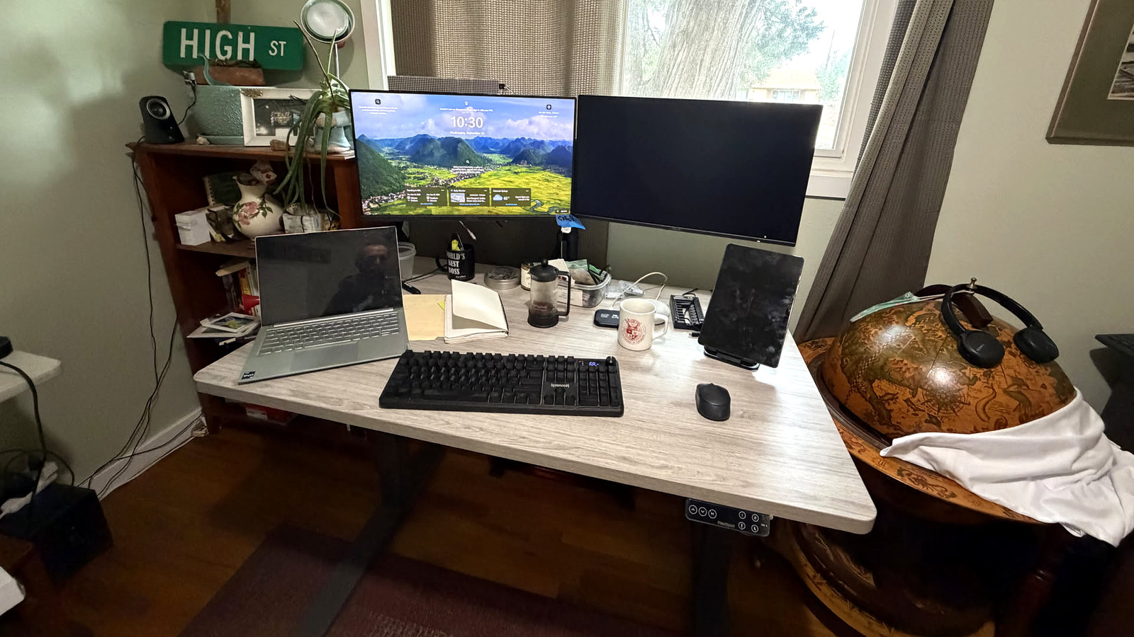

I just replaced my old standing desk with a FlexiSpot E7 Pro with one big question in mind.
Can I get this thing into Home Assistant?

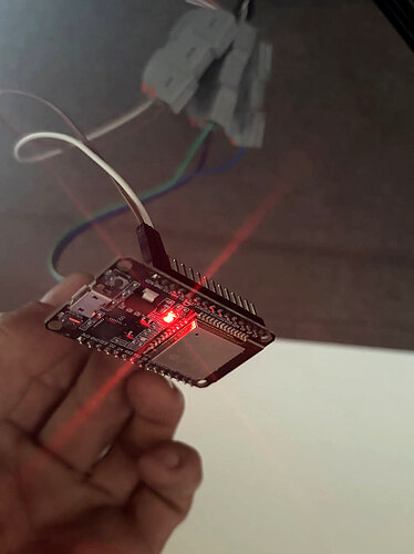

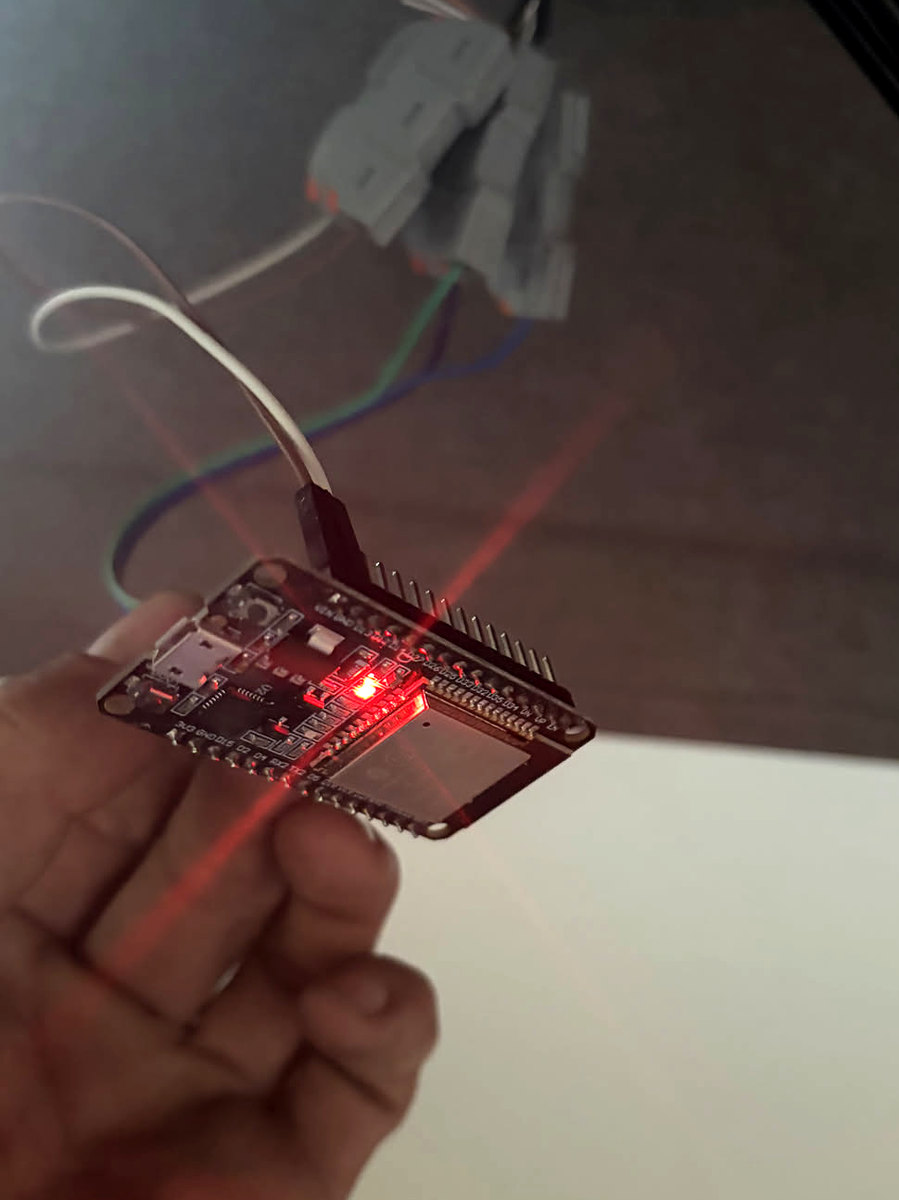

The FlexiSpot uses RJ45 and a different protocol than their existing version, but the hardware for my prototype ended up being surprisingly simple. An ESP32, a short Ethernet cable, a few WAGO connectors and some Dupont wires.
No soldering. No custom PCB. The desk even powers the ESP32 itself.

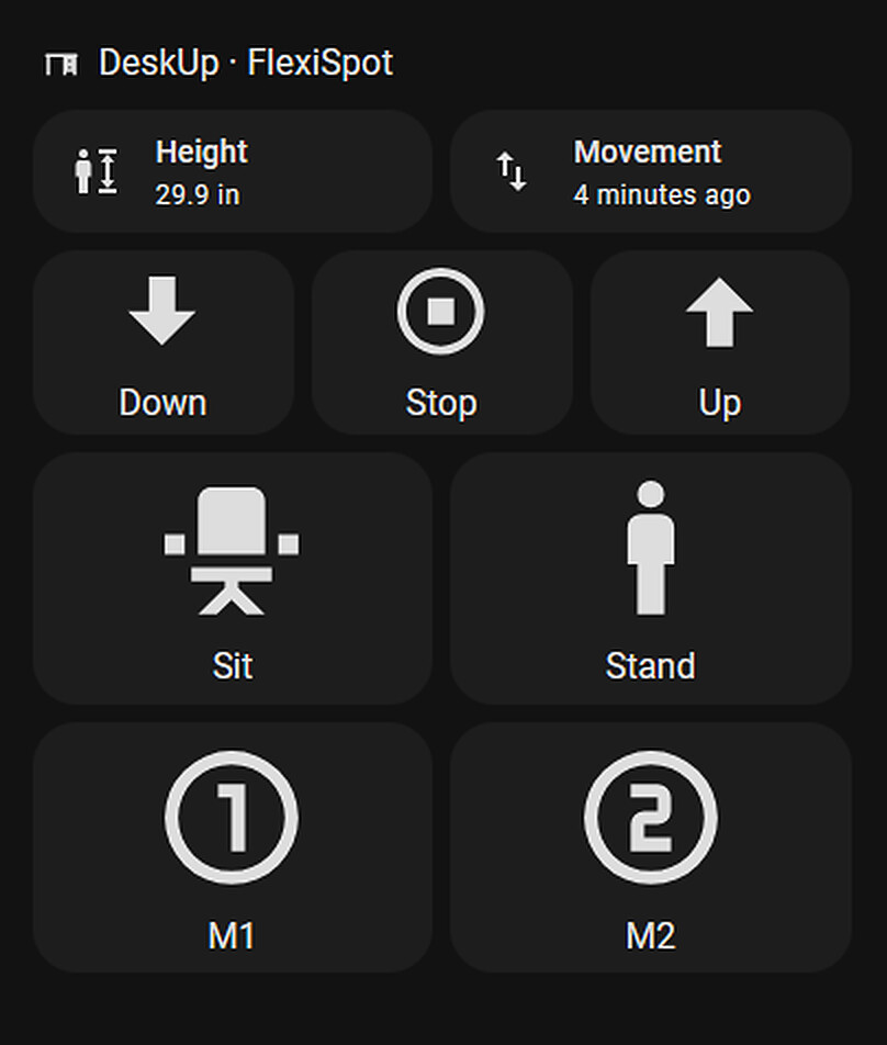

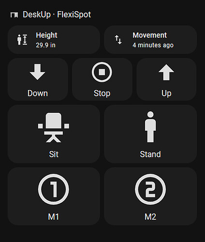

Once it was running ESPHome, I had the desk in Home Assistant with height, movement and idle information along with controls for the desk itself.
And of course, getting it into Home Assistant meant I had to automate it.

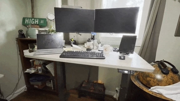

My coffee routine now checks whether I’m sitting or standing and changes the desk position when my coffee is ready.
4flexipost-e7-pro-motion
Completely necessary? No. :slightly_smiling_face:
But it has actually gotten me standing more.
