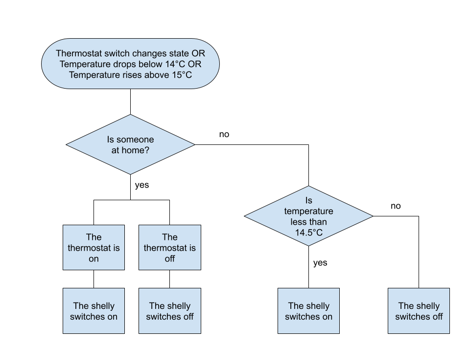

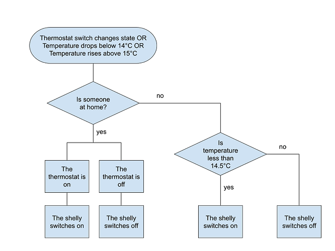

This is the flow diagram I developed while thinking about this.
I have a helper that is set “on” when someone is home but “off” when no one is there. That is what decides who does the controlling. If it is “on”, then the automation doesn’t need to do anything as the Shelly deals with things. If it is “off” then the Home Automation needs to keep the temperature at about 14.5°C.

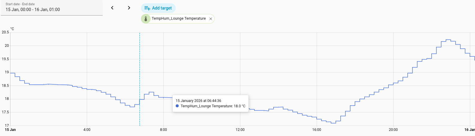

Hi Neill, I am interested to read about your project. I have been thinking of doing something related and delayed for 2 years now. Let me explain, and I have one suggestion. I have an UFH system in the UK, and it works fine except in very cold weather, when from a lower ‘during the day’ set point, the system never gets to temperature in the evening - see image with internal temperature - I want the system to be stable at around 20C between 18:00 and 22:00 at least. The house I live in also has an older radiator system, with high water flow temperature and smaller radiators - we don’t use it. I wanted to put the Shelly 1 on this thermostat line to be a ‘booster’ on cold days that the system can’t cope with. I realised this would mean setting the ‘booster’ thermostat to something like 21C and feared if HA crashed or something, that the heating would be permanently on. I used Gemini to find a solution to this. I run my automations in Node Red through the add-on, you might not know it, but I think you will be able to follow the logic. Below is the output from Gemini explaining how to create a firmware (Shelly) kill switch.
