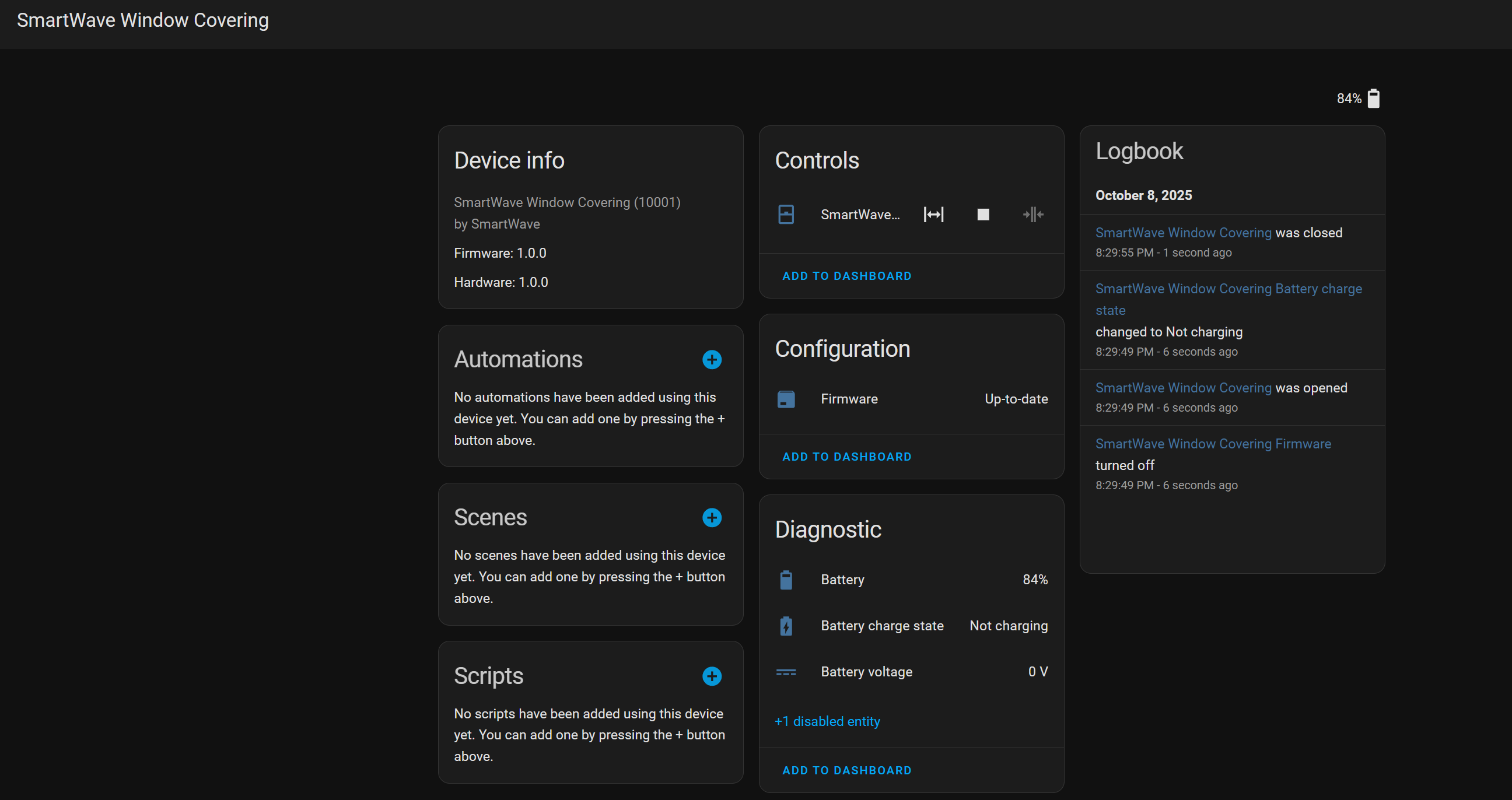

Nice! Thank you for the info. This is how I got it to work for those searching in the future.
1.) Add Matter Addon by searching in servers UI App store… Sorry i had pictures but am limited to only one as a new user
2.) HA > Settings > Devices & Services > Devices > Add Device > Add Matter device
3.) Proceed>Submit>Finish
4.) Add Device > Add Matter device > Yes. It’s already in use > Apple Home… then follow instructions
