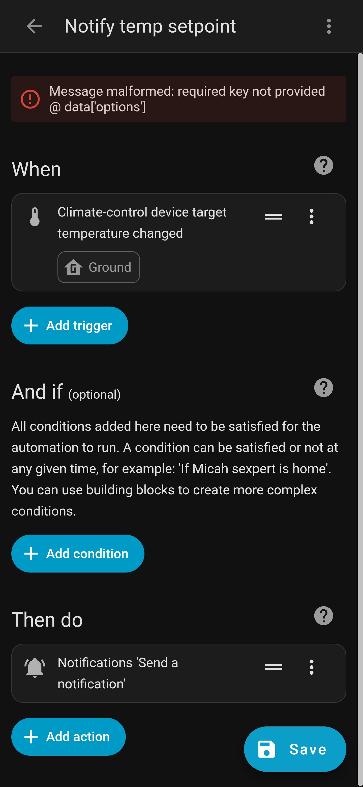

Any suggestions to fix error Message malformed: required key not provided @ data['options'] for this automation created with the new labs purpose-specific trigger for climate setpoint changed? I tried both with an area and with the climate thermostat entity, same error with both.

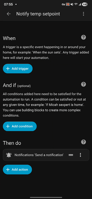

1000012068
Yaml it generated, that has error when trying to save
alias: Notify temp setpoint
description: ""
triggers:
  - trigger: climate.target_temperature_changed
      floor_id: ground
conditions: []
actions:
  - action: notify.notify
    metadata: {}
      message: Temp set
mode: single

I did use the UI, as you can see in the gif.
This is using UI to pick the device rather than the area

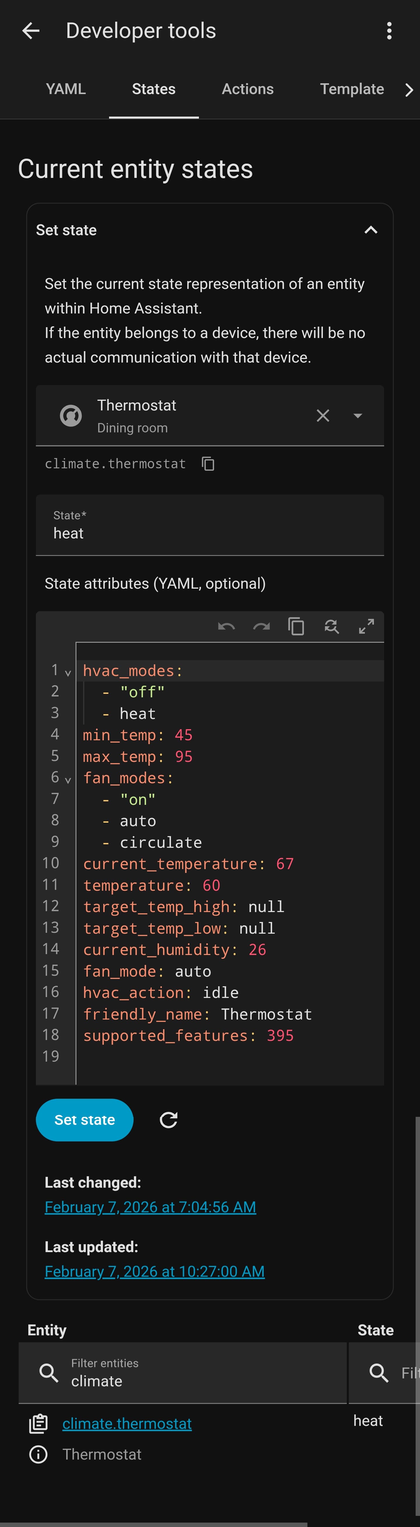

I did not want to try your state version, because it’s YAML I do not understand and suspect may be wrong, and ultimately would rather use UI anyway. My reason in sharing YAML was to help other people see what exactly UI had made for me without needing screenshots of the multiple different UI screens. I suspect it may be wrong because ground is a floor, but you labeled it as id. And I don’t think climate.target_temperature exists per developer tools, either as a state or an attribute. I do see attribute climate.temperature in my developer tools, but I know attributes often can’t be called the same way as states so I don’t really know if that’s equivalent in the context of automation.
climate.target_temperature_changed is what got filled out automatically by the new Purpose-Specific Triggers UI when I selected my thermostat. I guess this is the github pull request for the new trigger type, although it doesn’t mean much to me Add trigger climate.target_temperature_changed by emontnemery · Pull Request #159434 · home-assistant/core · GitHub, and here’s what developer tools shows when filtered for “climate”
