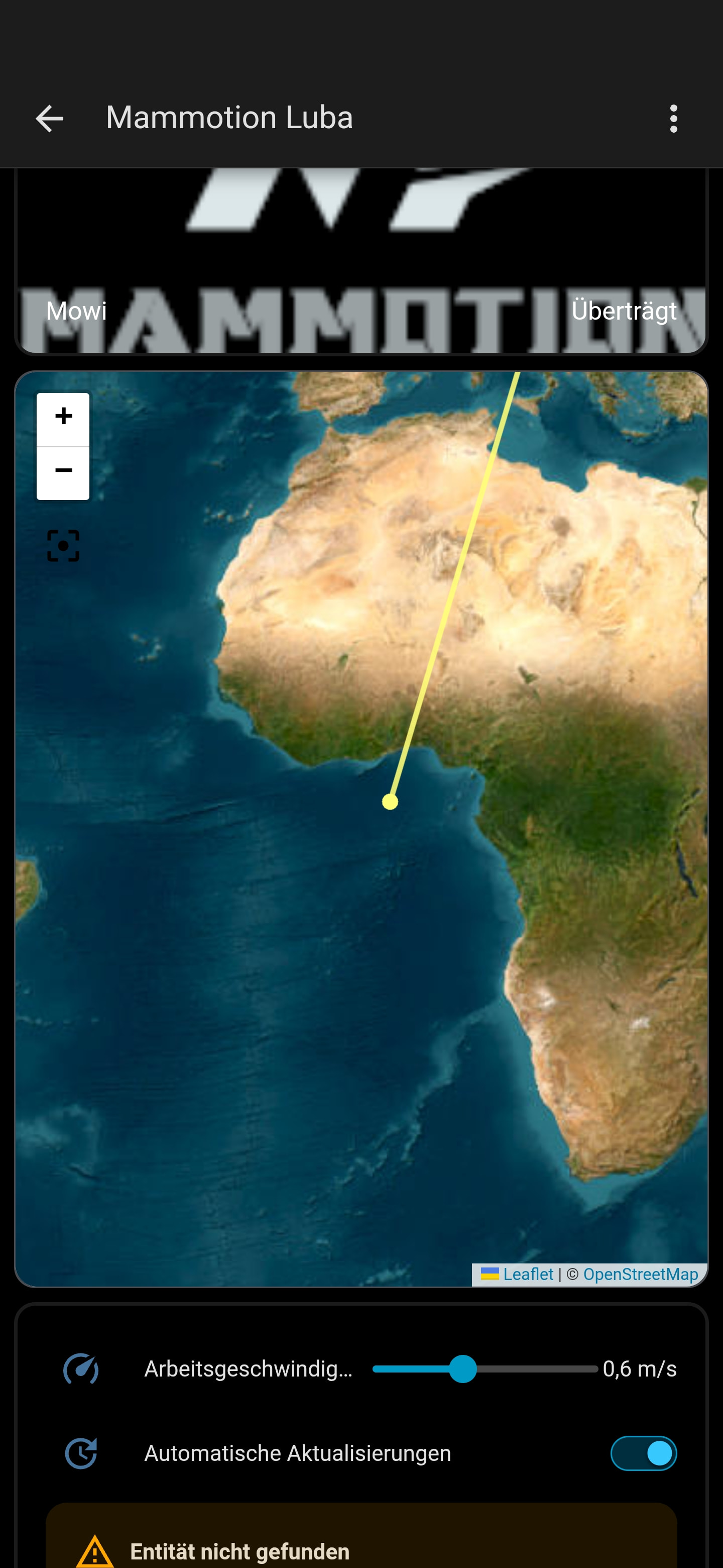

i have an Mammotion Luba Mini 2 an in my map the mower is often outside from europe and not at home. Any ideas wy?
Best regards
Michael

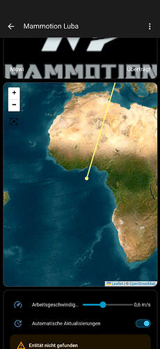

Best regards
Michael
That would be latitude 0, longitude 0. So it is failing to get the gps location and reporting 0,0 instead of unknown or unavailable. That should be reported as a bug to the integration owner.
Press sync RTK and Dock, sometimes though the mowers can report 0,0 as the RTK position, open a github issue please or pm me on discord with your diagnostic
