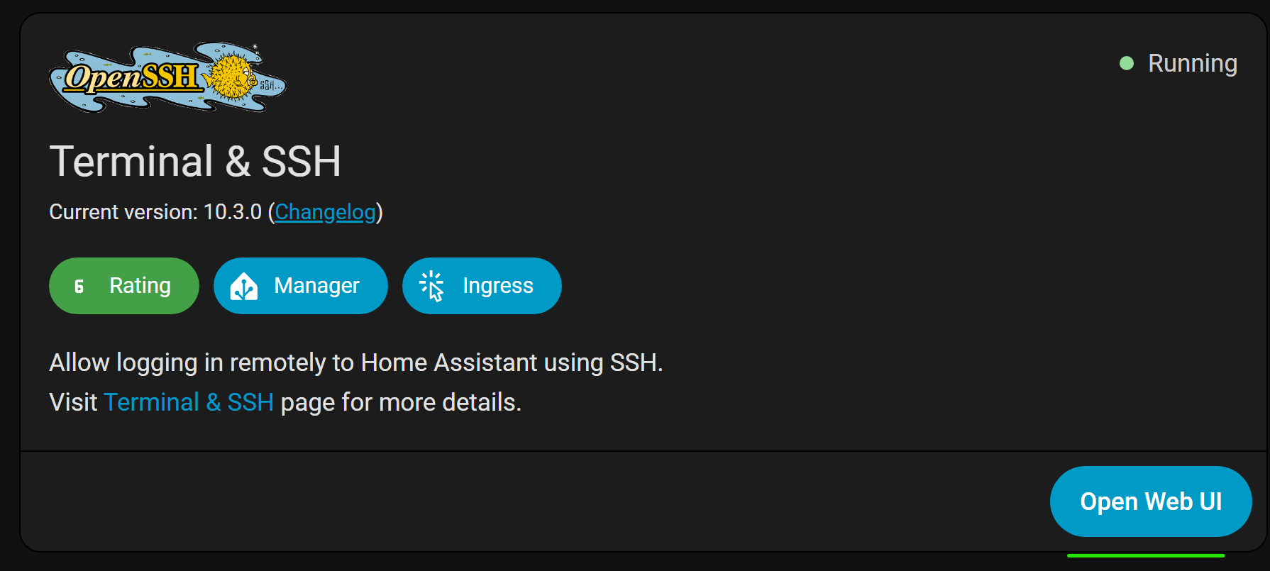

You could install a Terminal & SSH app and identify which system folders/files contain the most data.
I am providing an example using one of the default store apps. The commands below can be used directly from HA using the Open Web UI button in this app.

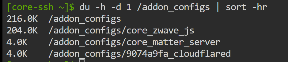

If a folder’s data size seems excessive, narrow it down with something like this
du -h -d 1 /addon-configs | sort -hr
