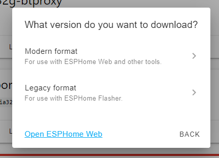

Manual install- what's different from Legacy and Modern format?
I’ve compiled both and the difference is a single byte. So what is"modern" in the modern format, and when/why would I use it?
I think it explains it in the popup where you choose one or the other.
Only use legacy if you are using the ESPHome flash tool.
It doesn’t explain the difference- just which to use. I tried a couple of other comparisons and there is only one byte different from Legacy to Modern.

Legacy and Modern format are different.
Modern format erase everything before flash, including the NVS, while legacy format maintain the NVS and make sure it’s not altered during flash.
Usually, developers save important data in NVS. For example, the authentication keys of the device. If it is erased, the corresponding devices need to be reset, which is a trouble for the developer.
So, legacy format download is important for the developers, but it is not important for the end users.
