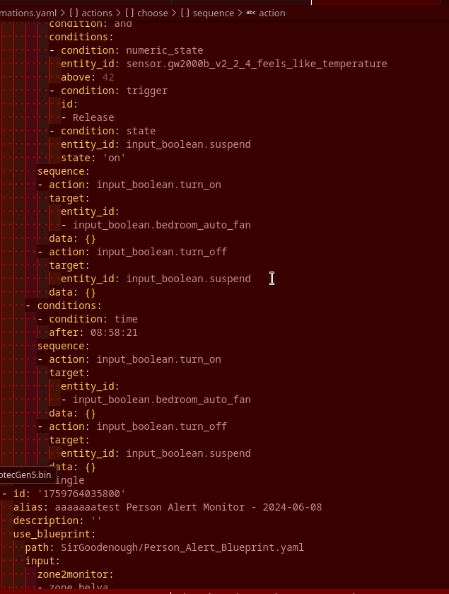

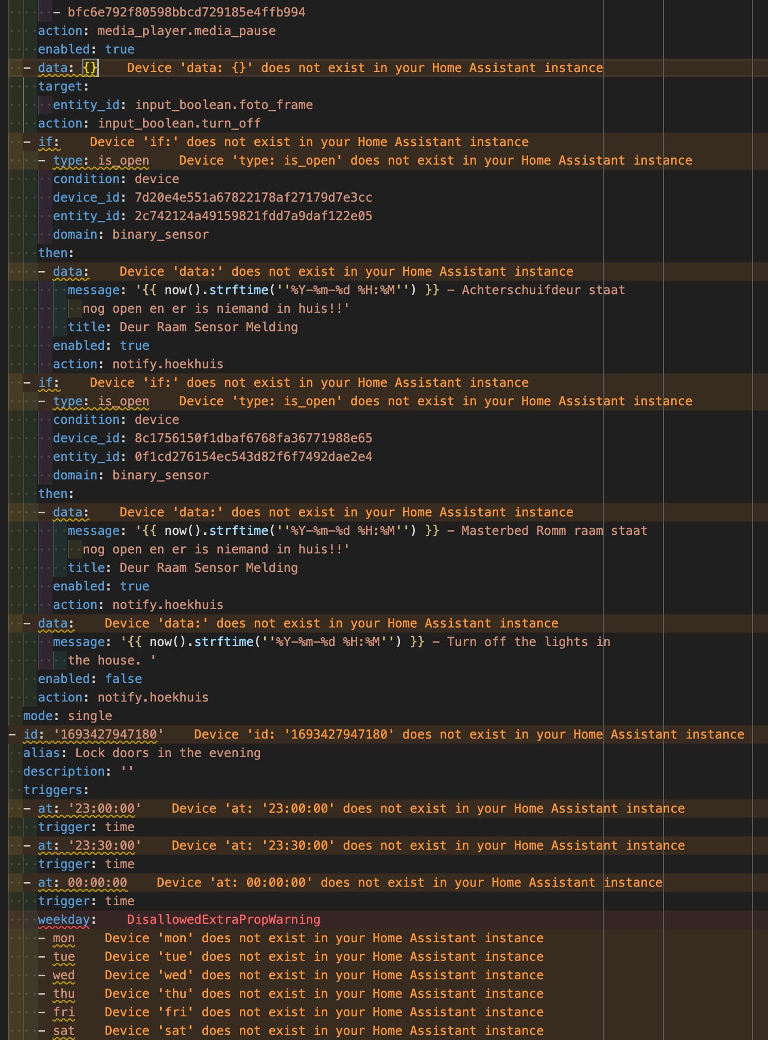

When I open my automations.yaml file with the Studio Code Server plugin in Home Assistant I see many many errors listed. But I don’t notice any problems when execution the different automations.
See screenshot. Any idea where this is originating from?
When I go into the automations configurations I don’t see those error messages.
It always does that. I think I read somewhere it is just way out of date or something. haven’t bothered using studio code for some time due to this.
The Home Assistant Helper VSCode extension is so out of date as to be useless. Disable it. See: patternWarning · Issue #1054 · hassio-addons/addon-vscode · GitHub

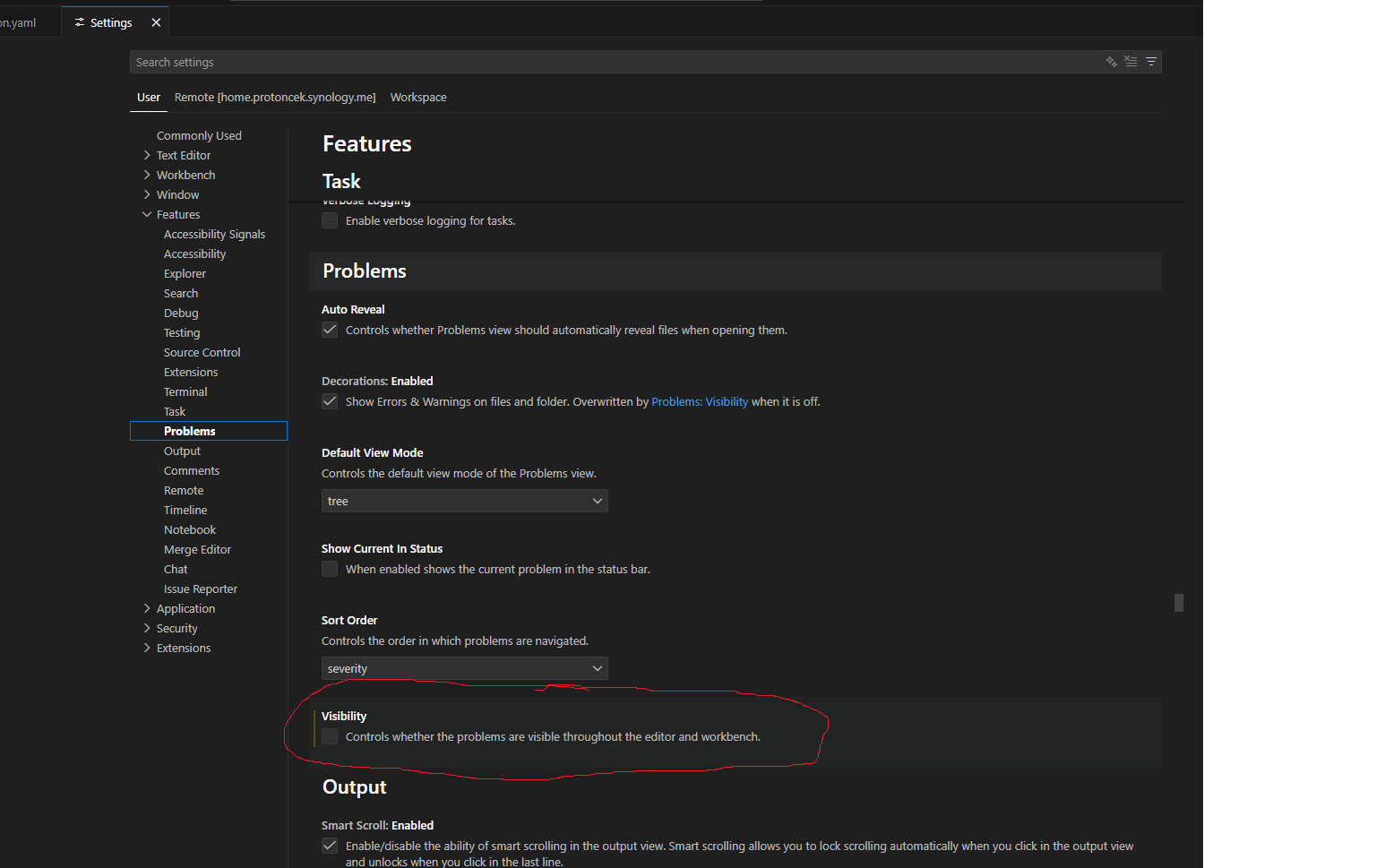

Disabling it makes coloring go away, so code becomes hard(er) to read. I disabled warnings instead:
settings, enter in search field:
@id:problems.visibility
and untick it.

@Protoncek : Tried to search for this config parameter: @id:problems.visibility but don’t understand exactly where to search. Can you explain where to add this config parameter?

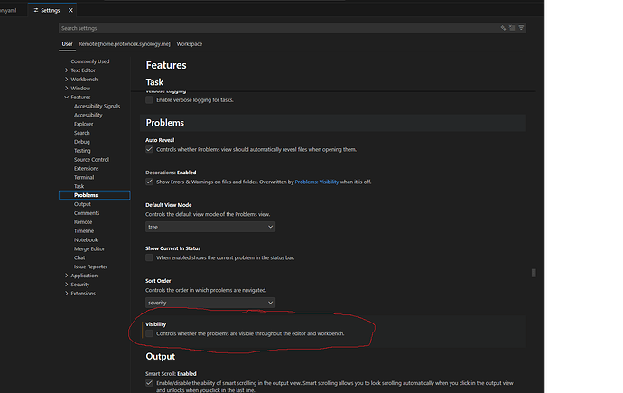

hm… do you have it here:
If not… then i guess i must added something in the past in VScode’s settings file… but god only knows what… anyone know where VSCode’s settings file is stored?

Excellent, found it. Thanks for the support.
Or just click on the extension and update it.
My code server seems fine with the version of Home Assistant Helper…
I had a problem and got a bunch of that stuff quite a while ago (months), and I spotted that HA Helper inside the App had an update, I updated it, and it’s been fine since.
I have Frenck’s Code Server App I’m working with.
