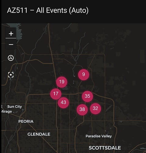

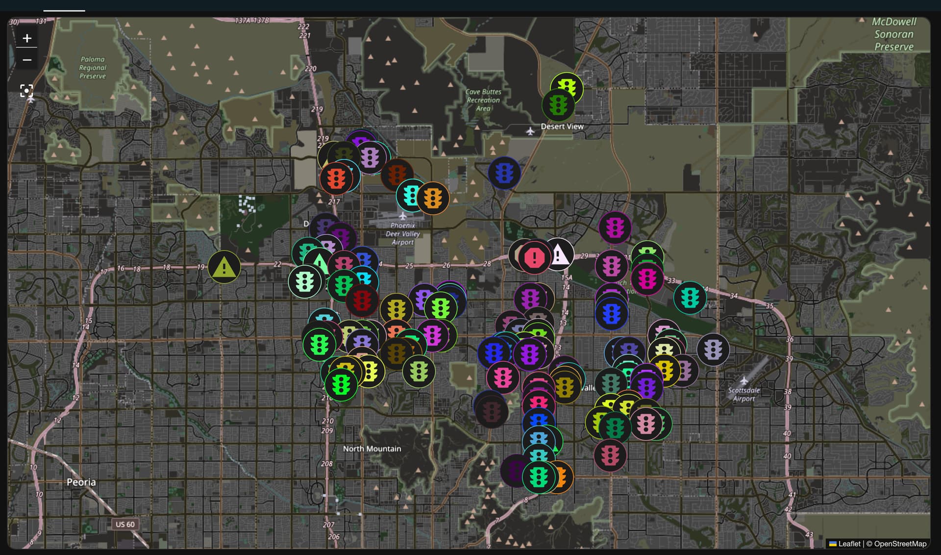

Question: can you “group” markers / display count before you zoom? (like the default map card)
I track roadwork / accidents, etc around me and displaying them on the map.
What I am struggling with is how to make it look less “cluttered”. Tried reducing the size of the icon but does not seem to work for me, so I was hoping to group them instead. Or any other suggestions are welcome :slight_smile:
This is how it looks currently:
type: custom:auto-entities
card:
  type: custom:map-card
  hours_to_show: 0
  default_zoom: 10
  card_size: 5
  display: icon
  circle: auto
  theme_mode: dark
filter:
  include:
    - options: {}
      domain: geo_location
      attributes:
        source: az511
grid_options:
  columns: full
  rows: 12

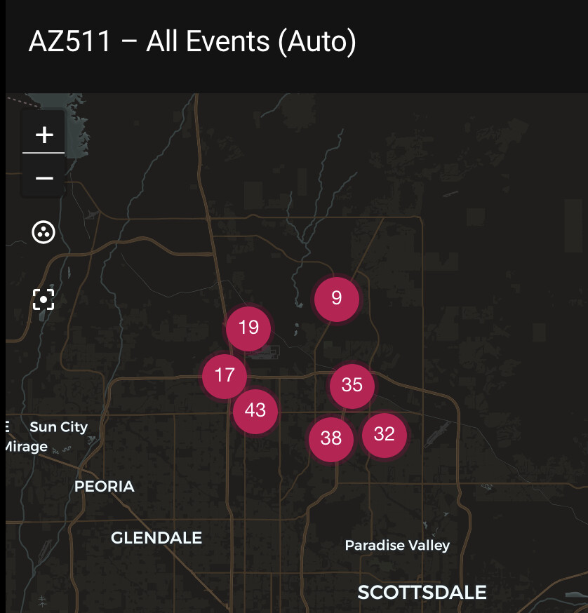

For reference, this is a screenshot with the default map card, to show what I mean by “grouping”:
Clustering is not supported in this custom card, it is a feature request which was already registered in GitHub repo.
