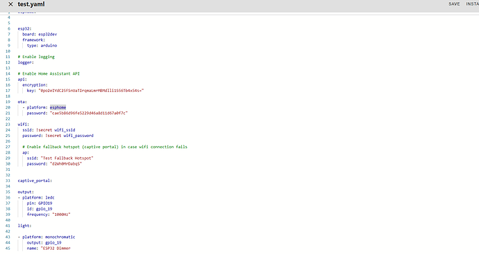

hello guys i have ESP32
im trying to install dimmer however i got this error
ERROR Error while reading config: Invalid YAML syntax:
mapping values are not allowed here
in “/config/esphome/test.yaml”, line 37, column 8
somthing to do with pin: GPIO19.
any help ?
the code is this
esphome:
  friendly_name: test
esp32:
  board: esp32dev
  framework:
    type: arduino
# Enable logging
logger:
# Enable Home Assistant API
api:
  encryption:
    key: "0po2eIYdC25FSnUaTIrqmaLmrMBMdlli1S56Tb4x54s="
ota:
  - platform: esphome
    password: "cae5b86d96fe5229d46a8d11d67a0f7c"
wifi:
  ssid: !secret wifi_ssid
  ap:
    ssid: "Test Fallback Hotspot"
    password: "d2Wh0MrDabqS"
captive_portal:
output:
- platform: ledc
    pin: GPIO19
    frequency: "1000Hz"
light:
- platform: monochromatic
    output: gpio_19

As Daryl says, please format YAML code correctly for the forum. Looking at your screenshot (which shouldn’t be needed with properly-formatted code), you’ve indented the lines under platform: ledc and platform: monochromatic, which is incorrect.
Indentation is critical in YAML. Take a look at the examples, and match those:
As Troon has pointed out, you have an indentation issue - should look like:

amazing thanks alot guys for the help working now
