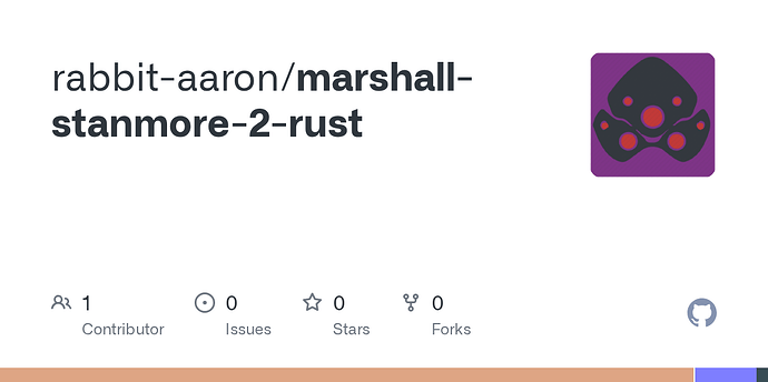

Thanks to Claude Code, I've converted this project to Rust, which means a lot less resource intensive compared to Python, and it added HA MQTT auto discovery, which means now it's zero config, once you get it working, it should just pop up in your HA under MQTT devices.
Follow the instruction in README.md for the simple deployment.

Hey people, I've release a rust port of the project, see the edit in the original post.
