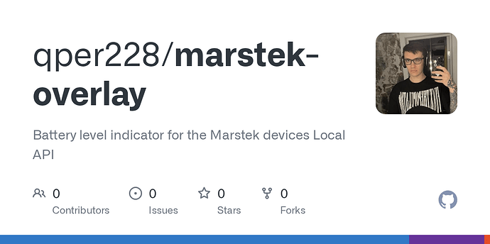

Hey guys did a small electron + react app for myself basically an overlay (using on Windows but you can do the Mac build from the source code) for my Marstek Venus-E device with a codex just by the quick hand maybe somebody will find it useful:
Email me or DM If you’ll need .exe file

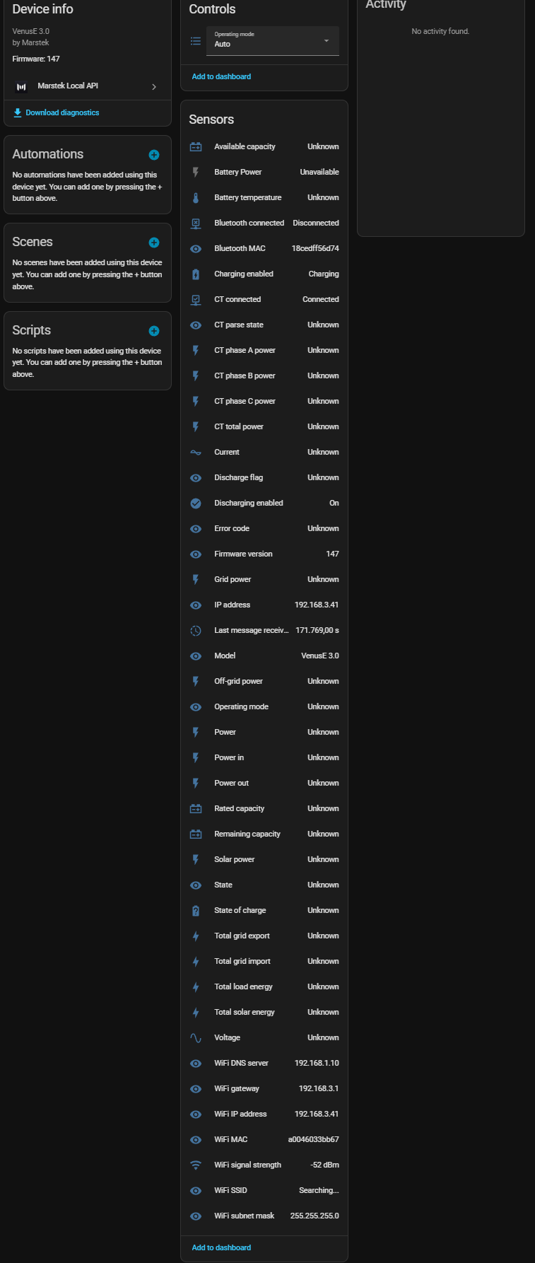

I have a Marstek Venus E 3, i can connect the device to this integration. But it does not allow for anny data to be shown. It worked for exactly 10 minutes, and then it was gone.
Am i doing something wrong?

Having the same issue. Worked for 10-30 minutes, but most data was not updating. And then it stopped working completely. Tried to delete the device and reinstall the integration. Now I can’t add it back to HA at all.
Update: It’s now working. I updated integration to v1.2.0.rc7. I also updated the firmware to v148 and rebooted the station.

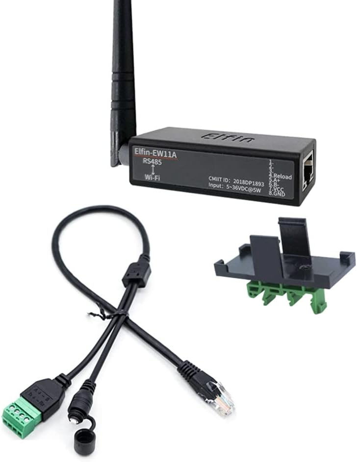

I’m using Modbus over Wifi with an EW11 and not the local API as i found it unstable. It just stopped working after some time.

I trid getting the data with the EW11 module.
The module is available, but no serial data is received.

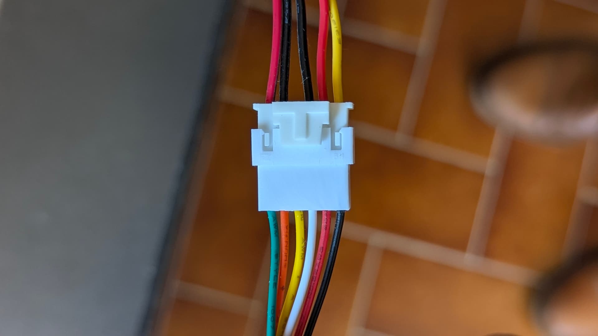

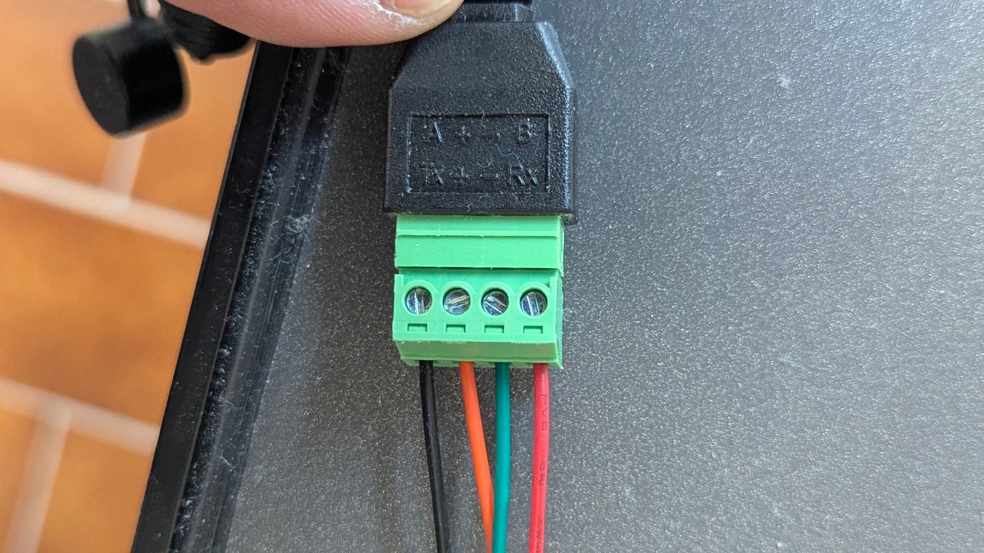

Did you connect RX/TX correctly. Try to switch the connections.
On the 1st photo the upper end points to the battery.
The yellow and white from the lower end are unconnected.
The colors don’t match because i used a premade assembly.
