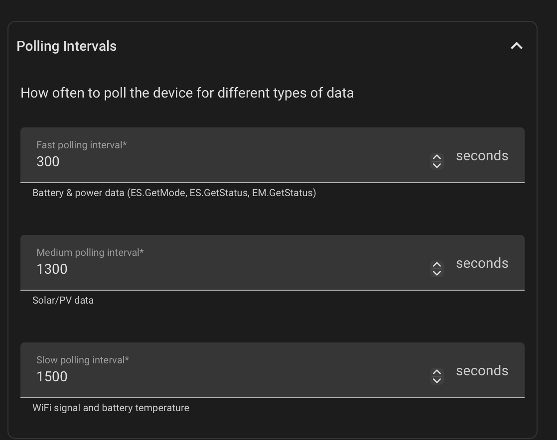

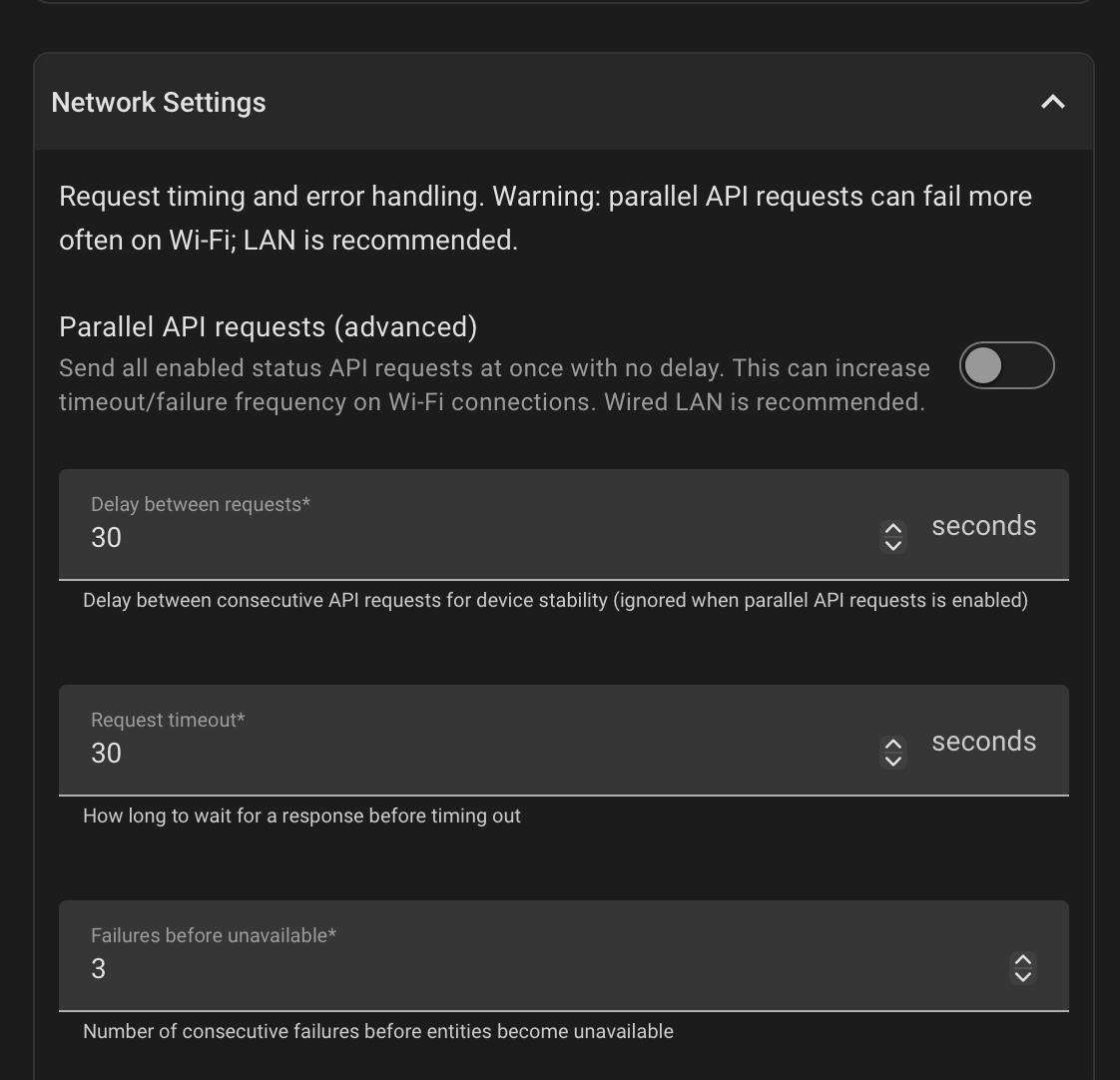

I'm currently testing with very low polling rates and it's been working so far for at least a week without a single reset (using WiFi with a very good signal strength).
Here are the settings I'm currently using:

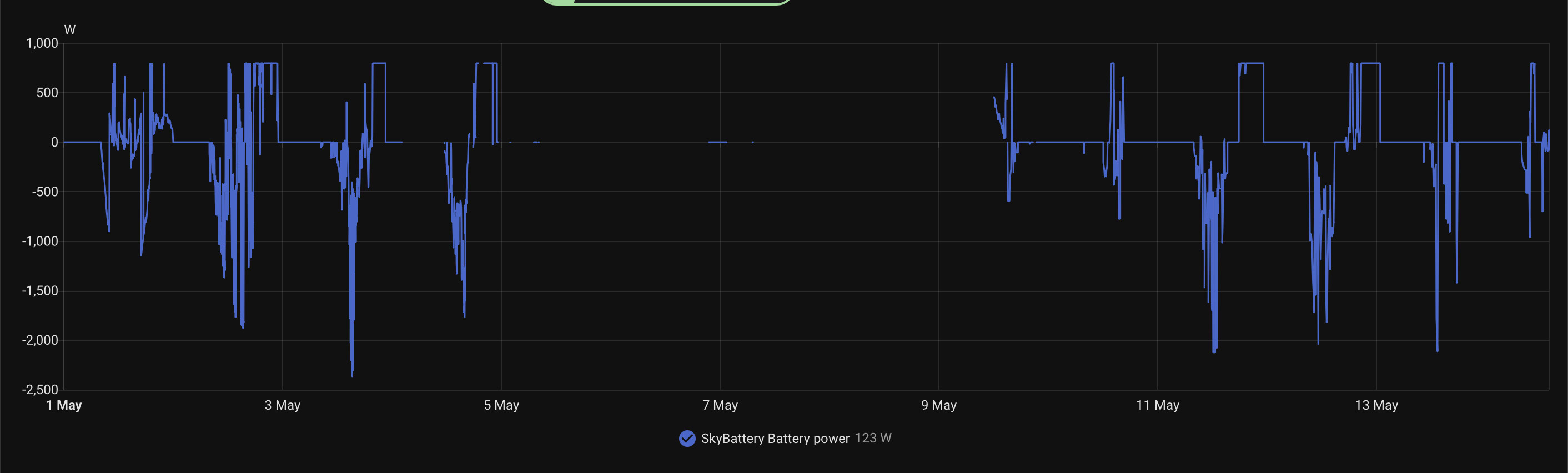

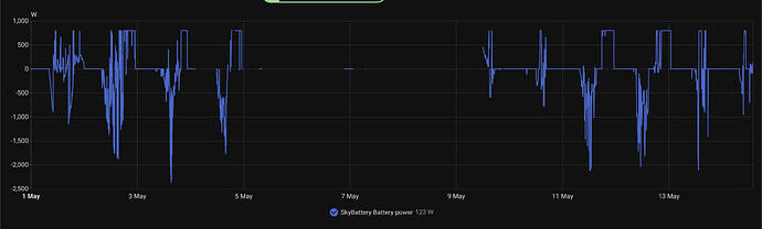

As you can see in the screenshot below the misery started around May 4th and I changed the polling to the settings above on the 9th:
So far so good! I have an automation that sends me a notification when the API connection is lost, so I can at least set the operation mode back to self-consumption in the Marstek app if the reset happens.
