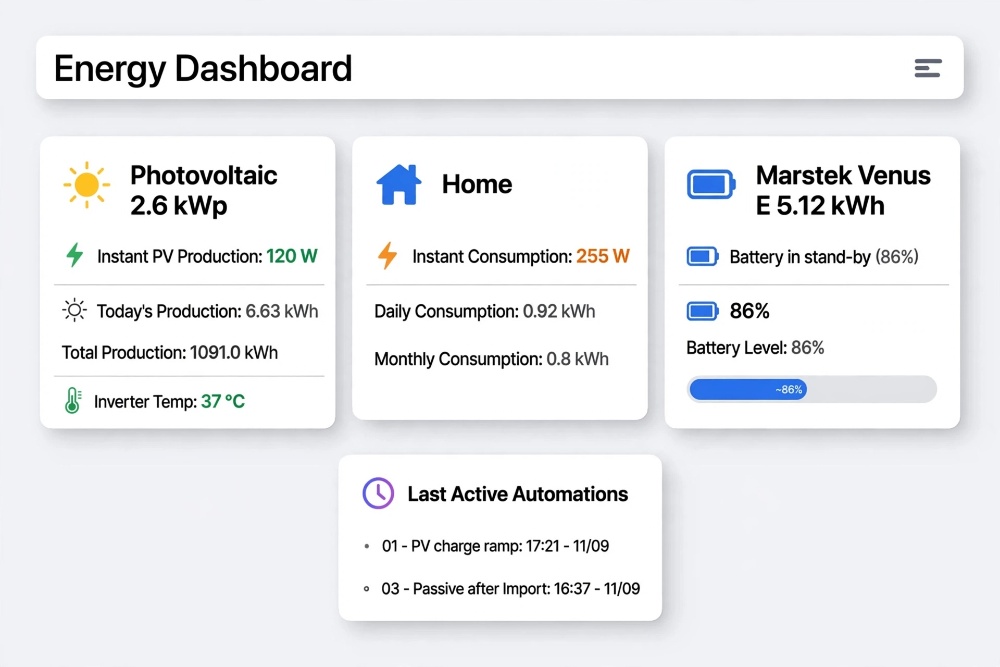

Dashboard Layout (venus.yaml)
Create a venus.yaml file in your configuration directory with the following layout for real-time monitoring:
YAML
title: Photovoltaic
icon: mdi:solar-power
views:
  - title: Home
    cards:
      - type: markdown
        content: >
          ## Energy System Overview
      - type: markdown
        content: >
          {% set pv = states('sensor.inverter_power')|float(0) %}
          {% set prod_oggi = states('sensor.inverter_today_production')|float(0) %}
          {% set prod_tot = states('sensor.inverter_total_production')|float(0) %}
          ## ☀️ PV Generation
          {% if pv > 100 %}
            ### <font color="#2ecc71">☀️ Instant PV: {{ pv|int }} W</font>
          {% elif pv > 0 %}
            ### <font color="#e67e22">⛅ Instant PV: {{ pv|int }} W</font>
          {% else %}
            ### <font color="#e74c3c">🌙 Instant PV: 0 W</font>
          {% endif %}
          #### ⚡ Today Production: {{ prod_oggi }} kWh
          #### 📈 Total Production: {{ prod_tot }} kWh
          {% set temp = states('sensor.inverter_inverter_module_temperature')|float(0) %}
          {% if temp < 40 %}
            ### <font color="#2ecc71">🌡️ Inverter Temp: {{ temp|int }} °C</font>
          {% elif temp <= 50 %}
            ### <font color="#e67e22">🌡️ Inverter Temp: {{ temp|int }} °C</font>
          {% else %}
            ### <font color="#e74c3c">🔥 Inverter Temp: {{ temp|int }} °C</font>
          {% endif %}
      - type: markdown
        content: >
          ## 🏠 Home Load
          {% set power_grid = states('sensor.grid_power_import')|float(0) %}
          {% if power_grid < 50 %}
            ### <font color="#2ecc71">⚡ Grid Import: {{ power_grid|int }} W</font>
          {% elif power_grid <= 500 %}
            ### <font color="#e67e22">⚡ Grid Import: {{ power_grid|int }} W</font>
          {% else %}
            ### <font color="#e74c3c">⚡ Grid Import: {{ power_grid|int }} W</font>
          {% endif %}
          ### 📊 Daily Consumption: {{ states('sensor.daily_home_energy_consumption') | float(0) | round(2) }} kWh
          ### 📅 Monthly Consumption: {{ states('sensor.monthly_home_energy_consumption') | float(0) | round(1) }} kWh
      - type: markdown
        content: >
          ## 🔋 Marstek Venus E 5,12 kWh
          {% set soc = states('sensor.venus_e_3_0_battery_level')|float(0) %}
          {% set p = states('sensor.venus_e_3_0_battery_power')|float(0) %}
          {% set cap = 5120 %}
          {% if p < -10 %}
            ### <font color="#2ecc71">⚡ Charging: {{ p|abs|int }} W</font>
            {% set rimanente = cap * (100 - soc) / 100 %}
            {% set ore = (rimanente / p|abs) if p|abs > 0 else 0 %}
            #### ⏳ Time to 100%: {{ ore|int }}h {{( (ore - ore|int)*60 )|int }}m
          {% elif p > 10 %}
            ### <font color="#f1c40f">🔌 Discharging: {{ p|int }} W</font>
            {% set rimanente = cap * (soc - 12) / 100 %}
            {% set ore = (rimanente / p) if p > 0 else 0 %}
            #### ⏳ Remaining to 12%: {{ ore|int }}h {{( (ore - ore|int)*60 )|int }}m
          {% else %}
            ### ⏸️ Standby ({{ soc|int }}%)
          {% endif %}
          #### ⚡ Battery Level: {{ soc|int }}%
      - type: markdown
        content: >
          ## 🕒 Recent Triggered Automations
          {% set ns = namespace(ults=[]) %}
          {% for aut in states.automation %}
            {% if aut.attributes.last_triggered is defined and aut.attributes.last_triggered != none %}
              {% set ns.ults = ns.ults + [(aut.attributes.last_triggered, aut.name)] %}
            {% endif %}
          {% endfor %}
          {% set sorted_auts = ns.ults | sort(reverse=true) %}
          {% for time, name in sorted_auts[:2] %}
            - **{{ name }}**: {{ as_timestamp(time) | timestamp_custom('%H:%M - %d/%m') }}
          {% endfor %}

Here is a quick preview of how the dashboard looks in action once everything is set up:
