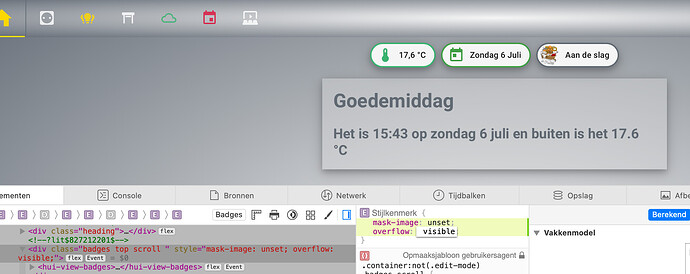

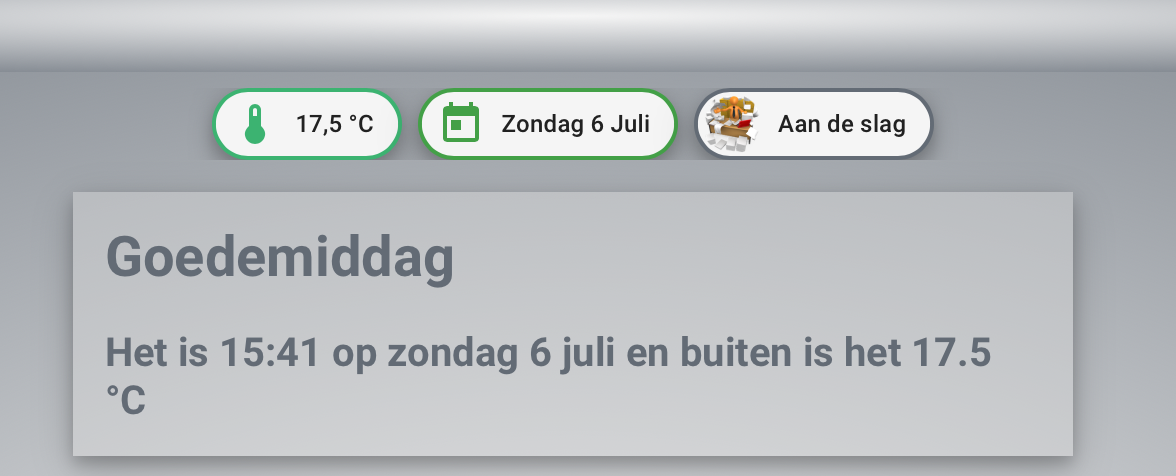

would this be related… setting badges_wrap to a view badge (with box-shadows) causes horizontal line//border of the section below · Issue #25691 · home-assistant/frontend · GitHub
I’ve logged in Frontend, but it was closed because I use card-mod…
Even though the issue lies in Core frontend imho. there’s an immediate response to shut issues down with a single mention of custom
would be great if (for the time being this being recognized as core bug) we could set a card-mod on the badges to not have that sharp cut-off. Or on the section itself.
Ive found this to make it less visible
  card-mod-view-yaml: |
    :first-child $:
      hui-view-header:
          hui-view-badges $: |
            .badges {
              padding-bottom: 16px;
but, it also creates a big gap (of course…) so it is not nice either
if I do this:
    :first-child $:
      hui-view-header:
            .badges {
              mask-image: unset !important;
              overflow: visible !important;
as you say, it does not work,
setting the same in Inspector does make it as one would hope:
(sorry for this off-topic in Material you theme. You are the first however to find this exact problem I noticed, and find a fix. Hope you can help me sort it out in my card-mod theme)
wait, its the wrong path:
    :first-child $:
      hui-view-header:
          .badges {
seems to be the correct, but has unwanted effect of not scrolling but overflowing … :wink:

That’s exactly it. It’s a shame that they’ve marked it as not planned since it is an issue with the design of scrolling badges not accounting for box shadows in custom themes. I’ll look into adding some style fixes within the companion module and sharing it with you if they do not fix it within the HA frontend.
