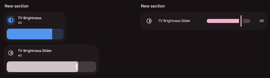

I’m curious if it’s possible to manually change the style of sliders. I have a few different types of sliders here (mushroom, tile, and entity card) and I can’t seem to get the right-most slider to appear with the dots/gradations as appears in the contrast settings of your own plugin (Pictured at the bottom)
Is there any way to enable this manually? Thanks!

The slider tick marks not being present in the entity row slider are a Home Assistant design decision, one that I can’t easily get around. The slider has a property called ticks, which when set to true renders the tick marks. This can be set with JavaScript but I don’t see a good way to implement that in your frontend.
Huge shame! I figured it’d be something like that. Thanks again for looking into it and putting so much effort into this amazing theme!

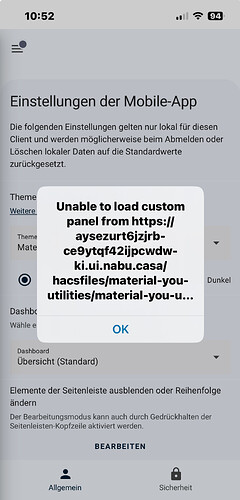

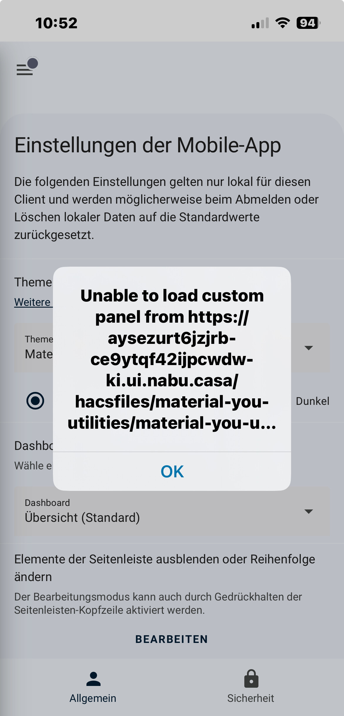

Hello Nerwyn,
i have made the Installation of the Material you Utilities, but when i want to start it i get this error message on my iPhone. What do i wrong?
90% of time when people report an issue like this it’s a caching issue. Does this issue occur if you connect to Home Assistant locally through it’s IP address or http://homeassistant.local:8123? Is it possible to clear cache via Nabu Casa? I use Cloudflare and some users had caching issues using it as well.
Okay, but do you have a solution for this problem?

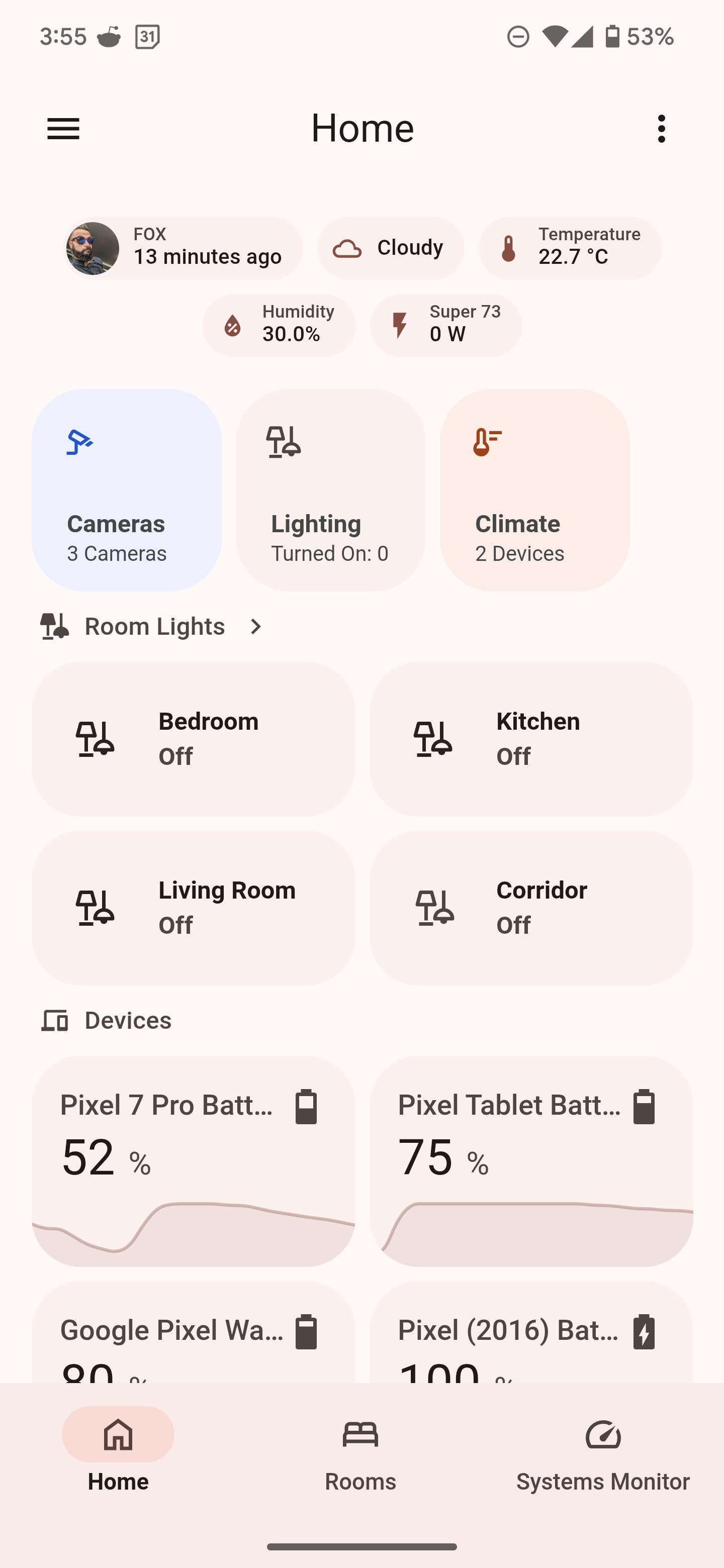

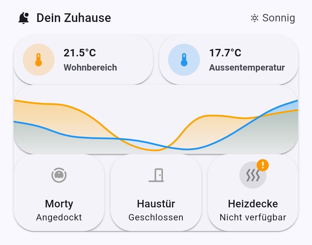

Great mod. Really enjoy it, thank you very very much. Unfortunately since last update my widget looks like this. Is it supposed to look like this?
The shadows weren’t there before and It looked more like one card.
Clear app and browser cache. Make sure the URL you added to configuration.yaml is correct. See if the issue also happens on a desktop browser.
Yup. The MD3 spec has a box shadow on cards, which was missing from previous versions of this theme. The theme README has instructions on how to use alternate card variants using frontend resource stylesheets.
