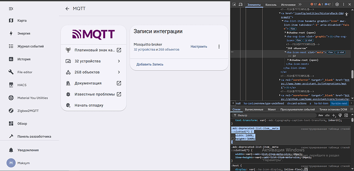

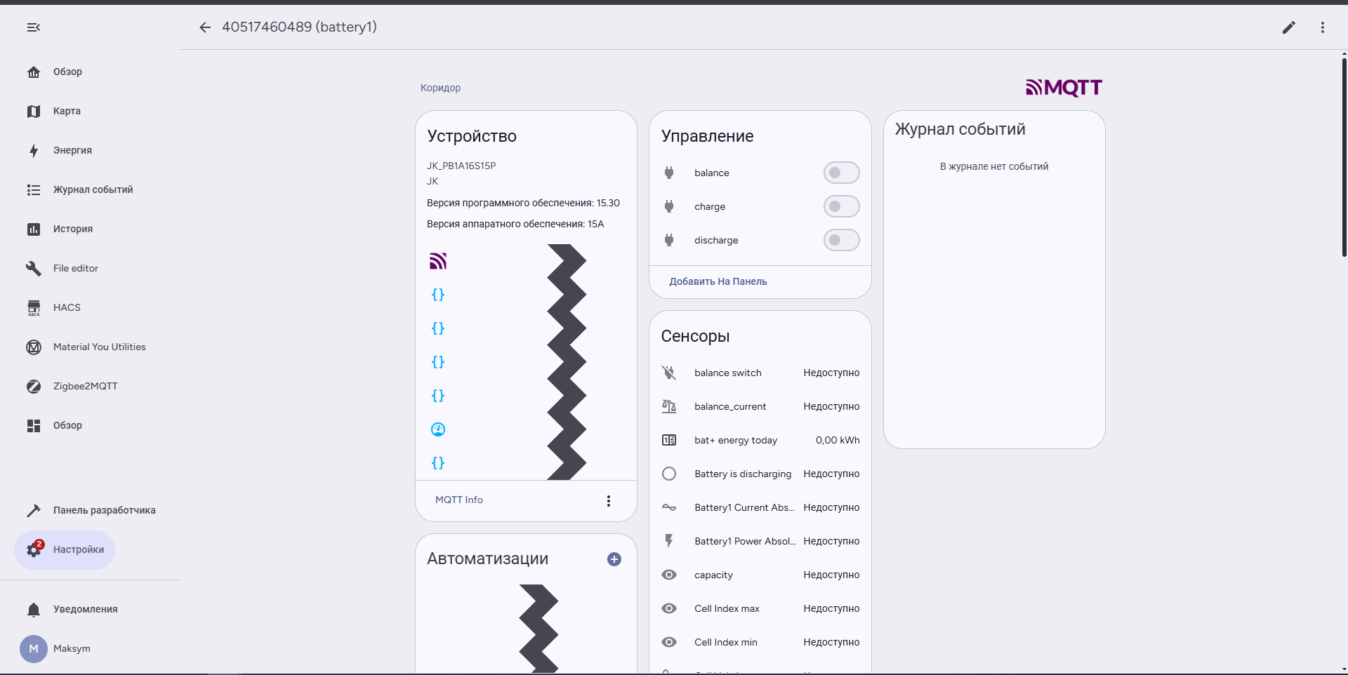

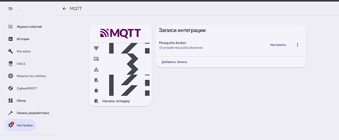

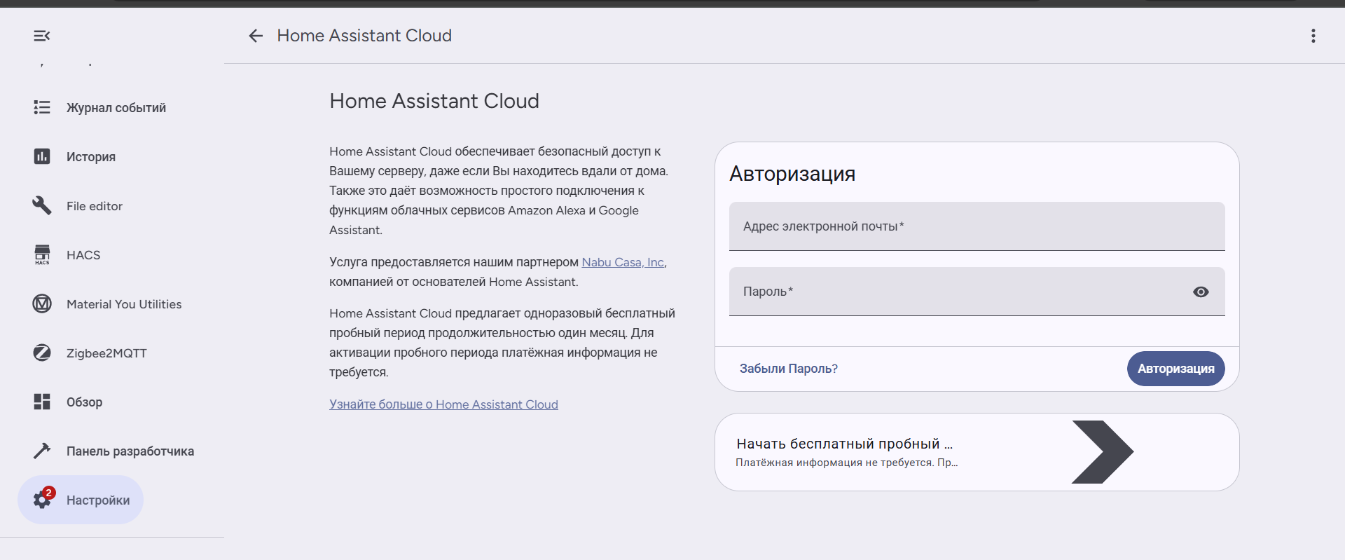

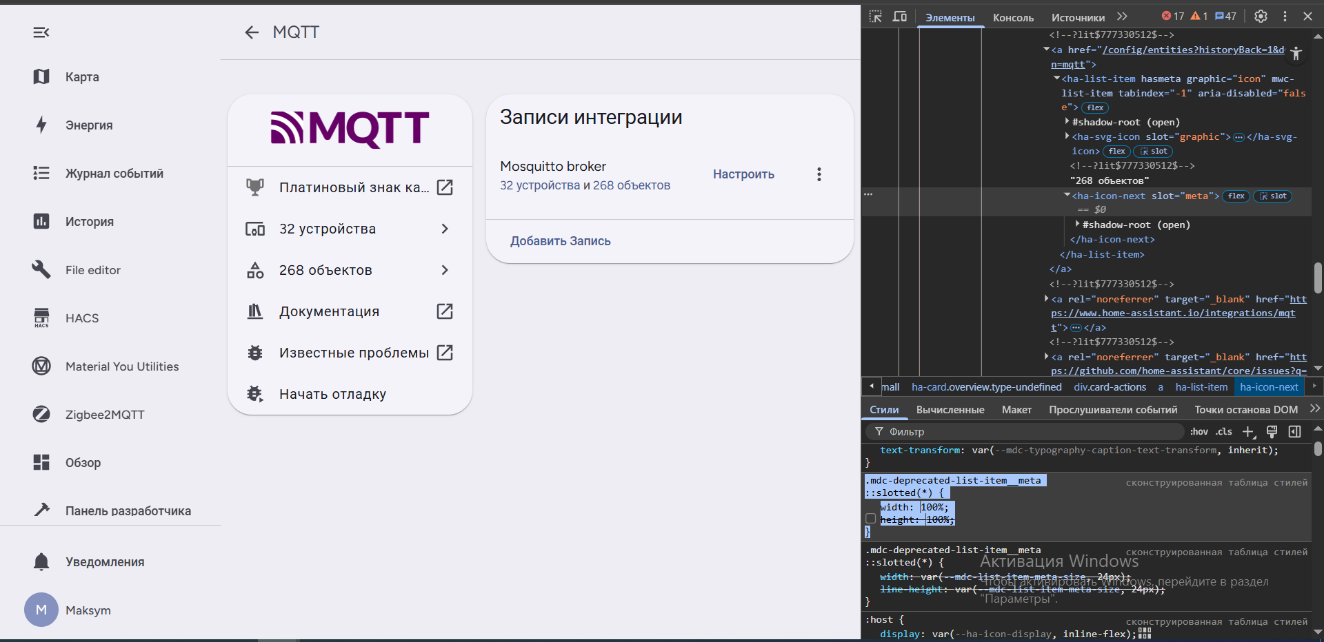

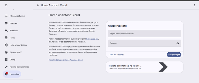

With the latest beta update I noticed that in many places the icons have become very large. On the phone it is exactly the same.
I am using Theme 5.0.0-beta.006 and Utilities 2.0.0-beta.039
Clear your cache and reinstall the latest beta. I introduced this bug when fixing material-you-utilities#25 in beta 34 but it should have been fixed in beta 36.
