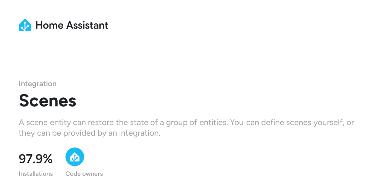

But to make all this obsolete: look into dynamically created scenes (scenes on the fly) to restore the state of any entity to what is was at some point:
That also returns to null on saving.
I already have it restoring OriginalVolume at the end of the movie. I have a different automation that adjusts the volume on a per-movie basis, and I want to store the adjustment I made so I can plug it into that automation later.
