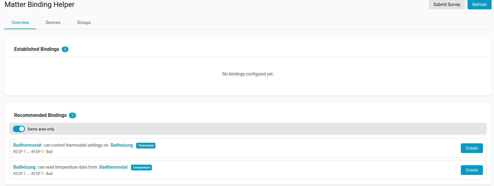

I am still setting up while renovating and currently I have 3 matter over threads devices all in the same room (bathroom). These are all Eve devices, a window sensor, a room thermostat and the radiator thermostat. As it seems I can’t (yet?) get matter binding going natively, I have installed the Matter Binding Helper integration through HACS.
The integration proposes/recommends a few automations, one (window open, turn heat off) worked from the get-go. It also recommends 2 more bindings, 1) for the radiator thermostat to read the temperature from the temperature sensor in the room thermostat and 2) for the room thermostat to control the radiator thermostat.
Creating these results in a failure message:
Failed to provision ACL: ACL write partially failed: 1 entries rejected
Any ideas how to resolve this?

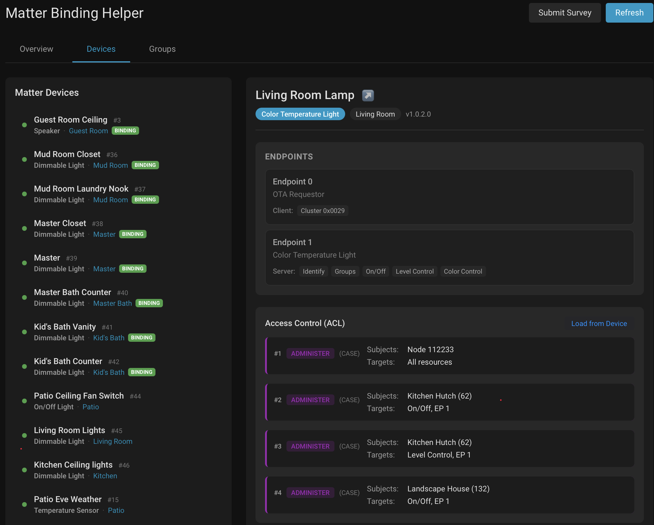

Any chance you added Bindings to this device in the past when the Python matter server first made that a possibility?
The first iteration binding support in Python matter server had a bug (later fixed) that would not delete the ACL, so they are, for the moment, left orphaned and taking up space. An end device runs out of ACL write storage space relatively quickly. I have an Aqara T2 bulb that can not add any new bindings. No fix yet, the Matter-JS server beta dev is hoping to get the Matter binding helper dev to collaborate and add his code to upcoming matter server release. He hopes to address deleting those orphaned ACL then.

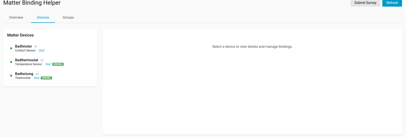

You can check for orphaned ACL with Matter Binding helper/Devices
Thanks for your response.
No, at least not that I think. This is pretty new overall, these are the first and so far only 3 matter (over threads) devices and I have only had them paired to HA for a couple of days. I have another matter (over wifi) device in a different room. Orphaned ACLs had come up in my searches trying to figure this out.
I do see the binding tag on the second image but anything I did with this I pretty much did in the last 2 days but always giving me the same error message.
