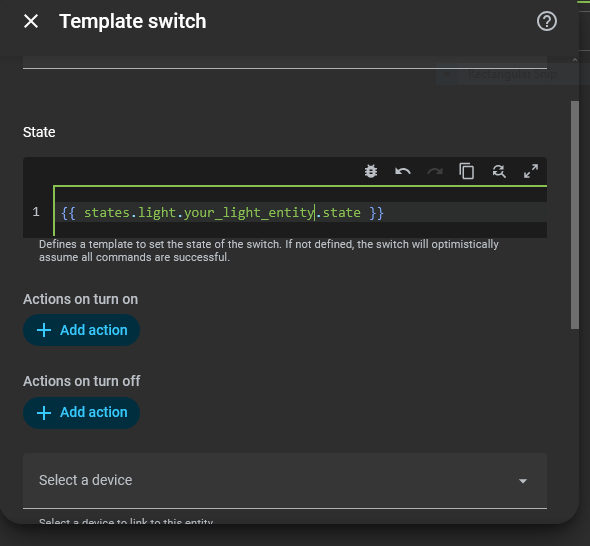

To “Show as Switch” You create a Template-Helper > Template-Switch
When done, You Click visibility on your “Light-Entity” and choose Hide ( It will show under the new Switch, and you can actually “reference” Both Entities
Whether Your Power/Energy entities will show, i can’t tell for Your Device, My Aqara Shows W & kWh
I guess so
Example:
{{ states.light.Your_light_entity.state }}
In Actions your obvious Point to your light entity ( Turn on/off light ) ( which you then can hide )
