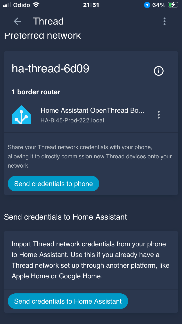

In the HA – Config – Thread, I see a Preferred network ha-thread-6d09, Home Assistant OpenThred border Router #4CC9 (with the credentials icon).
And clicking the 3-dots, the “Used for Android + iOS credentials” is greyed out.

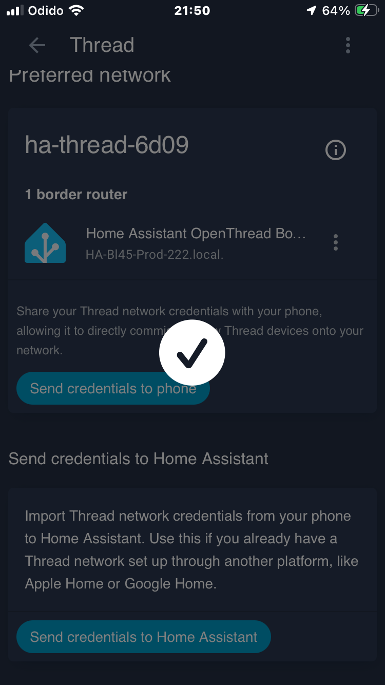

Further on my iPhone (iOS version 26.3.1) in the HA App Settings – Thread, I see the same Border router specified.
It has the button “Send credentials to phone”. When i click this button I get the V-singn that it is done. (Initially I clicked that button to receive these credentials) (But the butten remains there…)
I see 2 other Thread-networks, but they are NOT Preferred and have NO border router.

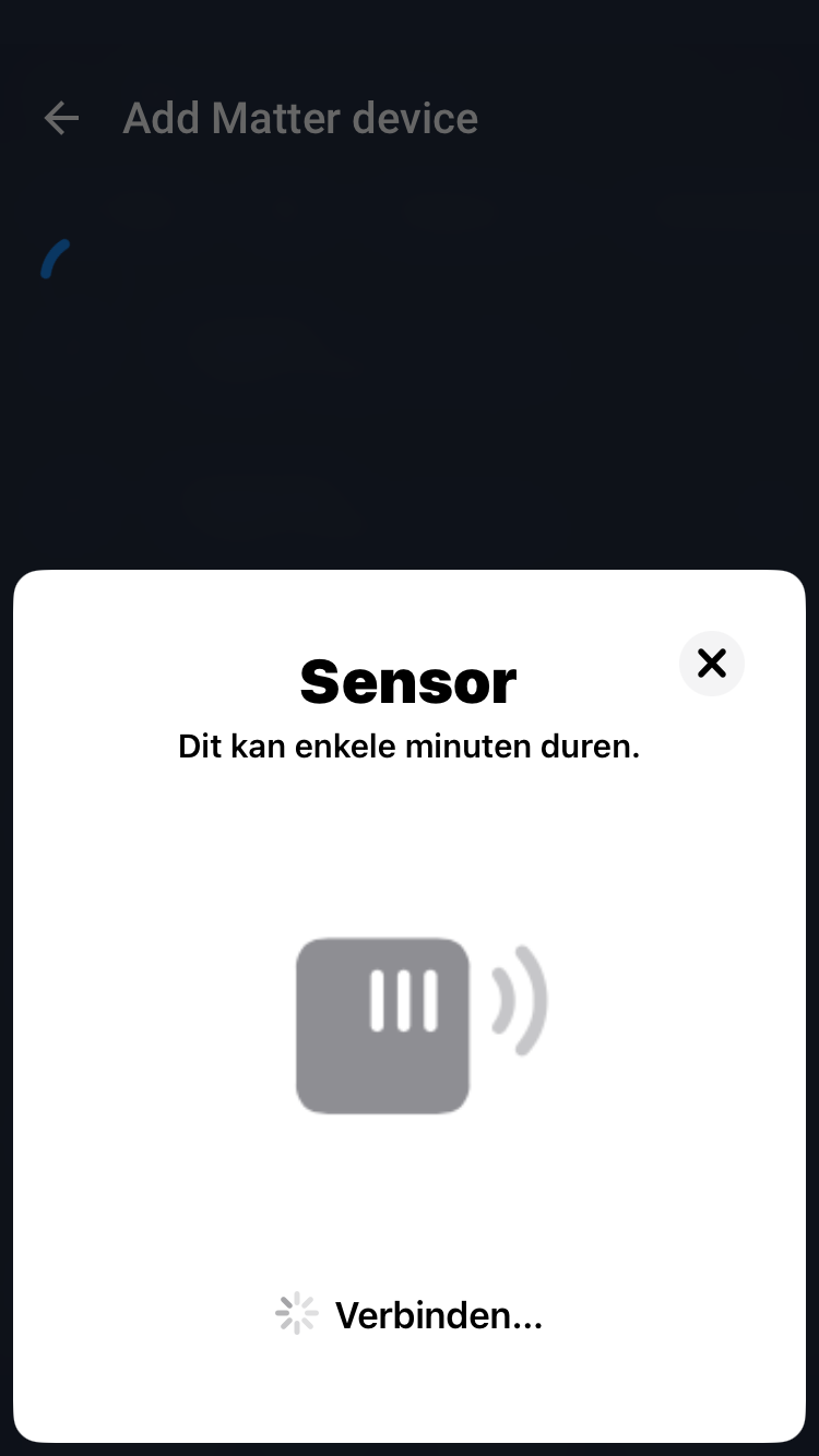

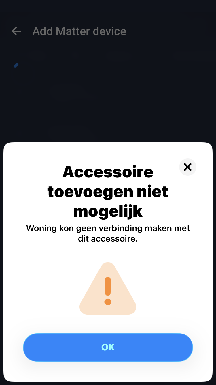

I thought this all looks good, so I try to add some Matter devices. But with each device I get: Accessoire toevoegen niet mogelijk. (Unable to add device).

This sort of indicates to me that these two networks were at one time Thread networks from HA OTBR, but do not exist anymore. It may be that when these networks did exist and you sent the credentials to the iPhone, that the iPhone stored the credentials of these now non-existing Thread networks, but the credentials are still stuck on the iPhone. This maybe why its failing.
In the phone using HA companion App, goto (something like) UI→Settings→Companion App→Debug→Thread. You should see credentials there. You should probably tap and slide to the left to expose the trash can and delete them, and try to redo the “send credentials to the phone”.

Hi @wmaker and @DocMarc73 , Thank you for helping me.
First i try to delete the two stall Thread networks in my iPhone as @wmaker proposed. They are left overs from an earlier attempt to get Thread working with an SMLight SZML-06M…
And the other is probably from my Google Home device (NEST-PAN-1F6D) it’s the only Google device i still have. I was not aware that this device supported Thread, its not a display device.
As with the first one, i was able to delete, but the NEST… one did not delete. Even when I switched OFF the device, the credential were not deleted…
I do have an other old iphone with which I could try it. There are not yer Thread credentials on this one.
@DocMarc73 Yes indeed the IPv6 setting to automatic, I already did that, but the command in the terminal, i did not yet done. So now I did.
In my HA instance on the NUC there is only one (Prefered) Thread network:
And on this other iPhone, there was not yet any Thread credentials added to the iOS-keychain.
So the ha-thread-6d09 (same as in HS server) showed up. And I did ‘Send credentials to phone’.

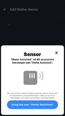

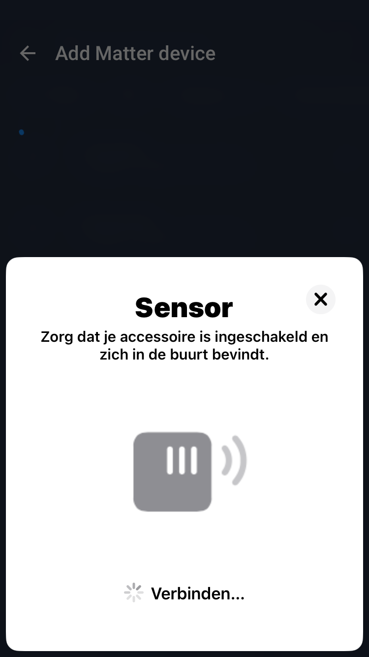

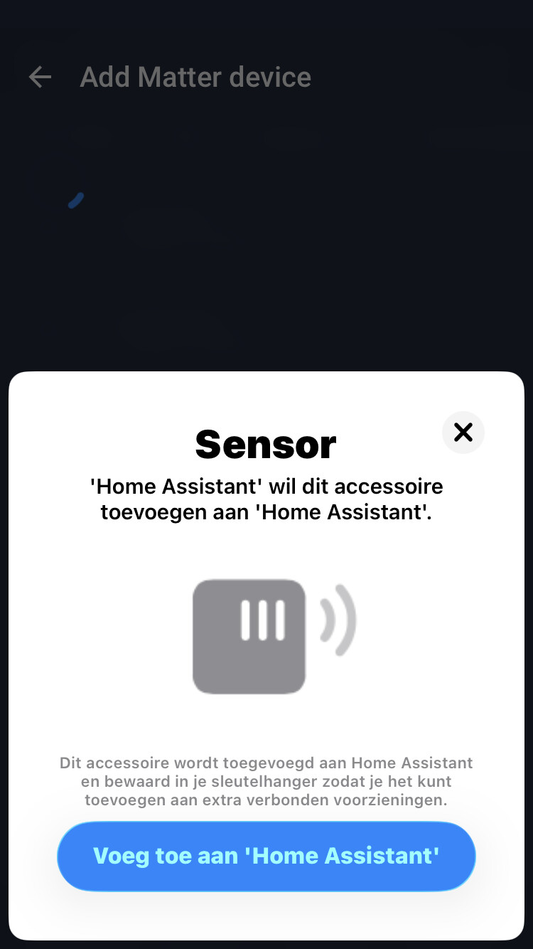

Now I try to add a Matter device:
It seems that there are lots of peaple who are haveng problems with multiple Thread credentiols in iOS: Can't add Matter device - iOS - multiple Thread credentials in Companion app. Can't select one to be used or delete obsolate ones · Issue #125444 · home-assistant/core · GitHub
I am sorry, but i’m out off ideas…
