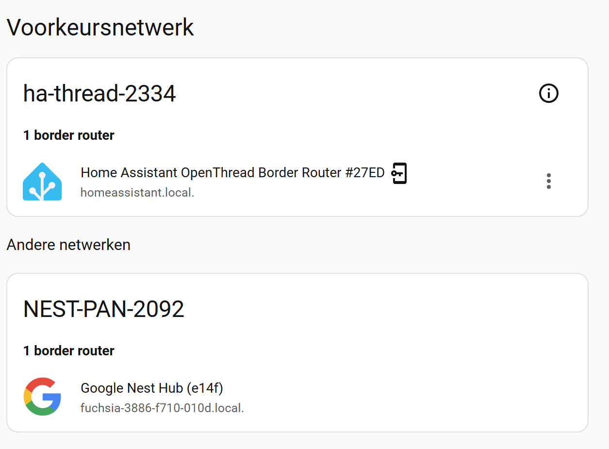

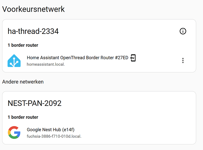

In homeassistant: added thread, matter, openborder router
Openborder router is started, network is running. When i look at the thread configuration, there is a small icon with a key next to the border router info
He also finds the other router on the Google Nest hub 2.
It looked to me that everything is ok…

connecting to thread network ha-thread-2334 (the network displayed in HA)
Then: cannot connect to network.
I tried this on my android phone, ipad and even on a brand new installed android phone, so the android cache and data should not be a problem.

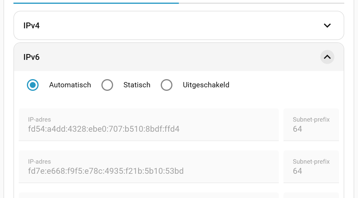

My HA server has an ipv6 address

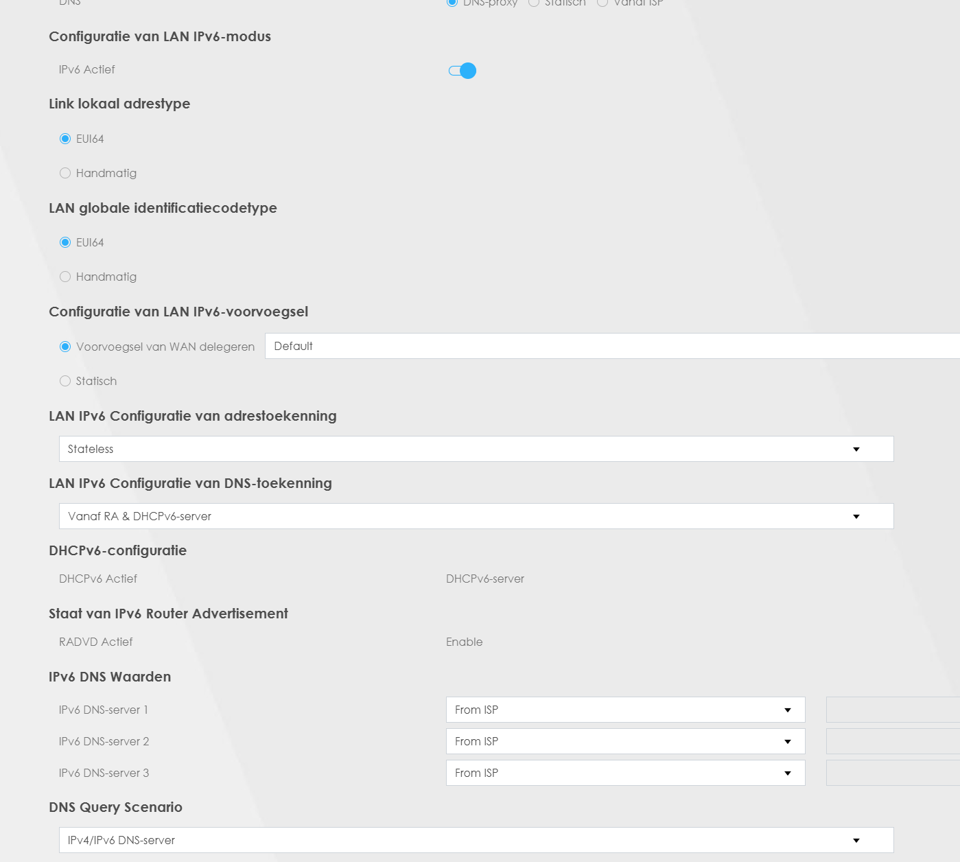

My Odido Zyxel VMG8825-T50 router has ipv6 running, although Odido does not provide ipv6 outside. The router has the following settings for ipv6:

Sure. Multiple times, deleted data, removed the app entirely and reinstalled. And also used a complete new and empty android smartphone. When trying to connect the app failes at the point that it says “connecting to thread network ha-thread-2334”, which is the correct network.

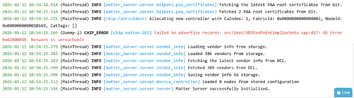

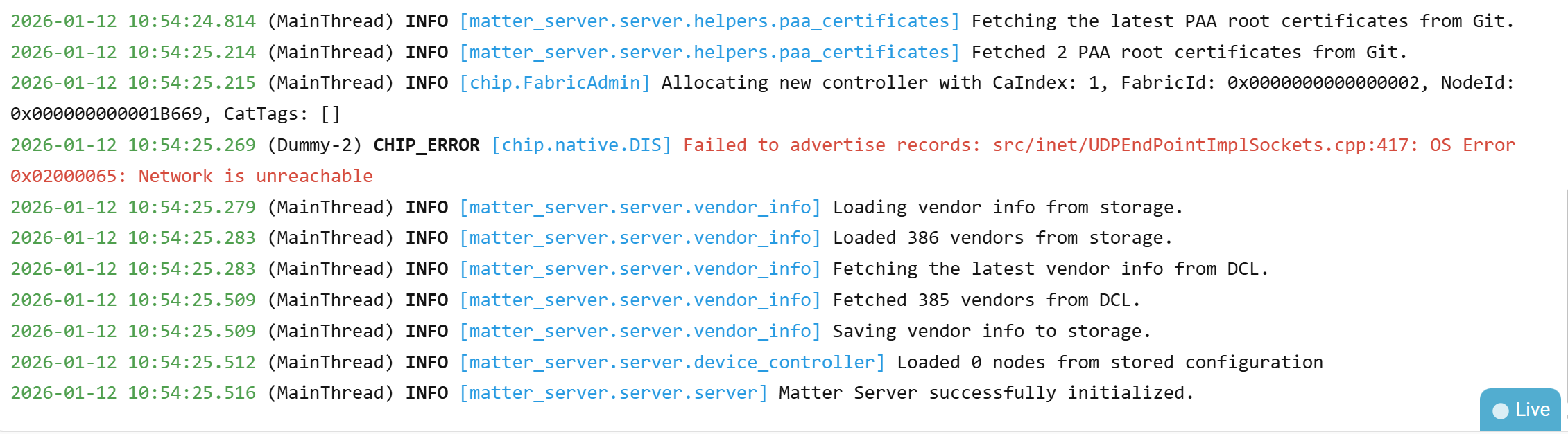

In the Matter log i find this error. But this is at startup, during trying to add a matter device there is no additional logging.
Also enabled the thread border router logging. Als no additional lines when trying to add a device via de app.

Something that got me when initially setting up Matter was I had IPv6 disabled on my local machine that runs Home Assistant. I have a Debian system running Supervised and the machine itself wouldn’t allow IPv6. I had turned it off initially due to some stability issue.
Just something to check.
