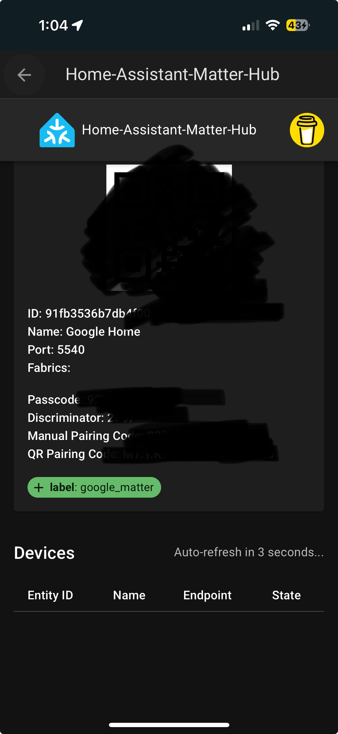

My issue is a little more basic, I go to Matter Hub and select My Hub and I see no devices.
I was using Emulated Hue but Alexa has been doing strange things, I have a specific list and she gets a lot of other stuff not in the list and misses a lot in the list. Trying to troubleshoot that I found Home-Assistant-Matter-Hub and it sounded like the right thing to try next.

I also tried adding a Label ‘Matter’ to the devices I wanted included then:
Include:
  • Type: label
  • Value: Matter
  • Exclude: {}

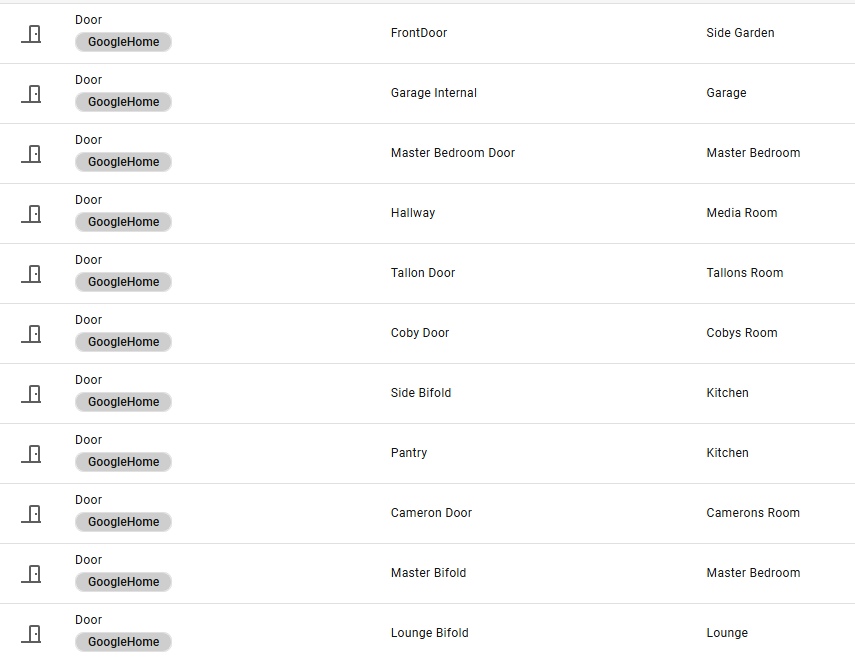

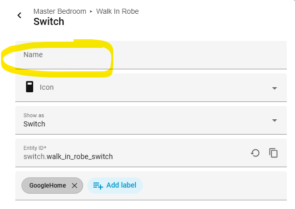

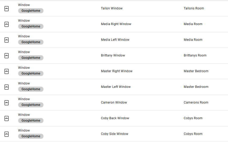

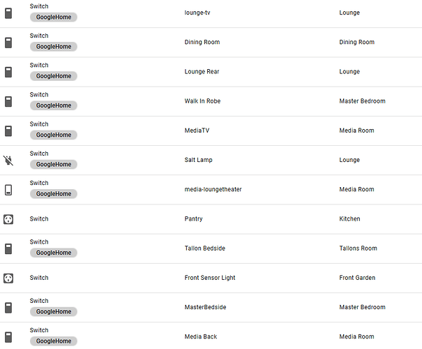

I posted on the github for this - am I the only one that just gets a load of entities into goohle home called ‘Door’, Window’, ‘Switch’ etc - as in not where they are. I dont have my devices names so for example I have -
And I hence just get a load of switches etc - and no idea which is which in google home.
Am I supposed to go into every one and name them as below (I tested one and it comes in correct) -
